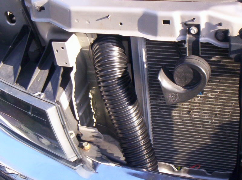

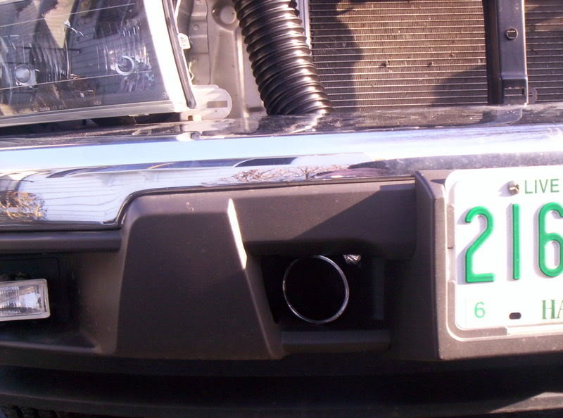

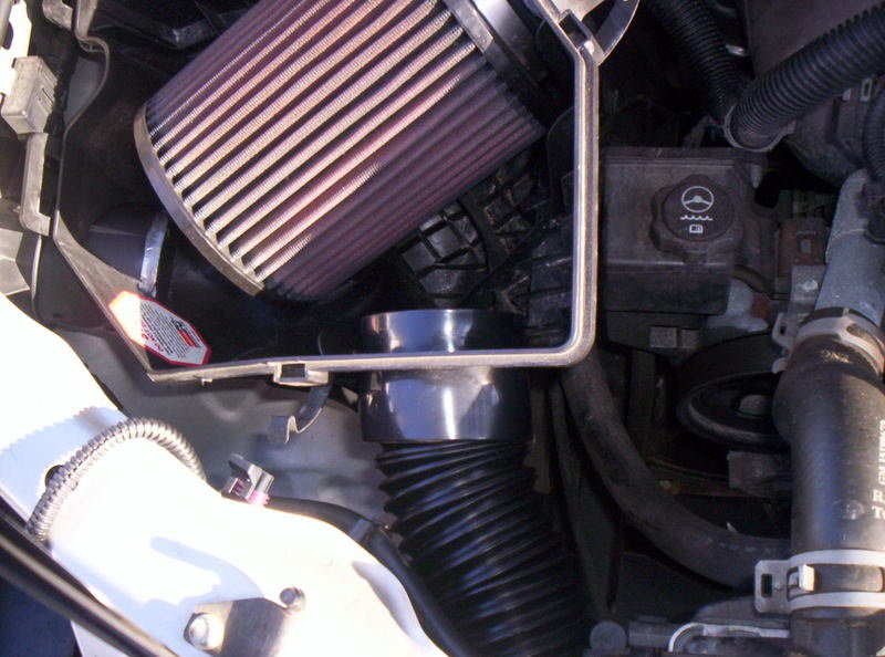

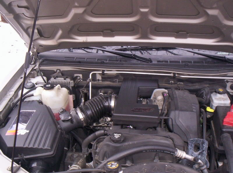

    ok i know these are pictures from my colorado BUT you guys should give this mod a try. it made a nice difference in my truck and provides the same cold air as the intake you are talking about.
    Run a tube (3" diameter seems to be the best) from your CLOSED off stock intake box down to the bumper or behind the grill or some other lower location without putting too many bends in the line.
    --if you are worried the tube is too far down run it just to behind your grille.
    as for your piping from the air box to your TB a nice straight pipe is also good to have:
    final product looks stock and clean but will give you better performance than a $300 k&n or aem or w/e company sells stuff for the tacos:
    **As far as the urd cai goes -i would say that rain might not be a big issue but in heavy rain it prob would be. if you do any type of offroading i would say be careful cuz if your gonna get mud/water on that thing for sure.

    Before my brother wrecked my beloved Beamer i was about to buy a CAI froma friend. My model car had 4 headlights, 2 high and 2 low. The intake i was going to buy actually takes the place of one of the high beams so it's completely exposed. i was only doing this because it was going to be a weekend driver and i wasnt going to rely on it for everyday (bad weather) use. If it were my every day driver, i would never have an exposed intake like that. if you're driving your truck everyday, i woudl look at one of the CAI that actually fits inside the engine compartment. i'm sure you get better performance pulling in cold air from in front of the grille, but its not worth the water and debris that can get in your engine. just my two cents

    I'm not trying to bash your set up at all, but that intake just looks like trouble to me. I'm sure it pulls in plenty of cool air due to its location, it just seems like when you it a big puddle your going to completely drown your engine. With it being so close to the ground it seems like its just waiting to suck up water like a wet-vac. Is this not a concern for you?

    the intake i have was actually a members mod project over on coloradofans.com there are prob 100s of members who have this mod or their own variation of it. i have ran my truck in serious downpouring rain and then pulled off the highway and the box has had nothing more than a small trail of water going from the stock inlet to the run-off hole in the bottom of the box. even in the winter while driving in 1-2 ft. of snow the only issue i have found is that the snow will clog my new inlet and then the motor will simply grab from the stock inlet.
    a few members that are big on offroading have ran their tubes to behind the grille instead so that it is higher up. i havent heard a single member say they have had an issue. i think there are a couple guys who do put a plug on the new inlet from inside the box if they plan on going serious mudding but other than that the majority of people seem to be more than happy with the results.
    Volant intakes actually do a cai tube that is almost identical to this setup accept they run their to BELOW the bumper....even lower! but imo they look funny.

    Ok, i stand corrected. Although being as stubborn as i am, and considering the price of these trucks, i just dont think i could have an exposed intake on my truck. Now that i think about it, the length of the hose and the fact that it's vertical probably helps keep water from being sucked up in large amounts. I'm sure it's a perfectly good set up, just not for me :)
