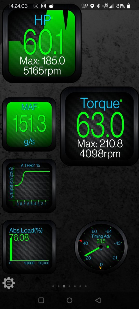

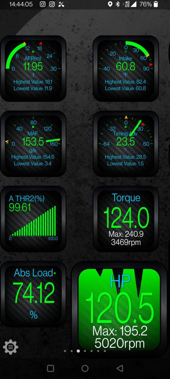

    - Took a few screenshots from Torque pro after a few highway pulls this morning, and also prior to install.
    - Based on prior logging it looks like MAF reading are up +10-15 pts ov average, with HP up about the same (+10 - 15hp).
    - Torque is showing to be a more significant gain at up to +30, which would be pretty impressive for such a low cost upgrade. I would estimate it closer to +20 to be fair.
    Before URD Cam Gear Install:
    HP=185 TQ=210.8 MAF=151
    After URD Cam Gear Install:
    HP=195.2 TQ=240.9 MAF=155
