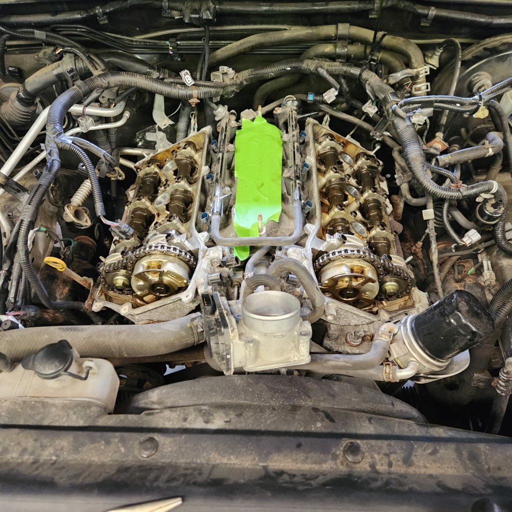

    Just an update;
    On my 2015 Ext Cab, 4x4, 4.0l, 6spd-

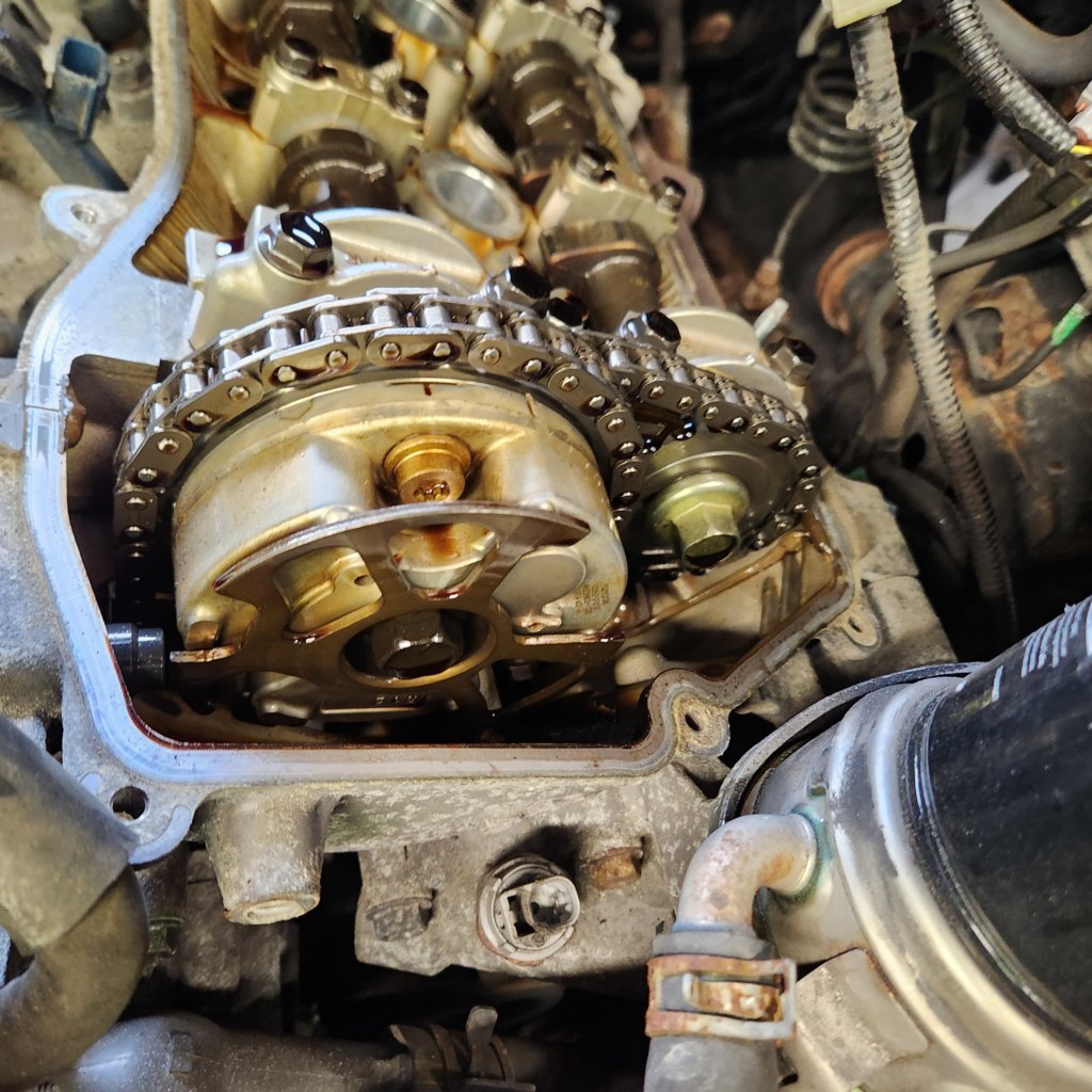

    I had a tune completed by Masteryota up here in the NorthEast (PA) about 1.5-2 years ago. (He is a satellite tuner for Overland Tuning). I had been searching through the forums and came across the cam gear upgrade. After reading through the posts and lessons learned, I pulled the trigger in the spring and bought a set of the cam gears from URD.
    I did make sure to have the wrench extender to break the cam gear nut loose and also had to buy the trq wrench adapter but all in all it wasnt that bad. (Watch the video a few times)
    Anyhow, its been a few thousand miles and thought I would drop a users update.
    I freaking love driving this truck. I got rid of the rev hang in the tune and its just snappy and pulls all of second and even a little in 3rd. My only complaint is having stock tires that like to slip with that low end trq.
    Id say if you have a manual 2nd gen and are looking for just a little extra, these two upgrades made a difference.
    Dont hesitate to ask any questions.

    Cam gears on my 2nd gen for 50k miles now, zero issues. Paired with a 1/2in lower intake manifold spacer (makes runners longer) and tune (my own custom tune with some help from JustDSM via hptuners). Its a quickish truck for what it is. But the IMS and Cam gears definitely helped the already pretty good mid range torque of the 4.0L.... I got in a buddies stock 3rd gen with the 3.5 and was like.... oh god eww its gutless.
    The little things together add up but dont expect amazing drastic changes.
    @OP, looks like you have done a good job of regular oil changes with good quality oil, inside of that mill looks great!

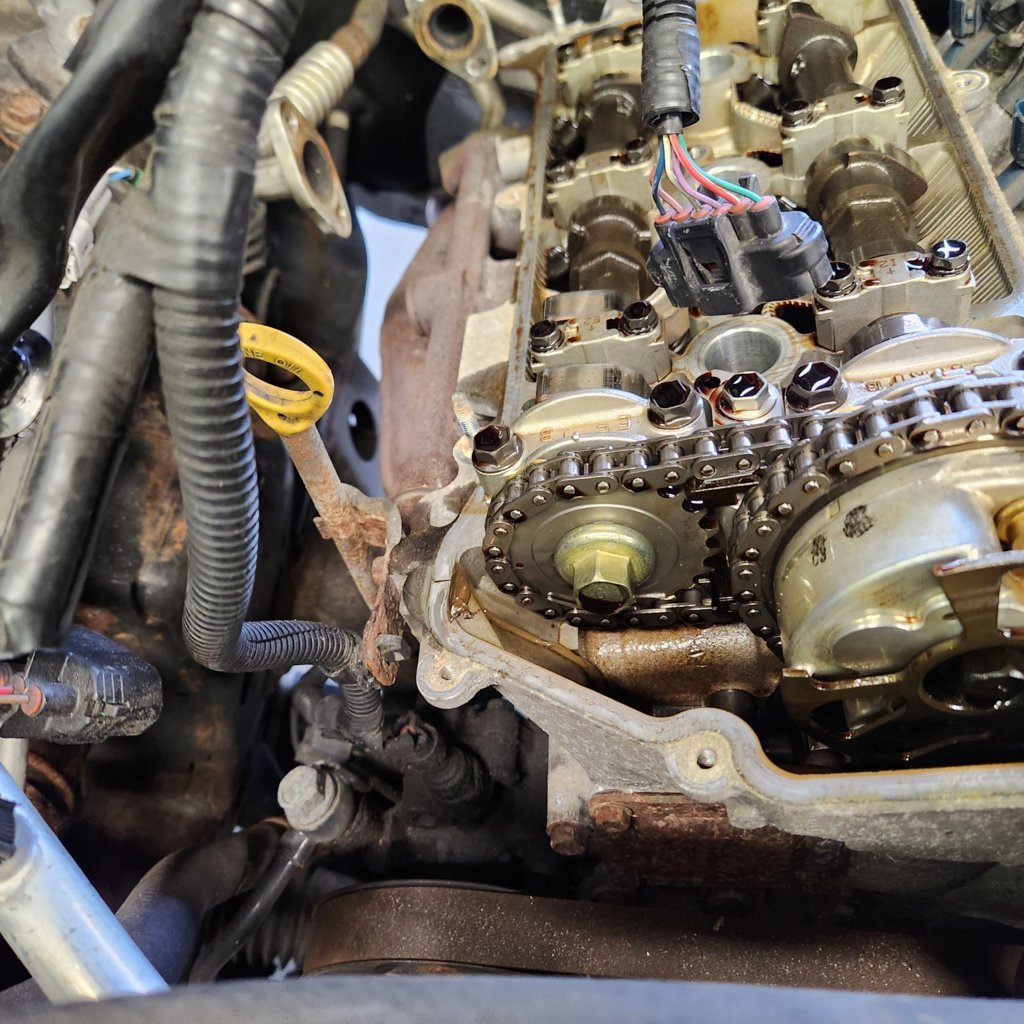

    Honestly, I think this job is pretty straight forward if you have basic mechanical skills beyond taking off an air intake or changing the oil. You are going to pull off quite a few electrical connectors/hoses and of course removing your valve covers. And also messing with an extremely important area of the engine (timing).
    I personally bought the valve cover gaskets, wrench extender and trq wrench adapter. I also watched the popular video on doing this a few times to make sure I understood the process of removing the timing chain and installing the new gear correctly.
    Hardest part? Hmm, for me, was remembering where all the connectors went and the stress of not letting go of the timing chain when putting in the new gear, which honestly isnt that bad.
    I would dedicate the afternoon to doing it. If i remember correctly, I was probably in it for 4-5 hrs and I did it solo.

    2015 DCLB 4X4
