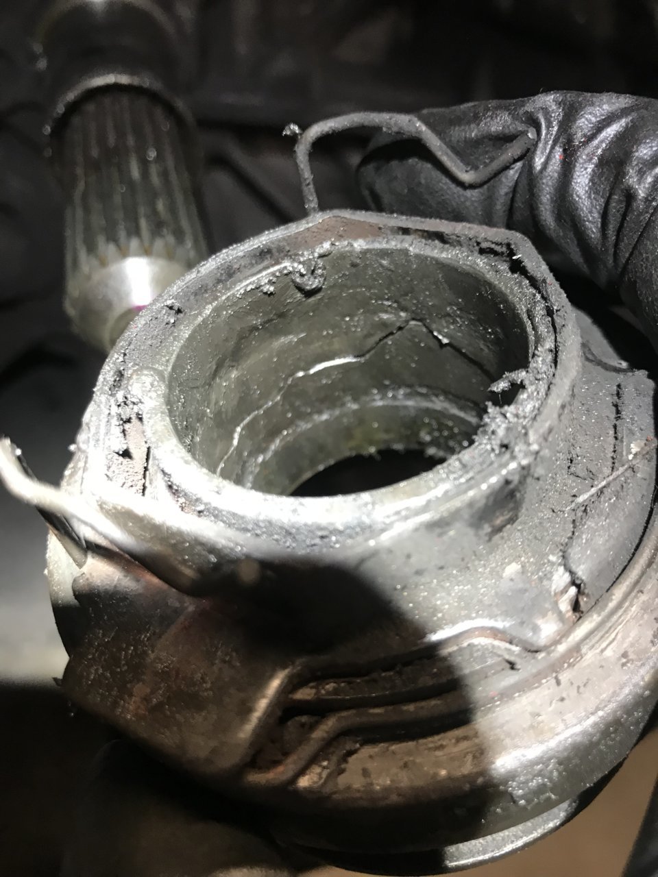

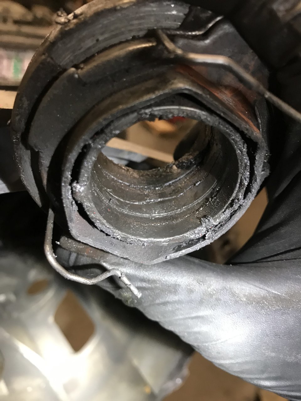

    8 months ago I was having the clutch chirp on my 08 fj cruiser. The vehicle had around 100+K miles on it, I ordered urd’s repair kit with the over bored throw-out bearing and stainless sleeve, Also ordered the heavy flywheel a stage 2 clutch plate and stage 2 clutch pressure plate. Last week the chirp was back accompanied with a grinding noise. I took it back to the shop that installed it. They removed it and sent me pics of the sleeve and bearing, The throw-out bearing was disintegrating the sleeve was scarred but according to urd was reuseable. As in previous commenters posts The Shop installing the parts had problems getting the clutch to disengage by normal adjustment (they originally thought they were having problems bleeding the master and slave). The only way they could get the disengagement was to adjust the pedal out.
    I’m am currently waiting on the second bearing so I can get my vehicle back on the road.
    I have concerns about the strength of the bearing, Because of the over bore and now the wall thickness is too thin. I have Never had a problem like this with a throw-out bearing. Is a stage 2 clutch setup to heavy for this over bored bearing?
    I can’t afford to keep pulling transmissions out for a throw-out bearing, Also replacing a $125.00 Bearing. The warranty on the bearing is 6mos. The sleeve is Lifetime.

    If I could figure out how to upload the pics of the bearing and sleeve I would post them. I’m thinking if there is room on the sleeve at the back end to put set screws there and turn down the sleeve to minimum wall thickness and take a unmolested bearing and bore it to the new tolerance(more meat) in the wall would be my next try. Before cutting off the quill.

    Heres the problem, To me the wall thickness of the bearing is rather thin IMO. 8A1E21EF-B7CF-48C7-B4CA-411F0C18B2AE.jpg5A06B12B-F645-4A5D-AF68-14A15737746C.jpgB40FD7FE-6A87-457A-9A30-1F802073693F.jpg

    So the urd is to thin and is shit or the stock?
    A little confused

    I’m Not saying the URD supplied part is “shit”.
    I’m questioning whether the bearing wall is sufficient for the stage 2 pressure plate.
    I’m no engineer but something is substandard. If it happens again within a year then you and I Both know something is wrong.
    Wish I’d used a oem clutch plate and pressure plate.
