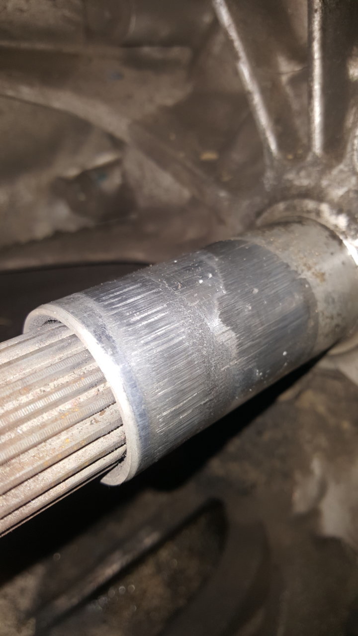

    Dropped the transmission today. Here's what the snout looks like. Pretty significantly scored. The bearing itself didn't seem terrible, but the tolerance to the snout was sloppy. Lots of wobble.
    Clutch was close to done so needed seeing to anyhow. Fork and fork pivot look fine.
    Hope to get it buttoned back up tomorrow. Glad I had long ratchet extensions to get to those top bolts.

    Finished the installation today. The URD throwout bearing kit is pretty slick. A little fine grit emory cloth to clean the snout up and the new sleeve slid on with a little bit of persuasion (no tools necessary). I also swapped out the fork pivot ball for a new one (only $30) which is a different part # than the original because of the TSB apparently. Only difference I could see to the original was the middle of the ball was beveled flat to make it narrower. They are exactly the same length. The original was showing minor wear, so I figured it was worth swapping out. Fork looked almost pristine. It went back in. A new one was north of $200!
    New clutch and flywheel are LUK.
    Way lighter pedal feel now, much higher engagement point (I will play with pedal adjustment later). The squeak is gone.
    I am pleased.

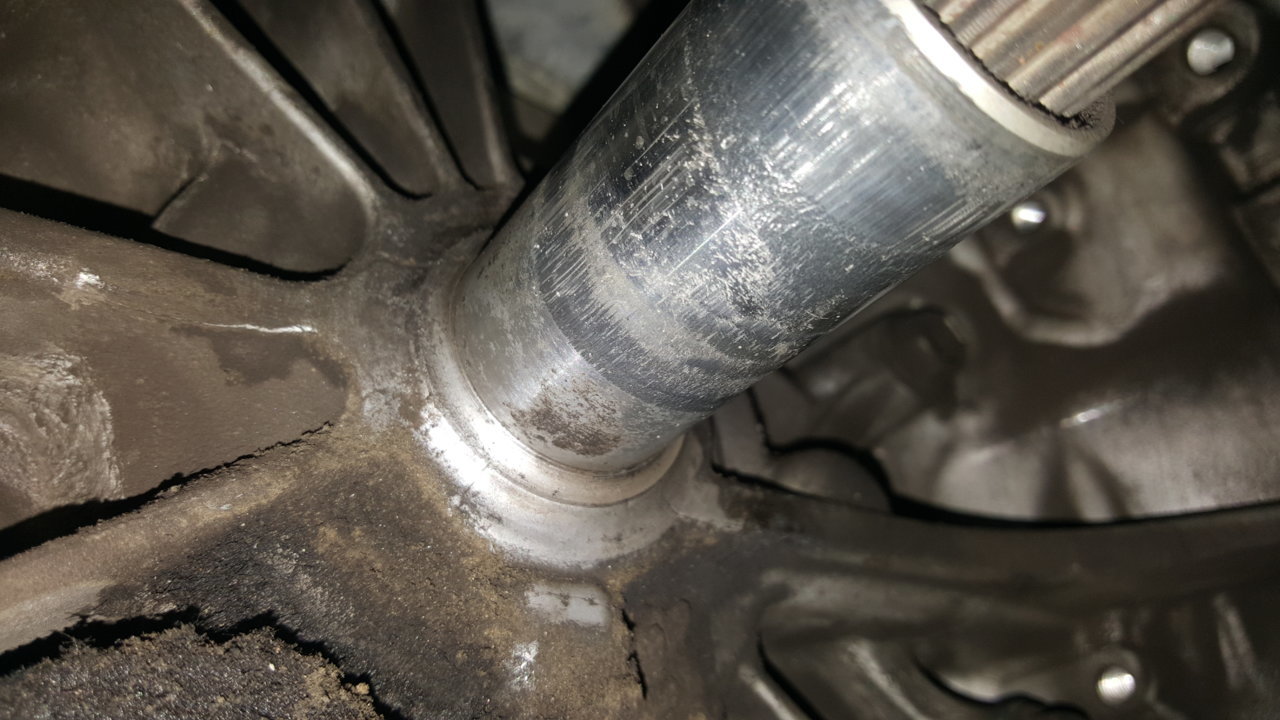

    This much

    URD instructions say to cut off the quill so it sits flush with the provided spacer, this is basically what’s left of the quill after achieving this. Let me know what clutchmasters say, I’d like to give hydro bearing this a shot in the near future.

    Ahh perfect, I didn't realize the URD kit used a spacer as well. I sent your picture over to the head engineer and machinist at CM and he said it looks like the Clutch Master kit should work with what little bit of quill is left on your bellhousing. He said to mention to you that if you'd like to give it a try that's definitely something they could work out. That we they would know in the future that those who have done the URD Fix-U hydro and cut their quill down, the Clutch Master kit will work.
    Ha sounds good! Also URD's kit isn't available anymore so really the only option is the Clutch Masters kit. I think the CM kit is a better setup and would chose it over the URD kit if they were both available.
