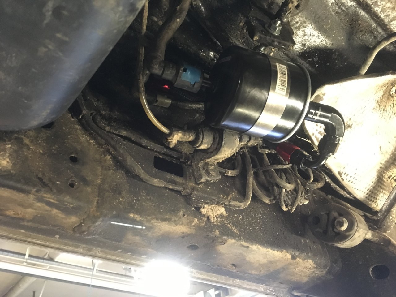

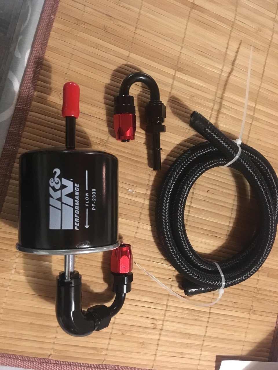

    Finally got the last piece:
    Sorry, this should be at the end instead of the male adapter:
    Now it’s been installed for few weeks. There happened to be a good mounting point (clutch hose bracket) for 3” stainless steel clamp.

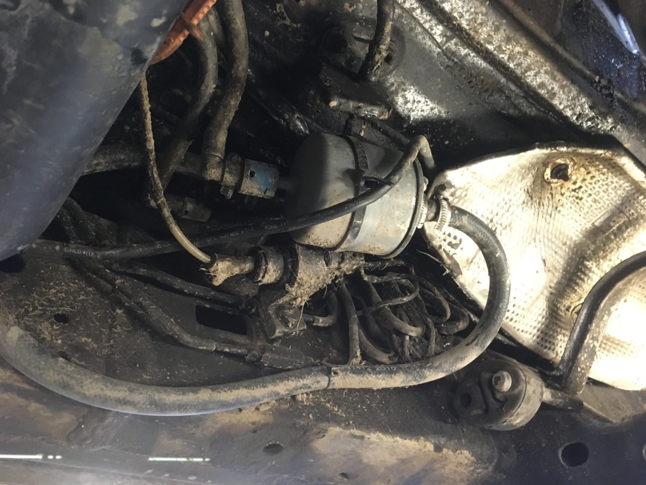

    Previously:
    Now:

    Old post, but I'm in the process of installing this URD mod and was looking for pictures of how other members had done it. Especially the dressing of the external fuel filter. Loginfailed, I couldn't help but notice that in your image the fuel filter seems to be the wrong way around. Did you run into any issues having this orientation or did you catch and fix it?

    If his filter flows in the same direction as the K&N, which I am pretty sure that it does, then it is in the correct orientation. Using the driveshaft as a point of reference for the transmission.

    It is correctly plumbed in the picture and it worked as intended. However I do not use that particular setup anymore.

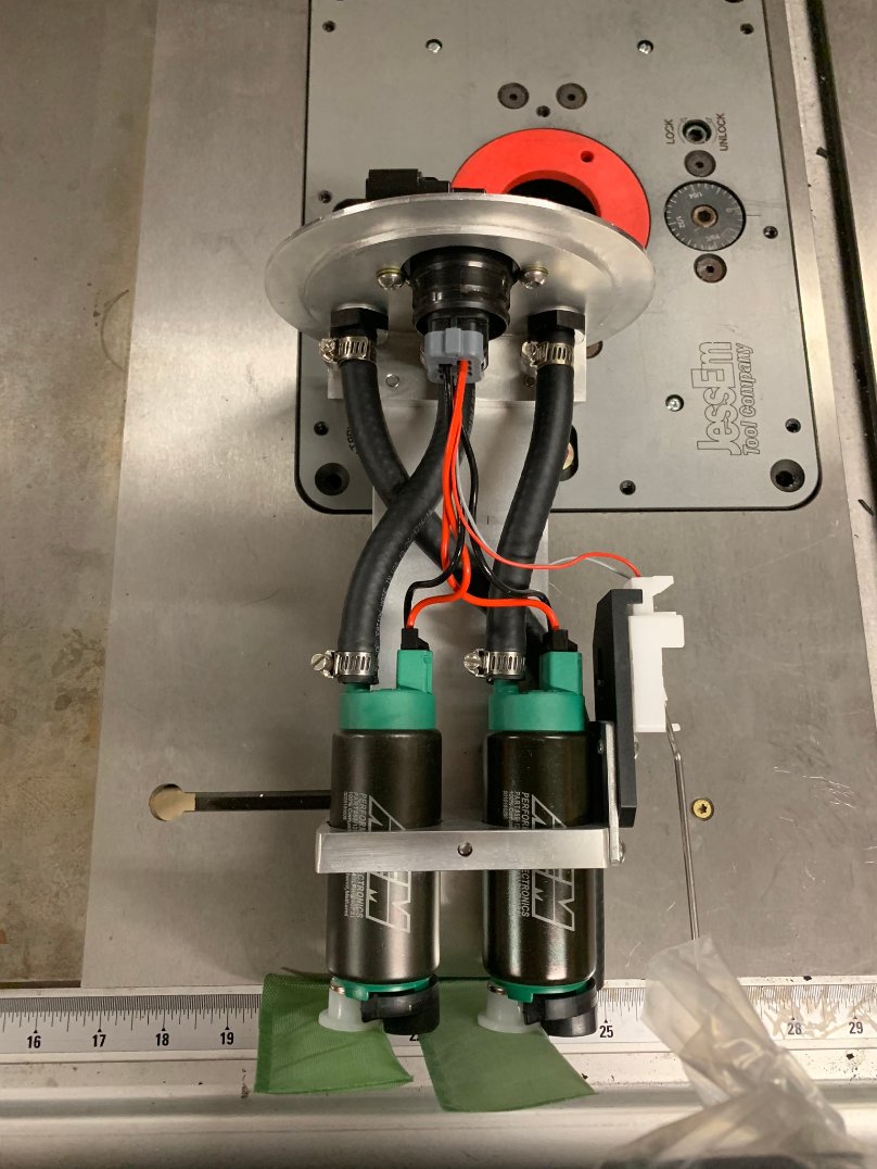

    This is the pump setup I've put together

    This is the filter

    That is correct.
    You must use Teflon tape, if you purchase the NPT adapter. You must. The yellow container. Fuel rated.
    The ORB adapter is a good option as it uses O-rings. A bit more expensive
