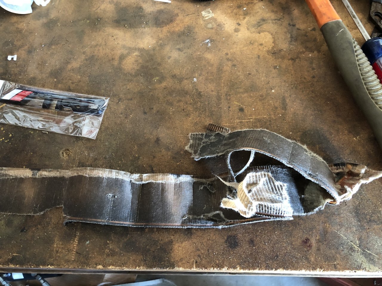

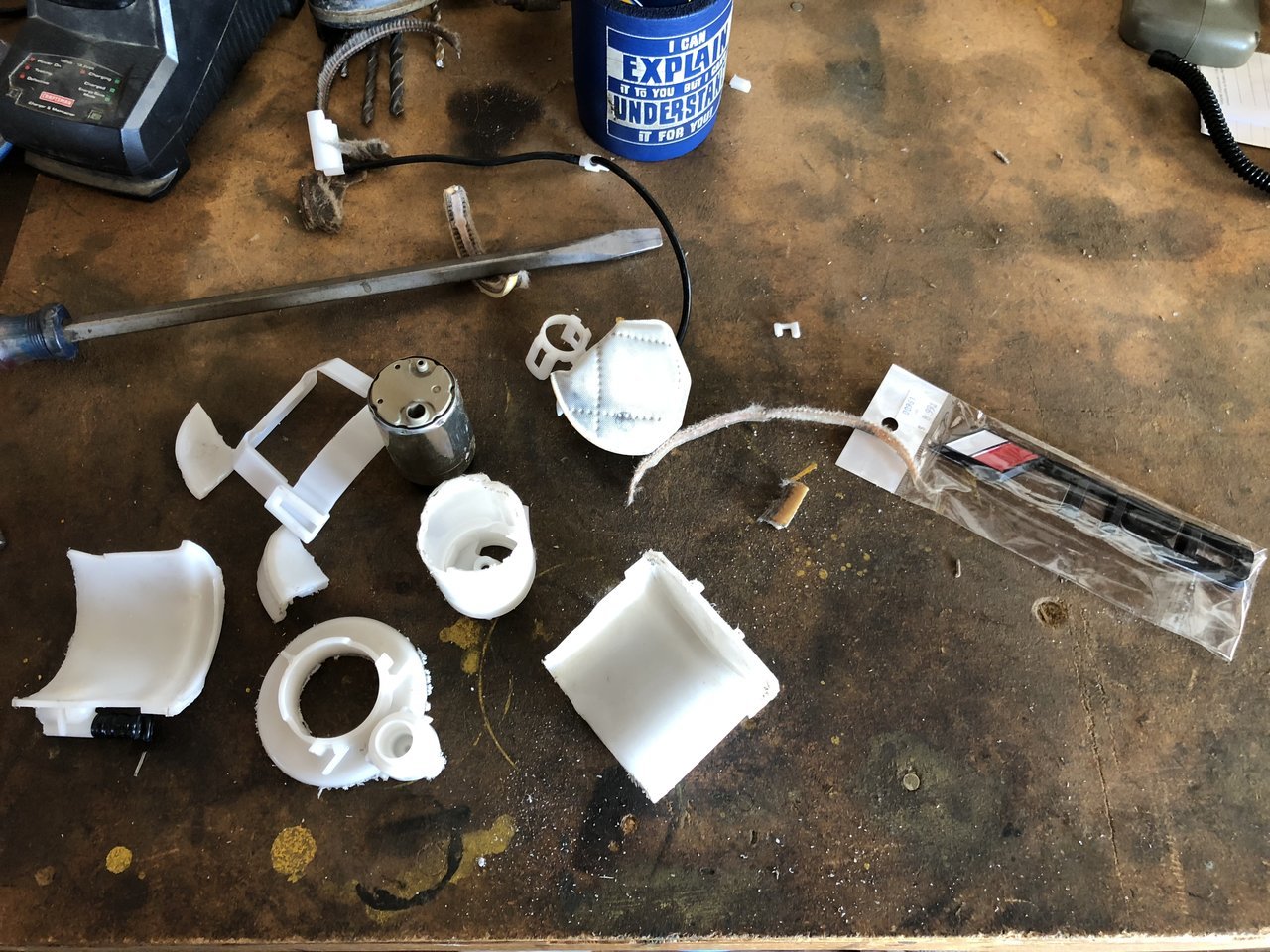

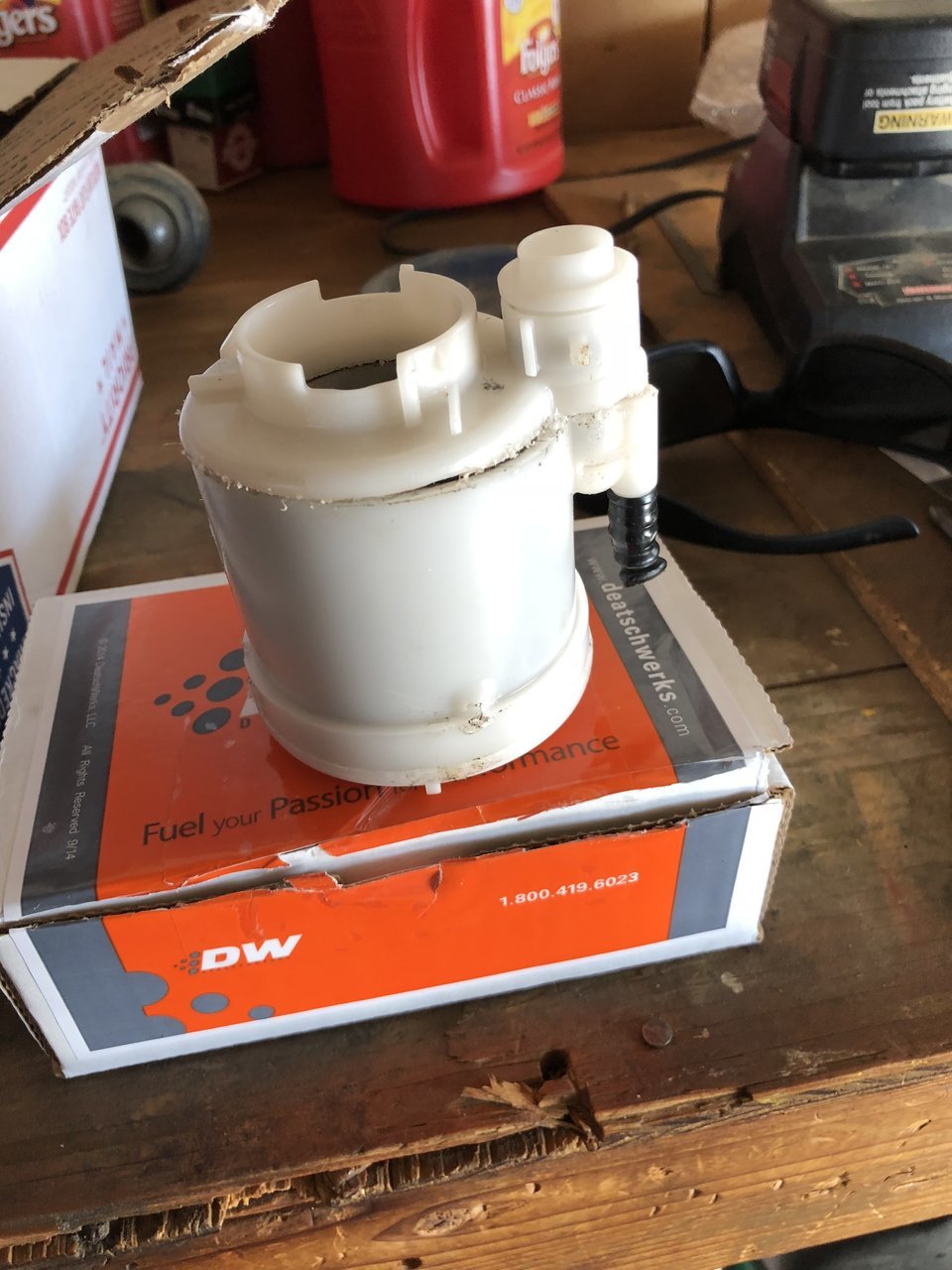

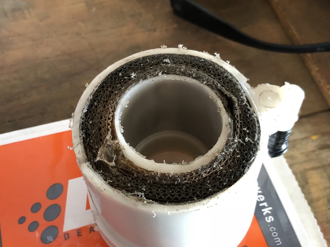

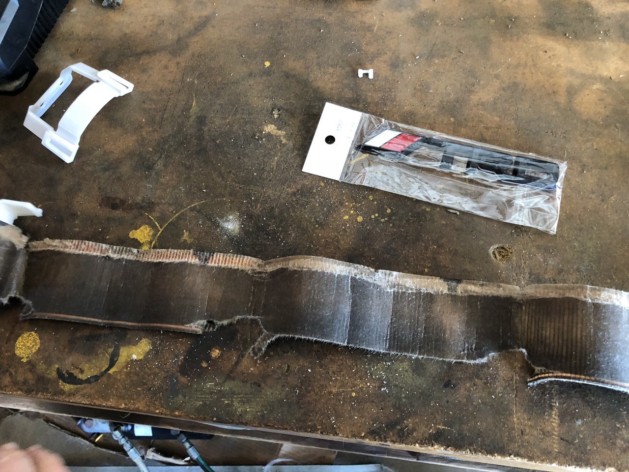

    This is not true. There is a filter wrapped around the stock pump. It may be a joke but it’s something. See here:

    Correct^^^ Thank you @Murphinator
    Adding an external filter, while the internal OEM filter is installed, does nothing beneficial. As the internal one is still in an upward climb of contamination trapping. It will still have to be changed eventually.
    No point to add an external filter, until the internal one is removed.

    Interesting, learned something new. I don't think I've ever seen photos of that filter element before. It's always the sock I've seen when people post about the stock filter.

    Probably because cutting that plastic around it was a PITA!

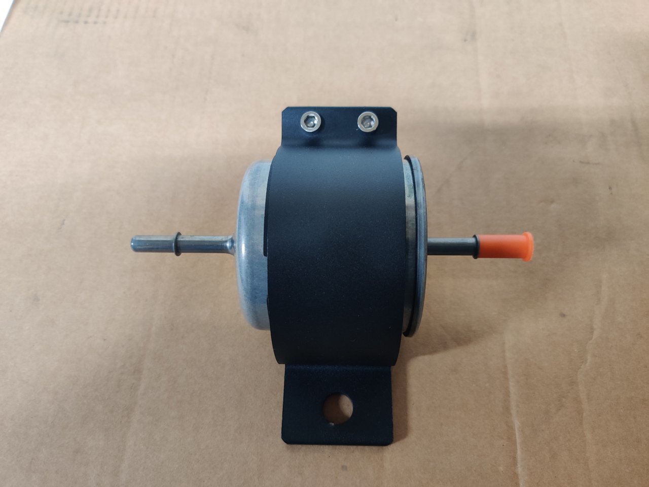

    In case anyone needs a mount for their Wix/Napa filter. Found this on Amazon: https://www.amazon.com/gp/product/B07426TY4S/ref=ppx_yo_dt_b_asin_title_o00_s00?ie=UTF8&psc=1
    Comes as a pair. I have the other mount not being used it's yours, just pay for USPS flat rate shipping, small box.

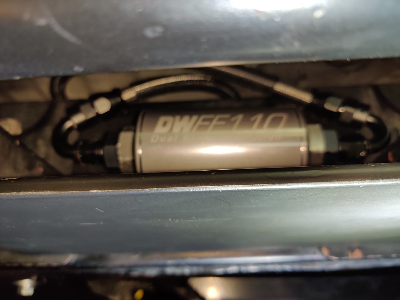

    I'll be replacing my fuel pump/filter soon and will use a URD assembly. I like everyone's work here for routing lines and clamping.

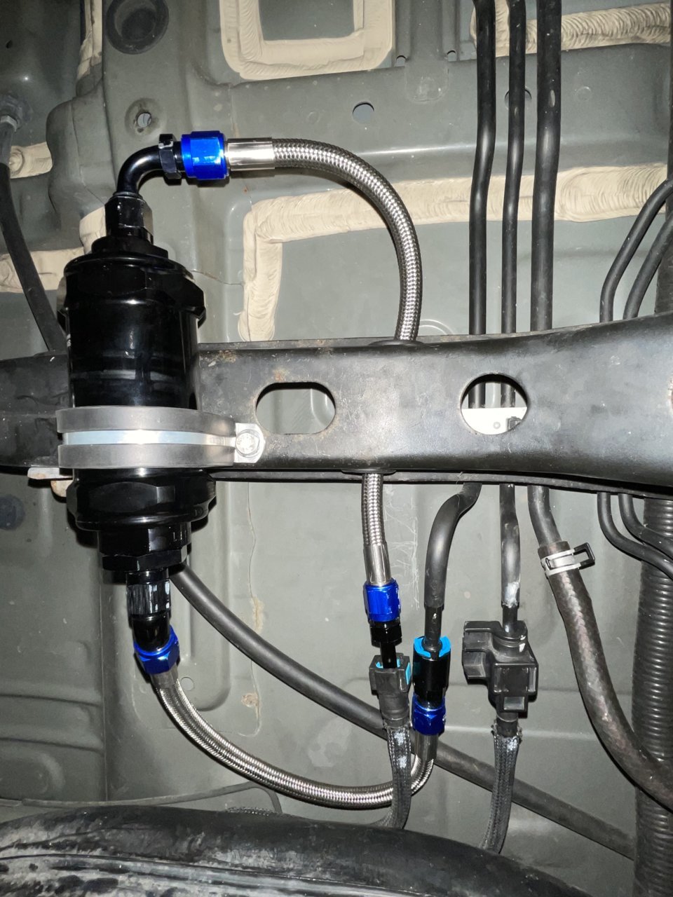

    My solution.

    Very nice. Clean, and easier to service than the kit made it. :thumbsup:

    Happen to keep part numbers?
