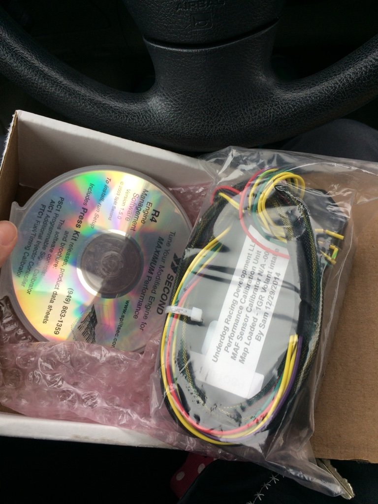

    So my urd MAF cal is waiting at my house for me to get home and install it how many on here have done this and is it hard .. I've got lots of experience with being a mechanic so can't wait to get home and install it to see if it actually makes a different 9cb0fd3742999640af3307a90a32794f_a7aa02c9e8a9f4d2add8a2d410d989318cfe8b48.jpg

    Well she is installed and must say it has better throttle response and fills a good bit stronger 2wd is useless if you stomp it.. Would have liked to dyno it before and after but it feels stronger anyways .. Not to hard to install but you are working in a tight space but all in all it's easy if you follow instructions
