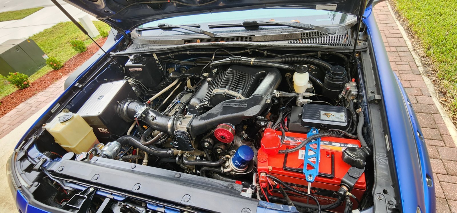

    Here's my setup with the 2.85" pulley. Pulled a 3800lb camper pretty nicely. Converted to a dual Spal fan setup with PWM controller and now it REALLY pulls nicely. Faster than an Ecoboost F150 (fella at the light tried me and found out) Only downside to the Magnusson kit is the belt tensioner is kinda weak. Broke one already but there are upgrade options in the TRD Supercharger tips and tricks thread. I opted to reinforce a replacement Gates tensioner I got from Oreilly's.

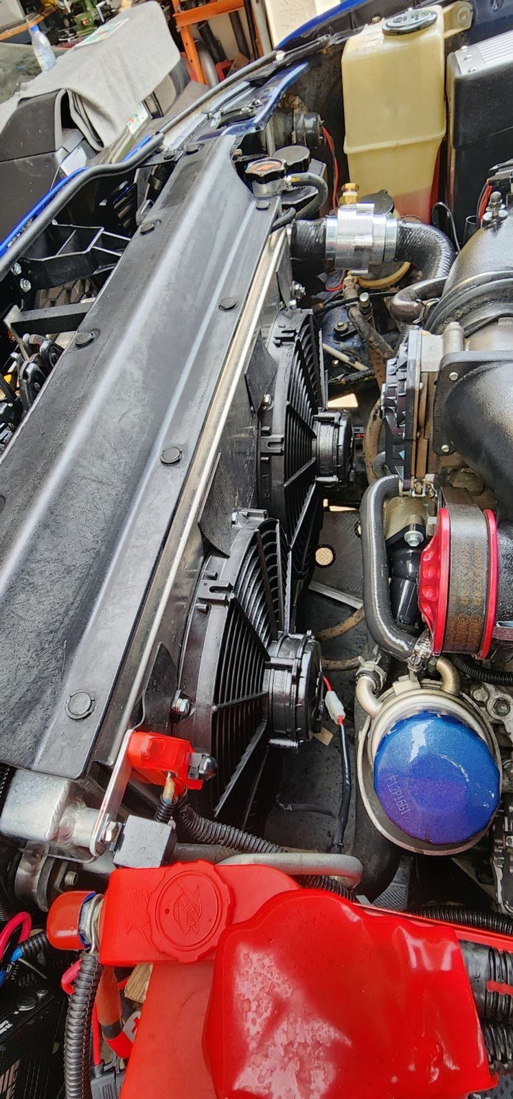

    Ma_Taco; where is your write up on the dual electric fan set up. I been pondering this set up forever now. This may be an old thread, but that fan set up tho...
    Argann and ucdbiendog like this.
  18. Nov 17, 2023 at 8:51 AM
    #18
    MA_TACO
    MA_TACO Well-Known Member
    Jan 28, 2018
    #242689
    668
    Wesley Chapel, FL
    I didnt do a write up but it's not hard but it's pricey. I used a Derale 16797 PWM controller to control the fans. The shroud I got from Speedway Motors on Amazon but had to add about 4" of aluminum material to the bottom to cover the entire radiator https://www.amazon.com/gp/product/B088HKL8LH?ie=UTF8 The Spal fans are 13" https://www.amazon.com/SPAL-30102044-Puller-Performance-Curved/dp/B08BKXCDGZ . The pricey part was the 250a alternator from JS Alternators and the Big 7 cable kit from toyotacables.com and the biggest Odyssey battery I could fit. The factory 130a alternator worked but battery voltage was down to 11.9-12.3v when the fans were on at 100% so I upgraded the whole system while I was at it.

    this is awesome, thanks! what do you do with the old fan pully? just torque the nuts on the studs w/out the fan/clutch?
  20. Nov 17, 2023 at 8:56 AM
    #20
    MA_TACO
    Jan 28, 2018
    #242689
    668
    Wesley Chapel, FL
    yeah just bolt them back on the pulley
