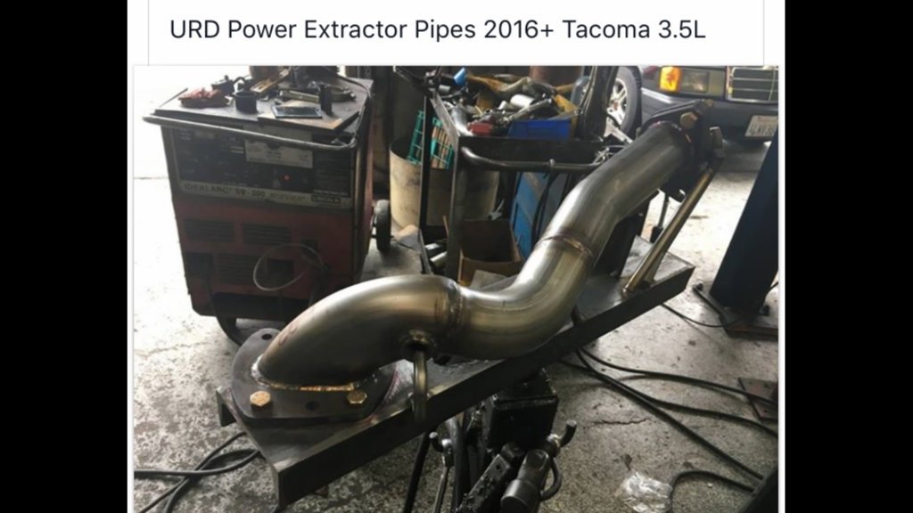

    @Artsvhuerger -- specifically what power enhancers did you install?
    Perhaps I'm dense, but I'm having trouble following exactly what was installed, if there are benefits and/or problems, and whether the hardware is still installed. Thanks in advance for clarifying.
  10. Nov 6, 2017 at 2:43 PM
    #30
    Metallikatz3
    Metallikatz3 Well-Known Member
    Sep 10, 2008
    #9124
    1,743
    SLC, UT
    2017 DCLB OR
    Always in process
    https://www.urdusa.com/urd-power-extractor-pipes-2016-tacoma-3-5l-v6/
    You removed your catalytic converters and didn't address the O2 sensors via simulators or de-foulers, any company saying that a product is for "offroad use only" means that it bypasses the truck's emissions system and will cause a Check Engine Light
    BeaverNation likes this.
  11. Nov 6, 2017 at 2:44 PM
    #31
    BeaverNation
    BeaverNation Well-Known Member
    Mar 11, 2013
    #99527
    757
    He’s talking about the urd power exctractors. It’s really frustrating that urd made them without a solution for the check engine light. We all hope that @OVTune will be able to take a look at it in 2018.

    10" manual gear shift w Jack Daniels Q ball shift knob. Short shift kit ARE COLD AIR KIT Z Pro.raceiing power chip
    Well I checked before I bought URD asked if check lights would come no mention.
    When check engine comes on cruse traction control and a few other stop as well .
    I took them off until there's a fix .
    URD should not market w/o a check fix

    Front hellwig sway bar,All pro sway bar end links, Fox 2.5 Resi Coilovers and Shocks, Fox 2.5 Hydraulic Bumpstops, Budbuilt Traction bar, Total Chaos UCAs w/ heim joints, Icon AAL, AFE Power Intake with dynamic scoop, URD spec U, URD short shifter, Flossy weighted shift knob, michelin tires, black badges, black tailgate letters, black grill with custom Diaz Fab Devil horn yota logo, retrofit/morimoto HID conversion, red interior LED lights, Pioneer head unit, kenwood excelon door speakers, 2 10" pioneer subs,
    Thats just not true. Yes, it says "offroad use only" because it modifies the emmissions control devices of the vehicle which is technically, by the letter of the law, illegal today. However, that does NOT mean you will automatically get a CEL as I have been driving around for over a year with my rear cats removed and have not had a CEL since I swapped out my last exhaust setup for the URD spec-U
  17. Nov 8, 2017 at 6:23 PM
    #37
    BREAK
    BREAK Well-Known Member
    Feb 11, 2010
    #31152
    87
    Washington
    2016 TRDOR LB
    BFG KO2 265/75R16 Icon Dynamics 2.0 Front Coilovers and rear shocks. Rear AAL Borla Catback exhaust Afe momentum CAI
    Removing rear cats won't set off the CEL. But removing the front ones will trip the O2 sensor. That being said URD makes an O2 simulator that would bypass the O2 sensor and keep it from throwing a code. It worked on my 4.0L with the Doug Thorley long tube headers. No word if they work for the extractor pipes or if they are working on something similar.

    This is correct, I had not even looked at the OPs signature because he posted in the Turd Gen section. URD makes what you need to fix the CEL on the 4.0. URD only makes headers for the 4.0 so not sure what is going on here now. @Artsvhuerger did you talk to URD at all about this?
  19. Nov 8, 2017 at 9:34 PM
    #39
    Paterico
    Paterico Well-Known Member
    May 17, 2016
    #187225
    280
    San Antonio, TX
    2017 DCSB TRD OR 4x4
    Just use an unfouler on the secondary o2 sensor(s). Then the secondary 02 sensor won’t read a large enough change to throw the CEL
    This is common for aftermarket exhausts that bypass the cat.
