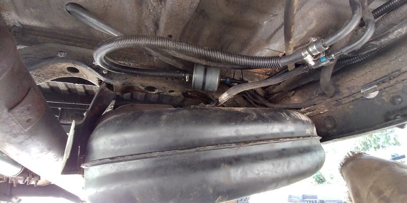

    The left most connection corresponds to the leftmost on the tank with a red dot on it (high pressure). When I disconnected the high pressure from the filter there wasn't any pressure on the line.
