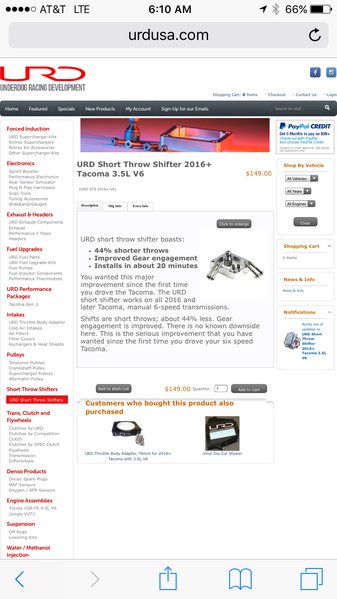

    Anyone tried this product out? I would really enjoy my manual truck more with a decreased shifter throw.

    You wouldn't believe how much misinformation there actually is out there about shifters...
    A lot of people don't realize there are 2 measurements you are looking at when people talk about a "short" shifter.
    -Above the fulcrum point, you're basically just making the knob taller or shorter without affecting the distance between gates.
    -Below the fulcrum point, you're actually lengthening the "rod" to make the distance between gates shorter- this is where a larger difference is made, and this is also where you might run into issues like being tough to shift when cold, etc.
    This URD unit looks like it's doing it the right way and increasing length below the fulcrum. A lot of people basically just hit the top of their shifter rod with a hacksaw and then say "short shifter!" when the difference between gates is totally unchanged.
    ALSO!!! A big thing for shift "feel" that many people ignore is the weight of the knob. A heavy knob makes for "smoother" shifts and a more positive "drops in to gear" type of feeling, a light weight knob makes for "notchy" shifts that some prefer as more "precise" because there is less of a "momentum" feeling to the shifter.
    Personally I dig the longer, lighter shifter.

    If its anything like this one: http://www.gadgetonline.com/shifter.pdf Id be hesitant to have the shift lever be in multiple pieces. I agree with the design, but if there was a factory TRD option (unlikely unless someone can confirm similar lever design to the previous taco or FJ, Id take it instead as it replaces the whole lever.

    I totally hear you on the reasoning, given the last time I installed a short shifter on a different make of vehicle I had issues with an aftermarket "adjustable" 2 piece unit that was REALLY sketchy. However, they tell you to use red loctite AND stake the set screw in... that's definitely not going anywhere.
