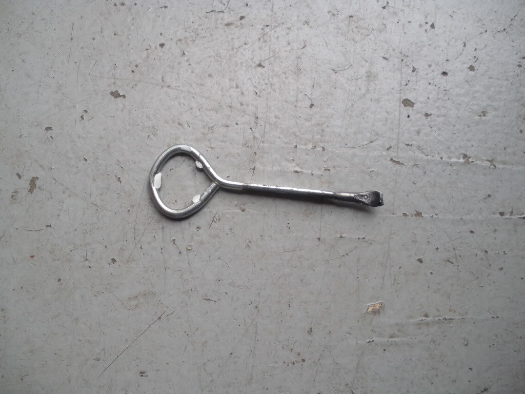

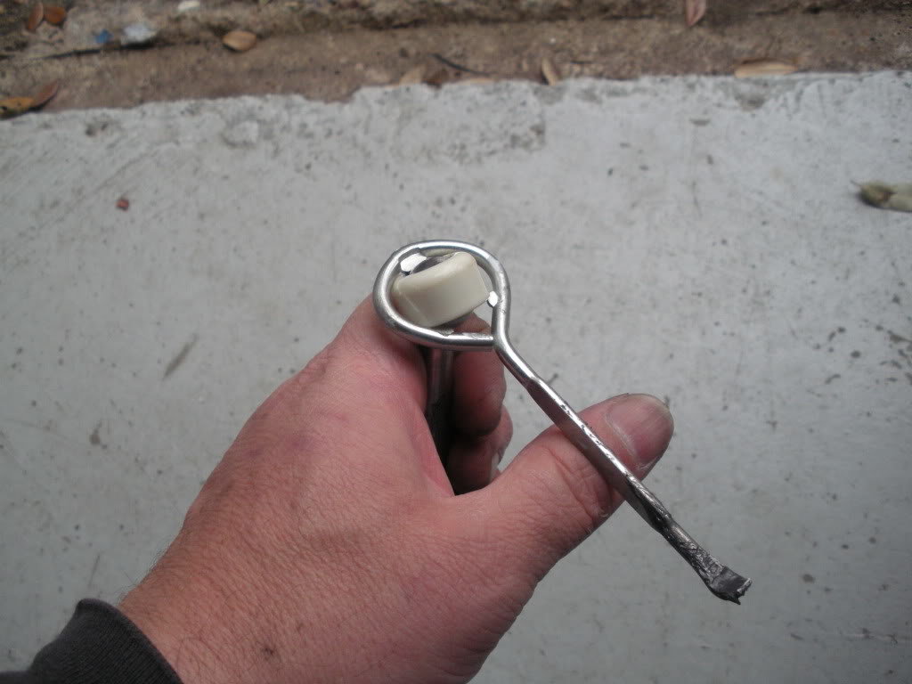

    This is my tip for getting the tip bushing off.
    This is a paint can opener. They give this away free when you buy paint at Loew's or Home Depot.
    In use.
