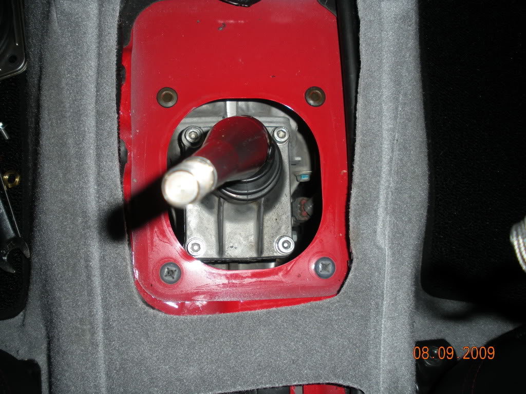

    you most likely wont have to do anything, but if you do. I can tell you what part from another picture i seen. I tried looking for it but no luck.
    ok so when you have everything completely apart, look at the tranny where the shifter sits in. the hole that your looking through the floor board is the part. Basically the thin metal of the body that's cut out sometimes hit's the spacer plate. So when you install the spacer check around the edges and see if the spacer has enough room between it and the body.
    EDIT: I think relentlesstaco may have posted a pic somewhere of the bent edges. Im not 100% if it was him but doesnt hurt to ask.

    Look at this pic. The bolt at the lower left corner is usually the bitchey one. Sometimes the material in tunnel around this area needs to be trimmed.
    Or you can used socket head (allen wrench) bolts and avoid the problem.

    ^^ yea thats what i attempted to draw lol. My gaps were big and i was happy, no bending/cutting anything!
