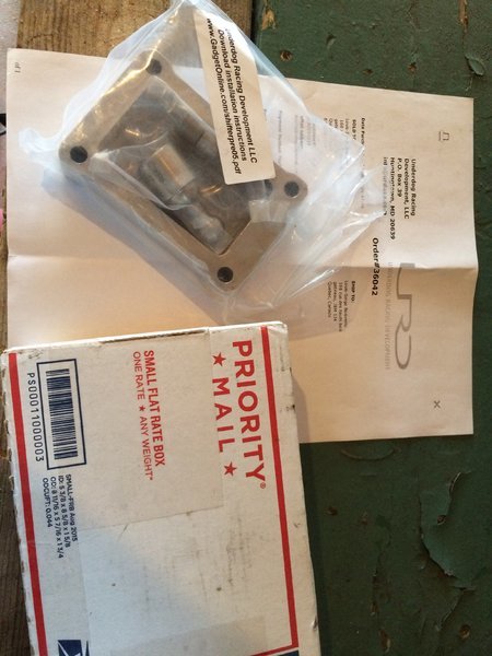

    Because my truck is my daily driver, I wanted to do the things right and didn't want to miss a part in the installation that could cause my truck to break down on my way to work. I follow the installation instructions carrefully but there was a small problem with it. On the package, URD are referring to PRE05 installation guide for the 2.7, as you can see on the bag.
    I wrote to the support to be sure they sent me the right part before starting to take things apart. They then refer me to the installation guide for the 6 speed, on this link : http://gadgetonline.com/shifter.pdf
    The guide was really helpful but there is not a lot of picture to help with the text description. I decided to make a short "complement" write up for those who are on the edge of buying this kind of Short Shift.

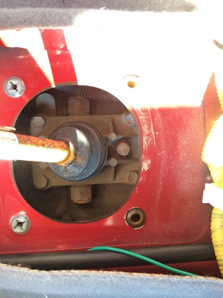

    Step 3:

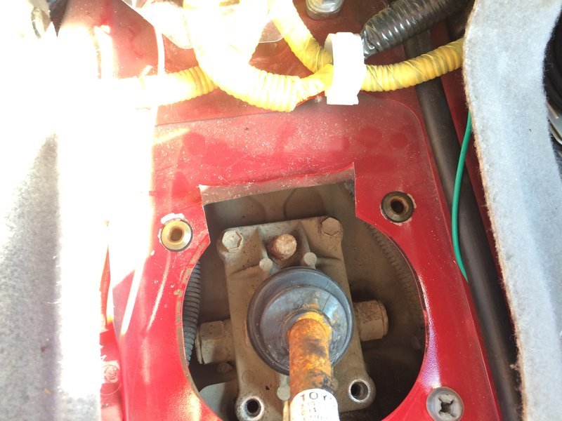

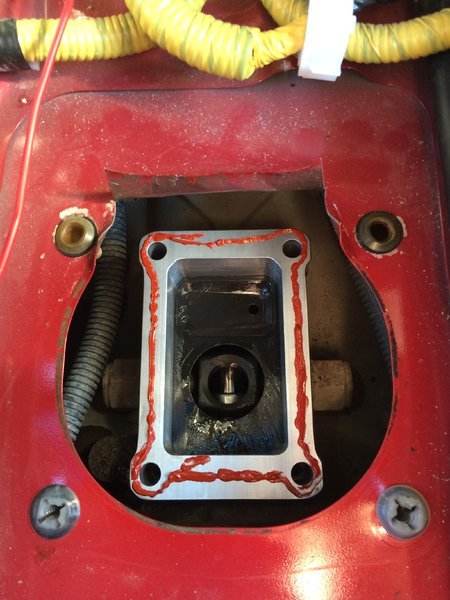

    As we can see, the two front bolt doesn't align very well with the acess hole on the floor. There are two options, use a joint on your ratchet or do this
    I cut the side and lift the piece of metal sheet to have it out of the way. Now we can remove all 4 bolts. The URD guide suggest to use a rubber mallet of an hammer with a piece of wood to hit the side of the tower portion. Once it breaks loose, take it out of the transmission and bring it to a place where it is comfortable to work.

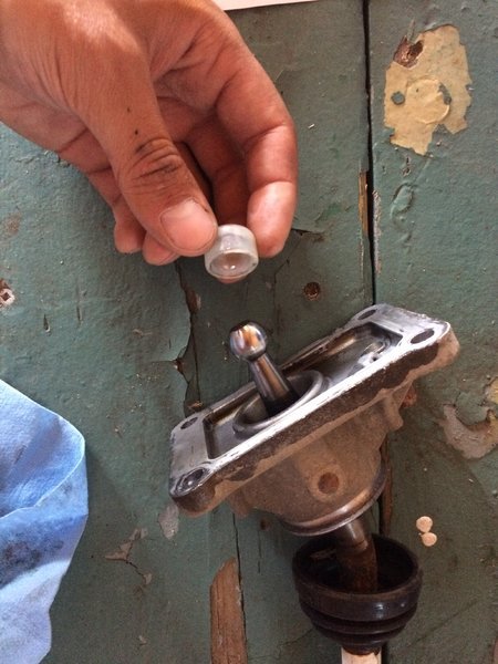

    Step 4: Remove the small plastic piece on the end of the ball. It is pretty hard to take it out but I did it with my hands only. Don't be surprise, it will pop out with speed! don't lose it and don't break it because it is going on the new ball to install.

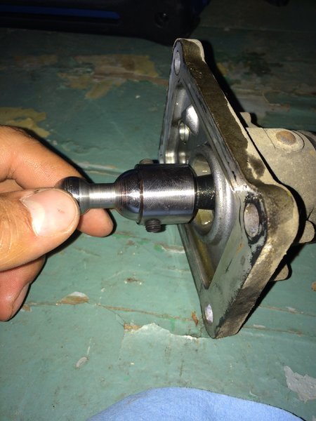

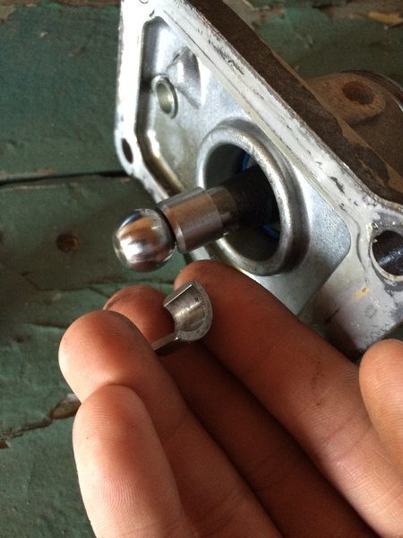

    Step 5: When the platic piece is out, install the two shims on the stock ball
    and then, slip the new ball on the stock one. Push it until it clics in place.

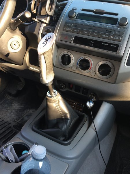

    Step 7: Put some gasket maker on both side of the spacer and install back the shift stick with the new ball on it. Bolt it in place with the 4 new longer bolt that are in the package. Tighten it at 13lbs and it's done!
    Shifter now sits an inch higher, wich in my case make it more comfortable.

    I couldn't be happier of the final result! The best part is going from 1st to 2nd. It is much quicker. It makes city driving much better!
    No it doesn't lol I had it before but for now I put back the stock one because the browning was becoming loose. I have to find a way to make it more tight on the stick. The driving experience with the stock one stays awesome tho!
