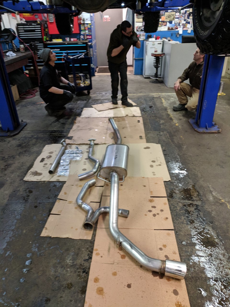

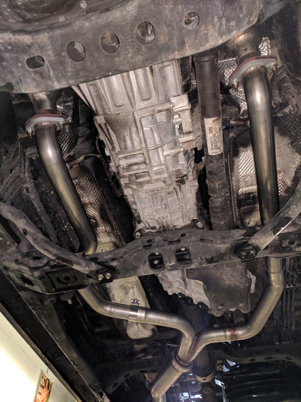

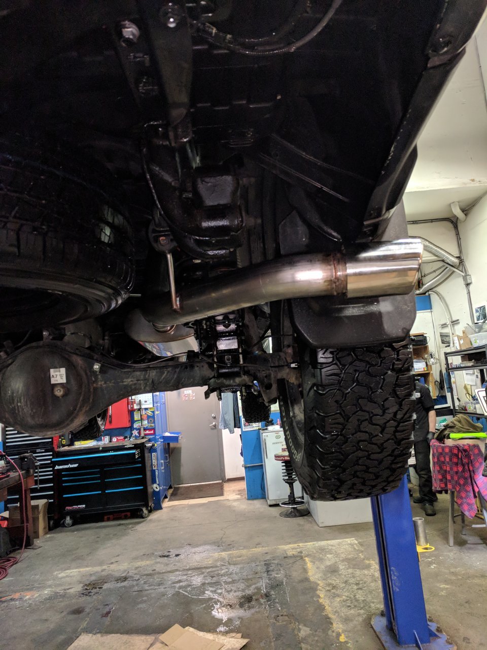

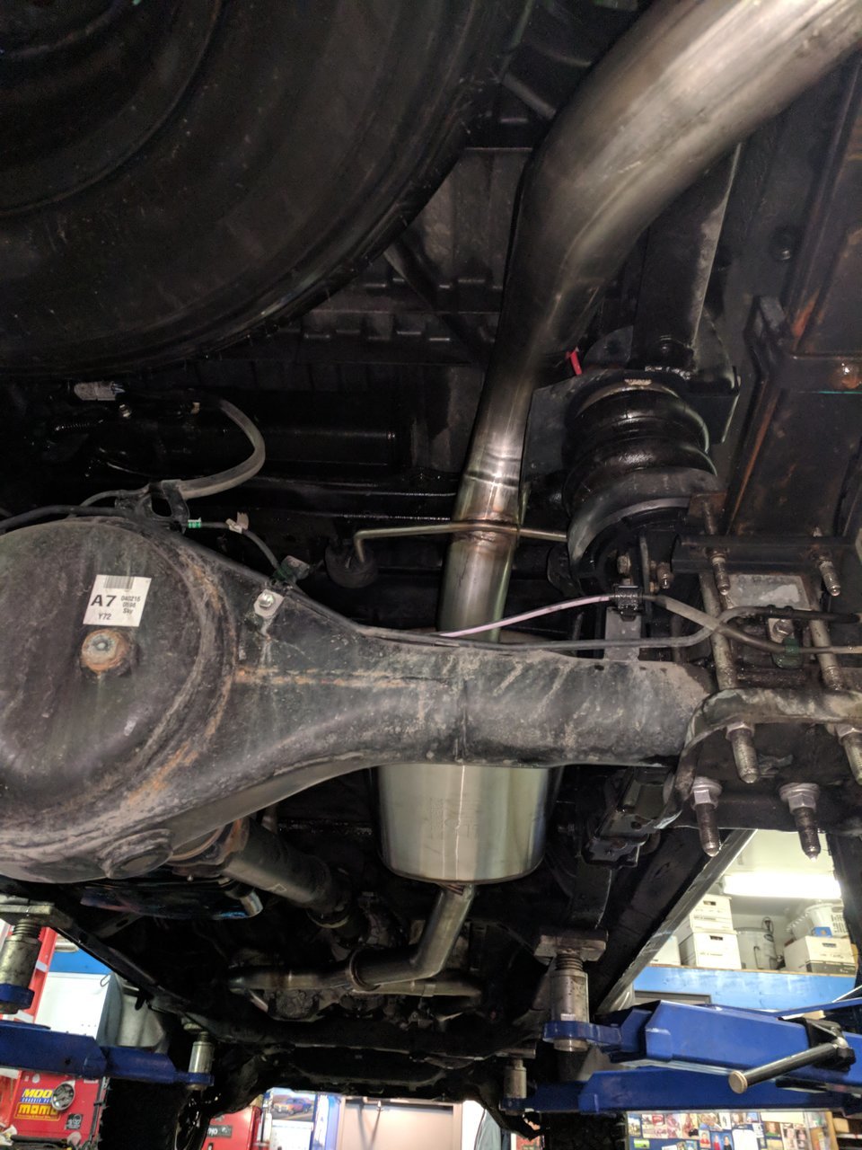

    Okay, the exhaust went in and it was flawless after the right y pipe was sent. Only thing I had to do was cut the pipe before the muffler 2inchs. All hangers were in the right spots except there wasnt on for the drivers side which isnt necessary but I will probably weld one up - not a big deal Quality of the bends and welds were great - no need to clean up anything - no burrs - perfect. The truck sounds amazing and with the afe cold air intake and scoop, she feels good. I still have to flash the tune from OV and then we will get some vid on the sound. In the meantime heres some pics for yall. Thinking it was worth the waitIMG_20180112_115408.jpg IMG_20180112_115408.jpg IMG_20180112_115411.jpg IMG_20180112_130804.jpg IMG_20180112_130936.jpg IMG_20180112_131000.jpg IMG_20180112_131010.jpg IMG_20180112_130750.jpg
    Cheers,

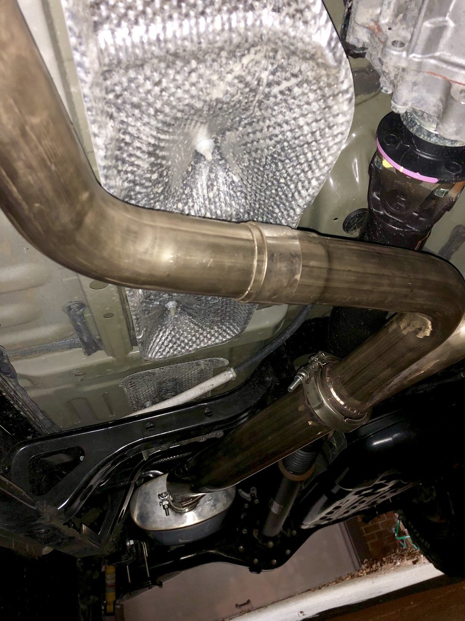

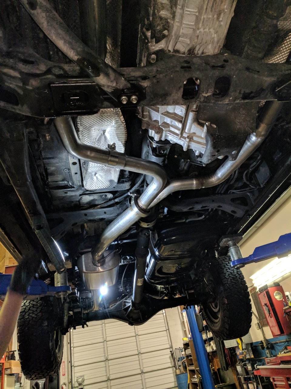

    Okay, Im totally happy with this setup. Sounds dope. Burble is gone, very little drone - Can totally live with this sound. I will post a video soon. Its raining cats and dogs.
  20. Jan 19, 2018 at 3:33 PM
    #420
    Yzkiley
    Yzkiley Well-Known Member
    Jun 18, 2016
    #189922
    292
    British Columbia, Canada
    2016 MGM Tacoma Sport DCSB MT
    rain guards, hood deflector, oem tonneau, BFG ko2's, led lightbar behind grill, highlift jack mount side rail, husky Xact front & rear mats, bedrug, AFE cold air intake with scoop, TB spacer, Spec U exhaust, Hikari - lumileds Led's, any time backup cam and gps, OV tune 103B, TRD pro grille, Cali raised pod fog lights, ECGS needle bearing, Bilstein 5100's, Low range offroad 3-1 level kit, SPC light racing ctrl arms, spidertraxx 1.25in spacers, Ride right airbags, clazzio seat covers, carrier bearing spacer, diff drop spacer.....
