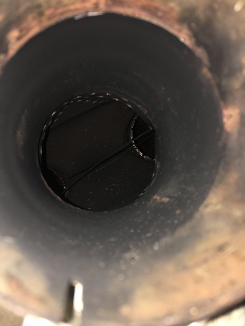

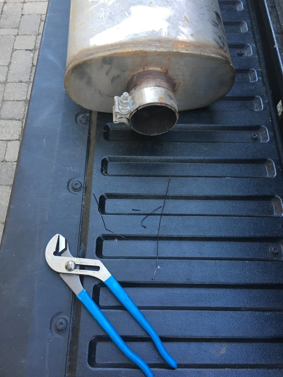

    The buzzing noise and droning is driving me nuts - also the weather was nice this weekend so i drove a bit with the windows down and it sounded embarassing. Argh. I checked the connections and there was some visible leak before the muffler, i undid the connection to clean and check it, and guess what i find. Welding wire inside the muffler! Thanks @Magnaflow !! Embarassing. Used my channel locks to tear all this out:
    Thought this would kill the buzzing but no bueno. Will do the resonator soon.

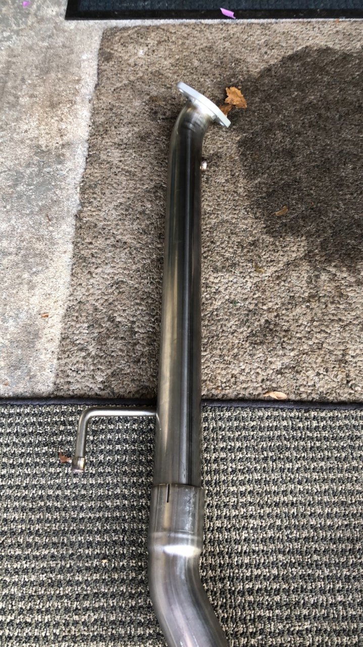

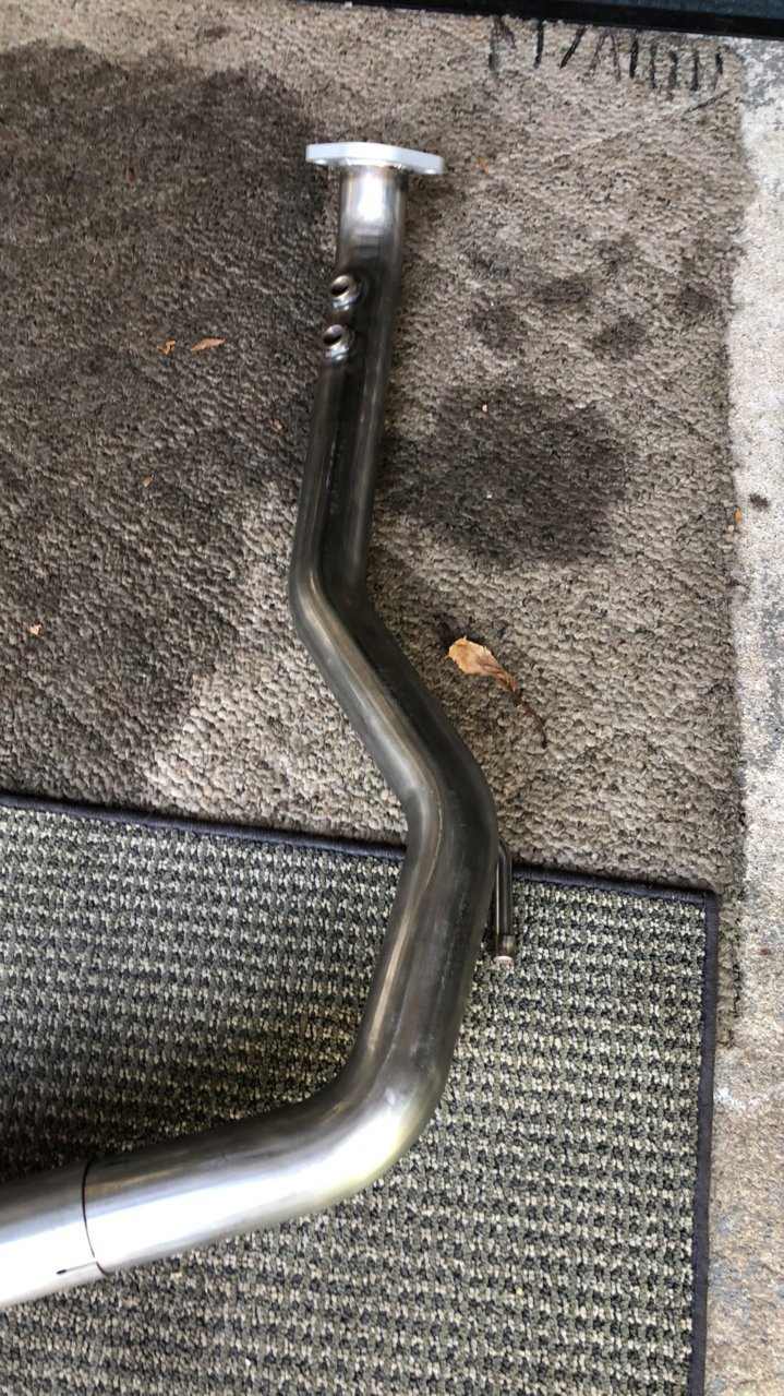

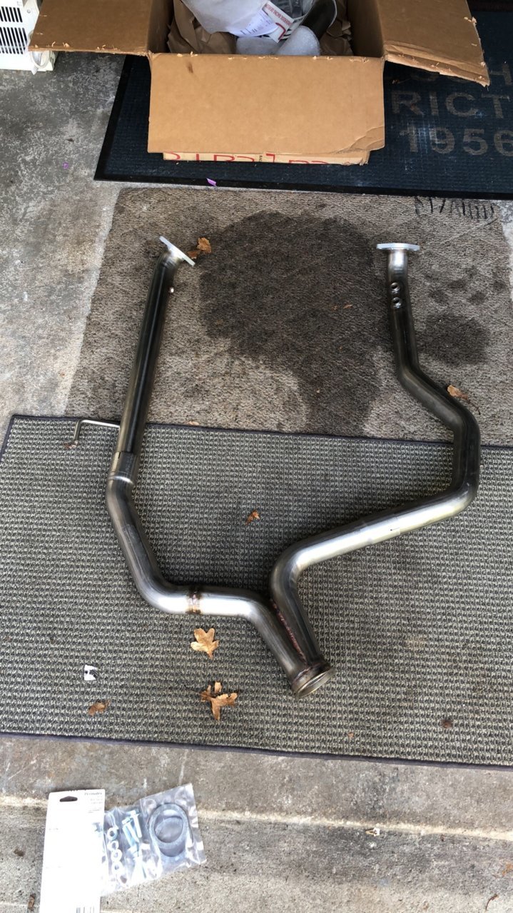

    looks like he listed to everyone and added the hanger to the driver side, everything fit right on, no 02 sensor problems, had to cut 2" off before the muffler tho
    sounds good loud but not too loud
