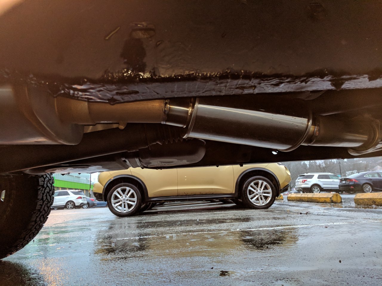

    Vibrant 3" ultra quiet resonator. Picture won't show up because I primed the exhaust and painted it flat black

    It sounds great now. I am so much happier I had it welded in before the muffler. The drone at 2500 rpm was ruining my commutes. No issues at any rpm now

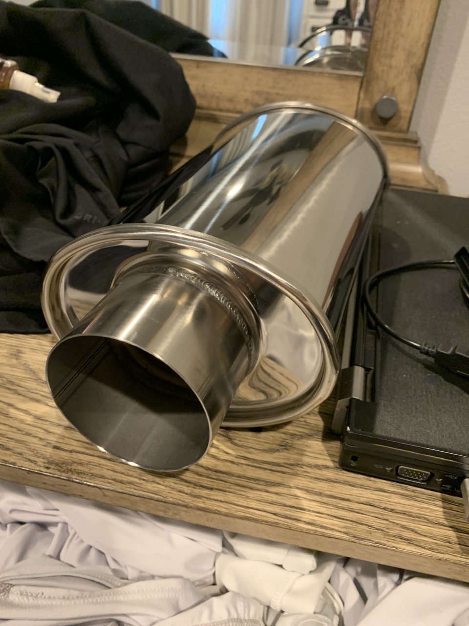

    Hopefully this helps!
    Vibrant 3” resonator
    Does anyone think it’s a good idea to get the V band welded in while I’m at it?
