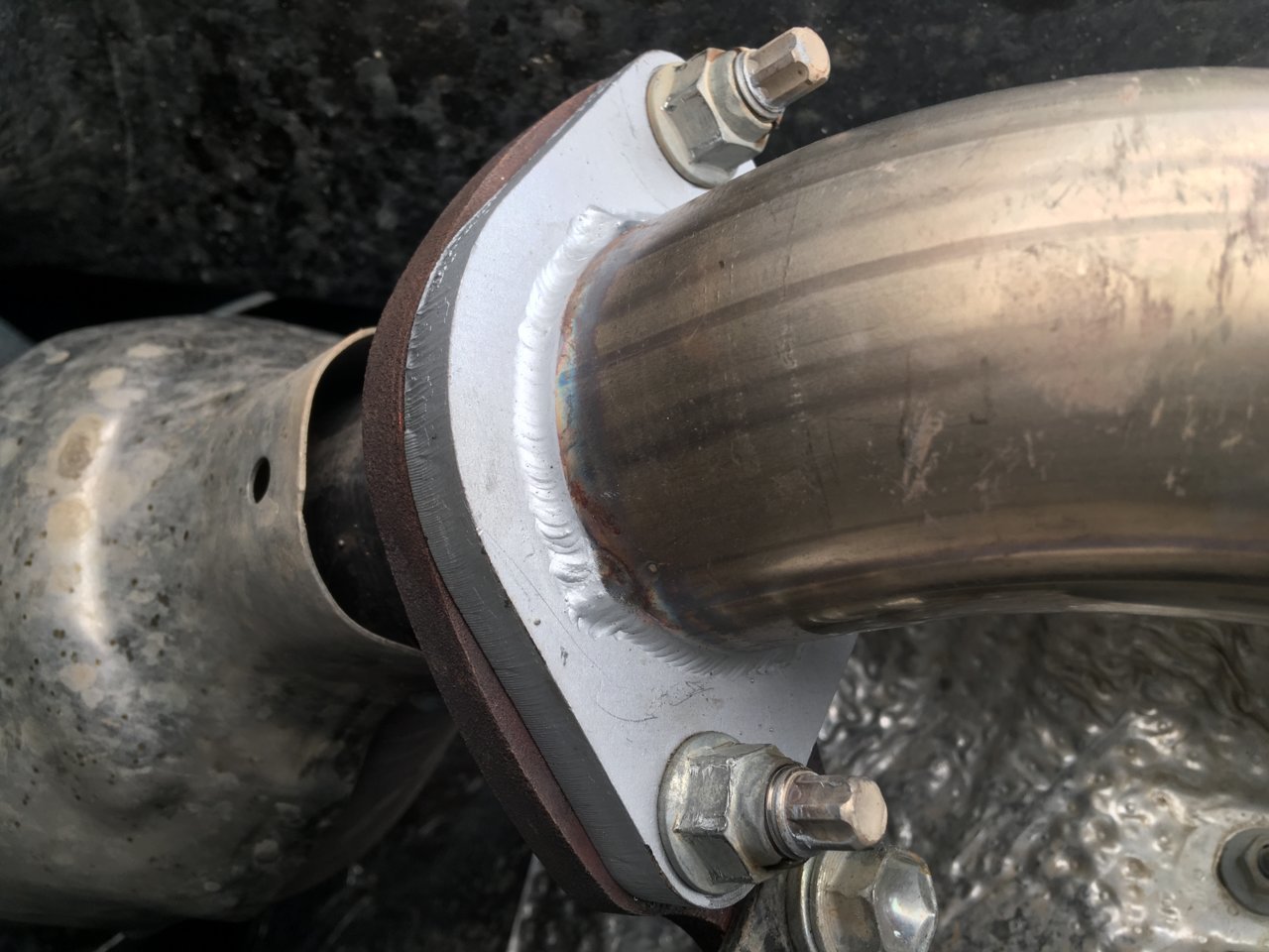

    Is it just me, or are the flanges on the Spec-U front pipes just painted mild steel? Not stainless like the rest of the piping and flanges?
    I'll take a pic later, but when I was working on the install last night, the flanges that bolt to the front cats really look like they've been spray-painted silver... They're noticeably different in texture and color relative to everything else.
    Update: here's a pic. If that isn't spray paint, what is it?

    I also want to point out this Spec-U exhaust drones like hell.
    After a couple days with it stock, I had to do something so I installed a Vibrant 1142 resonator (https://vibrantperformance.com/catalog/product_info.php?products_id=47) in the same spot a couple other people have, in front of the muffler and after the V-band joint. This is the quietest resonator Vibrant makes; much more quiet than a bottle-style resonator, they claim. It reduced the drone by about 20-30% (subjective), without affecting the rest of the sound by much, but it's still head-ringing between ~2000-3000 RPM. Right in the band where your RPMs fall most of the time... At higher revs this exhaust is almost silent. It's too quiet at high revs and really boomy at common cruising RPM!
    This isn't my first performance exhaust on a daily driver, but it sure is the most droning. I just emailed URD requesting advice.

    I like the equal-length sound a lot, too, but the build quality on this exhaust is subpar. The merge/collector piece was a real bear to get aligned with the post-cat runners. There's also no flex joint in the URD exhaust, unlike the stock one, so sometimes the engine is trying to move in ways the URD exhaust doesn't like... You get some creaking/flexing sounds from the exhaust just driving casual in town around 2000 RPM, and if you're full-throttle for an extended time at that RPM (like driving up a mountain road) it gets even worse.
    Also, one of the exhaust hangars on the URD was welded wayyyy off angle -- it would have rubbed against the frame if I hadn't cut it off. Oh, and the exhaust doesn't use flanges and gaskets: it's all slip joints and clamps. URD doesn't get a free pass on that just because it's aftermarket. At this price range there are other aftermarket exhausts going the extra mile to use flanges.
    These issues, combined with the owner's cavalier attitude towards customer complaints, have completely soured me on a $1200 purchase. Buying it was a bad decision.
