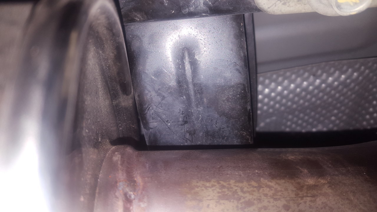

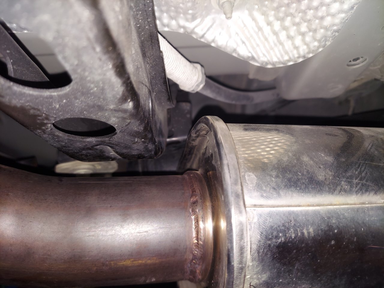

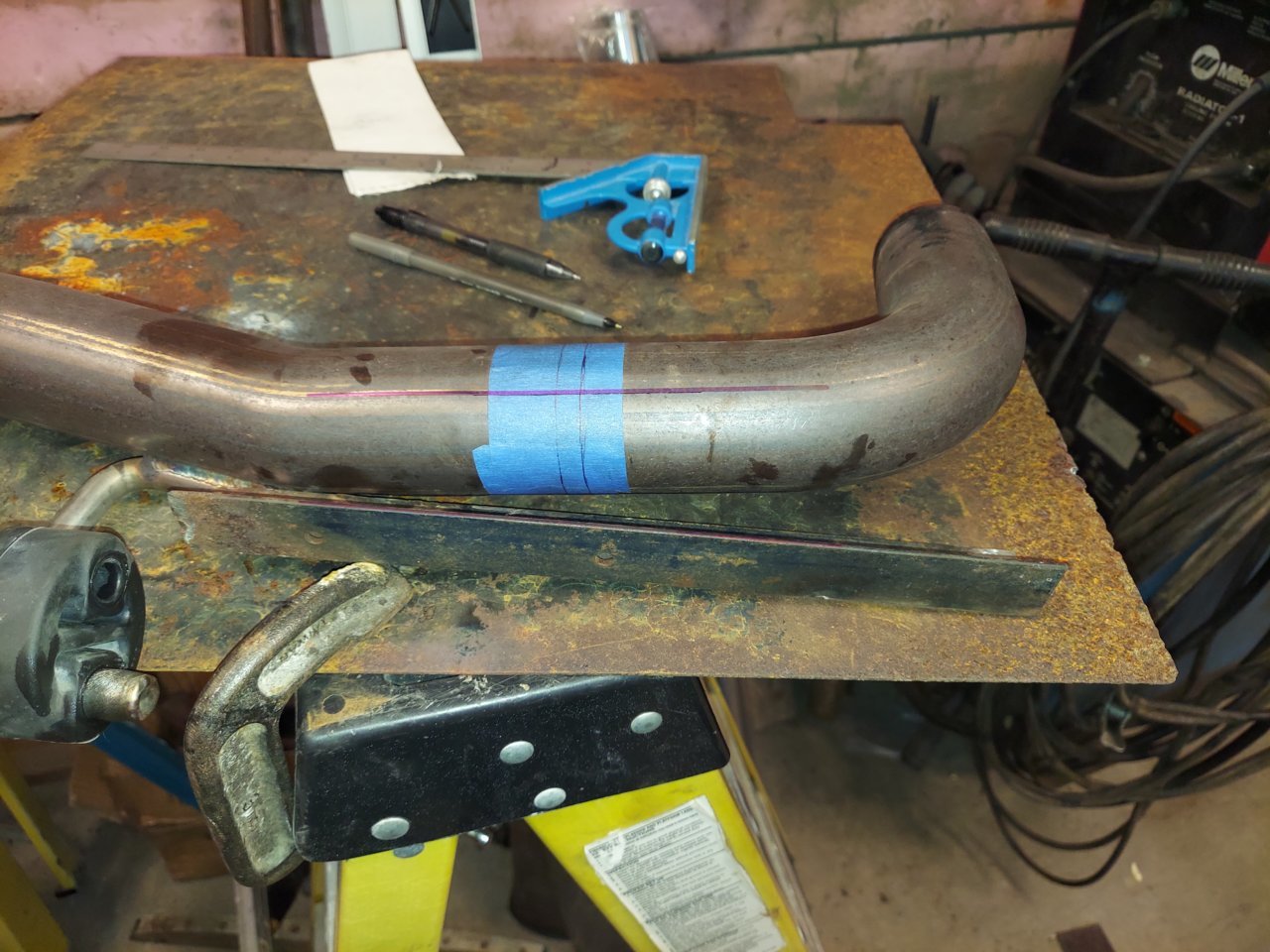

    Anyone have fitment challenge on a AC/LB? I installed the system, and had some trouble with the enclosed-Y pipe, case hitting the cross-member for the carrier bearing, at the rear of the case, and I also had a slight issue at the rear spring to tailpipe, when the suspension is completely unloaded. It also was a struggle to mate up the V-band connection between the Y and the muffler.
    I did get it all together, and with all the clamps loose, I tightened the front flanges first, then: noticing that the Y-case was touching a cross member, I tried shoving everything forward, to no avail. I also slipped the tailpipe out of the connection as far as I dared, as the pipe was hitting the rear spring, with the suspension fully unloaded. I noticed that I could rotate the tailpipe to fix this, but I did not like the look of the tip pointed down, so I set it level; how often is the suspension fully unloaded anyway.
    But then on testing, the casing of the Y pipe was definitely touching the cross member, and making noise, so I wrote to URD, and was informed they have had no other reports, and that I should try loosening the down pipe from the motor and everything and it will fit. Did that, and no change, so I loosened everything again, and noticed that rotating the muffler a bit, raised and lowered the y-pipe a bit, so i rotated it what I could, and acquired almost 1/4 in clearance, and tightened everything again. Though now the rubber hangers for the muffler are not proper, one is horizontal and one is ok, at near vertical. So I heated the other rod for the hanger and bent it down, so it provides support.
    This still makes noise when under certain engine torque. URD says to stop in at their shop and they can take a look, but too many miles between us for that.
    In my opinion and observation, the connections forward of the Y-pipe do not provide any front-to-rear adjustment, the slip couplings are perpendicular to the truck so zero there, the flange bolts are no adjustment, and loosening the down-pipe from the motor did nothing either. For the correct fit, the pipes along the transmission need to be 1/2" shorter, and the tailpipe then lengthened by about 2-1/2 inches (1/2 to make up what would be removed up front, 1/2" so it fully seats in the muffler coupler, and 1-1/2 inches for the tip to move rearward, where the lief spring is higher, to miss hitting the lief spring).
    I am happy with the sound, and the build quality overall, just challenged with the fitment, and don't think I am likely to go so far as to cut this apart to fix it, It just sometimes sounds very much like a TRUCK.
    Anyone else have trouble with hitting the cross member?

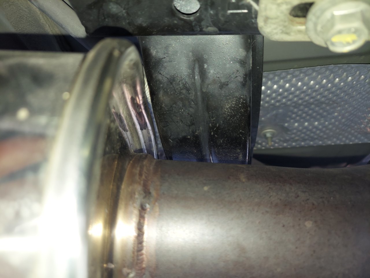

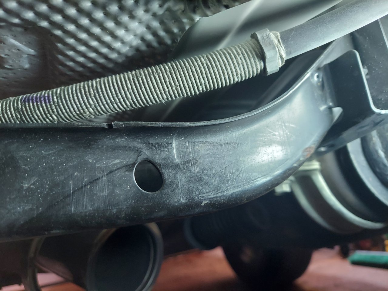

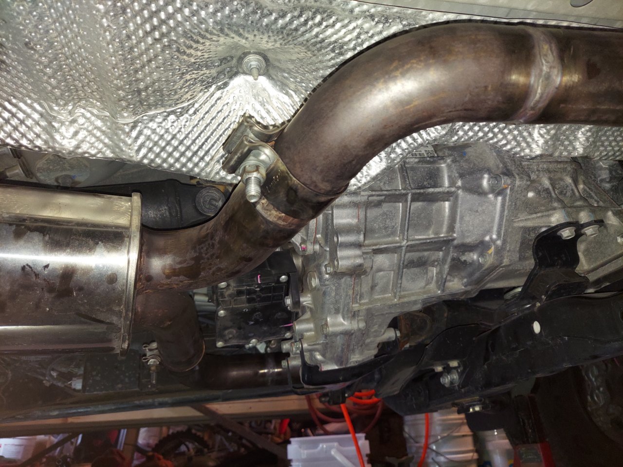

    Update on collector case hitting cross-member: last summer, I got tires of the noise of the exhaust hitting, so I again loosened everything and tweaked, to no avail, so I started removing rubber hangers and noticed that I could get a sliver of daylight by hanging the exhaust lower, from the muffler back. So again I got out the torch and bent the hangers to make that happen.
    All done, this provided a good 1/4" gap vertically between the pipe and the cross; but only a sliver of daylight lengthwise between the collector casing and the cross.
    Test driving proved this to not fix the issue, and with the only options to be:
    - Leave it, and live with the vibration noise
    - Drive to URD in Maryland, as the only option they give is to visit for them to see. They report that I am the only complaint.
    - Cut both left and right pipes before the Y, an\nd shorten them by 3/8".
    Frustrated with what I spent and lack of a reasonable solution, I took a hammer to the flange of the collector casing, and dimpled it right where it touched the cross, by almost 1/8". Not a great solution, but I was spending a-lot of time to resolve an issue with manufacturing. this gave me 1/8' clearance.
    Well the clearance made it tolerable, and now it only touched and vibrated sometimes, mostly at about 1,800 rpm, where teh engine seems to shake a bit more that at other RPM. Was tolerable to me, but NOT to my wife. She was not informed of the problem, but would complain that the noise was causing her pain, whenever the truck was near that RPM.

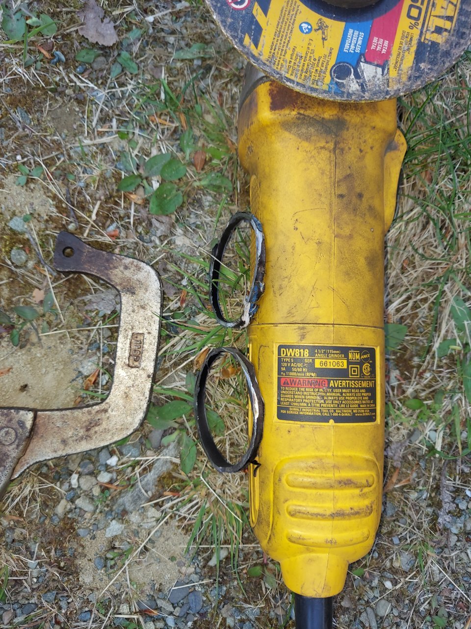

    20220521_201449.jpg 20230513_144500.jpgYesterday, I again started testing with removing one rubber hanger at a time, and test driving, and for teh first time, I was under the truck while the exhaust was hot; Sure enough, while hot, it the 1/8 gap was gone! With about 5k mile this way, you can now see where the paint was worn off the cross too. Removing hangers and hanging lower did not fix this, so it is time!!!!20230513_182140.jpg I removed the exhaust, and cut out 3/8" of pipe, on each of the collector pipes, where parallel to the frame, and welded them back together. With alignment marks and by clamping them to a piece of angle, I was able to do this without tacking and tests, jut cut and welded them back together.20230513_163044.jpg20230513_184948.jpg
    Problem Solved!
    I should not have had to do this, on such a costly and high quality product, but I am sure glad that I did. It needed to be corrected.
    WOW, that pipe must have been hitting more often that I thought, because now it is actually VERY quiet in the cab with windows up! BIG DIFFERENCE!. Wish i had done this long ago.
    So if your Spec-U exhaust is in any way loud in the cab with closed windows, then you need to look close at this point on the cross-member. I cannot believe how quiet this is now. Really sounds like factory again from in the closed cab!!
