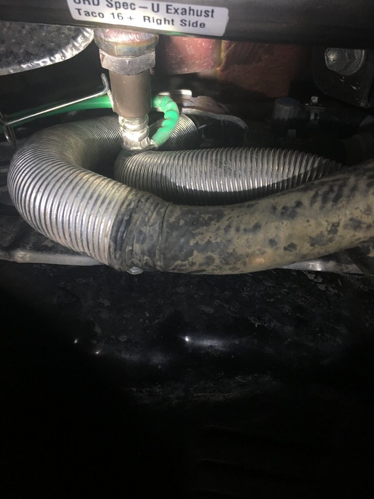

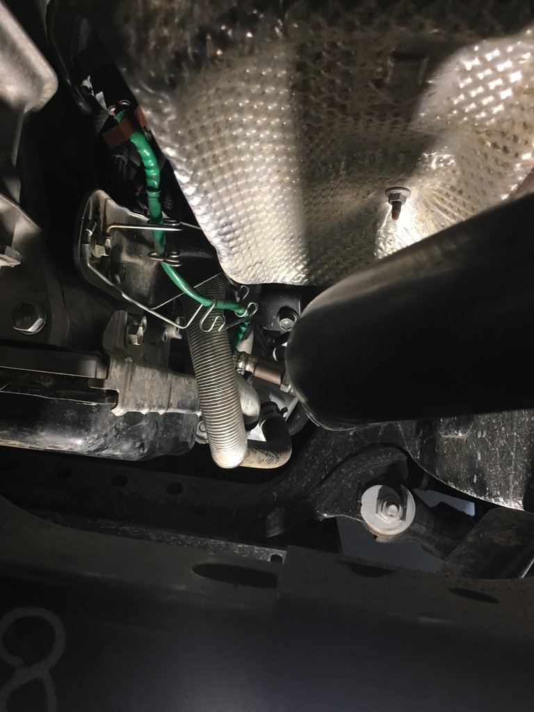

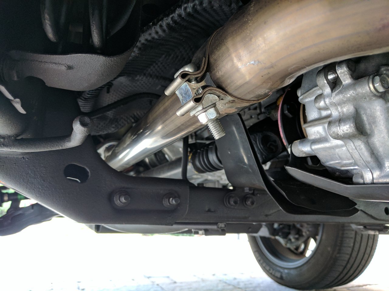

    I have mine half installed and discovered a problem. The right side O2 sensor bung on the Spec U is moved 1 1/2" back further than stock. This is causing the O2 sensor to hit a external transmission line on the right side. Anyone else with an A/T with the Spec U installed?
    I sent UDR pictures Wednesday and some more yesterday. Waiting for a fix. I don't want to take it off and install the OEM system but I can't drive the truck with a hot exhaust part touching a transmission fluid line.

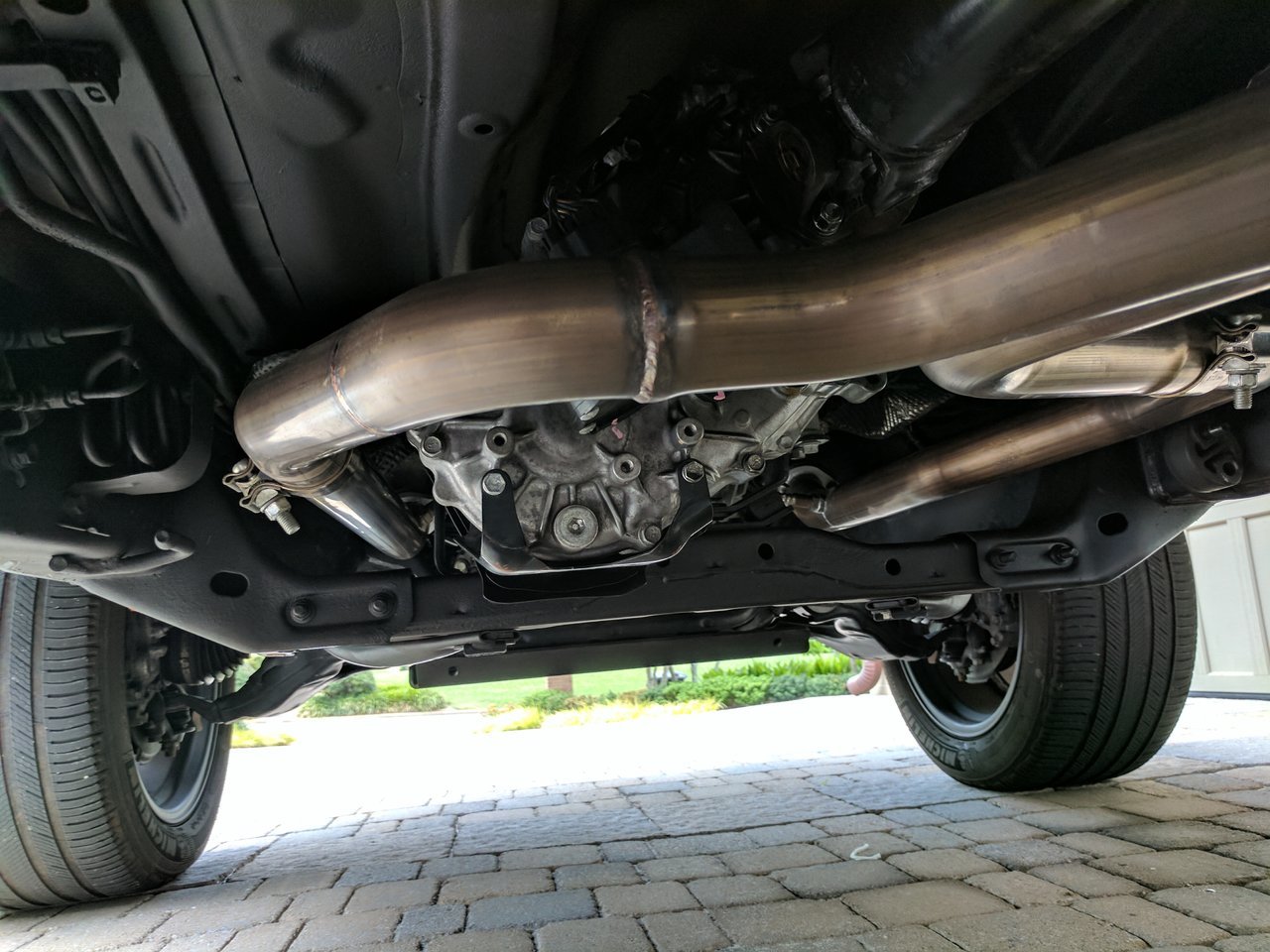

    that pic makes me want to buy this for the clearance alone. crazy improvement and I'm not even thinking about the performance bit yet.

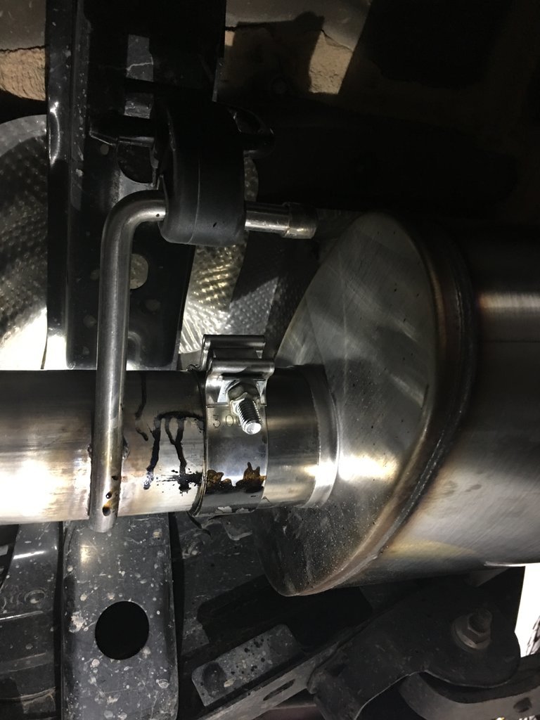

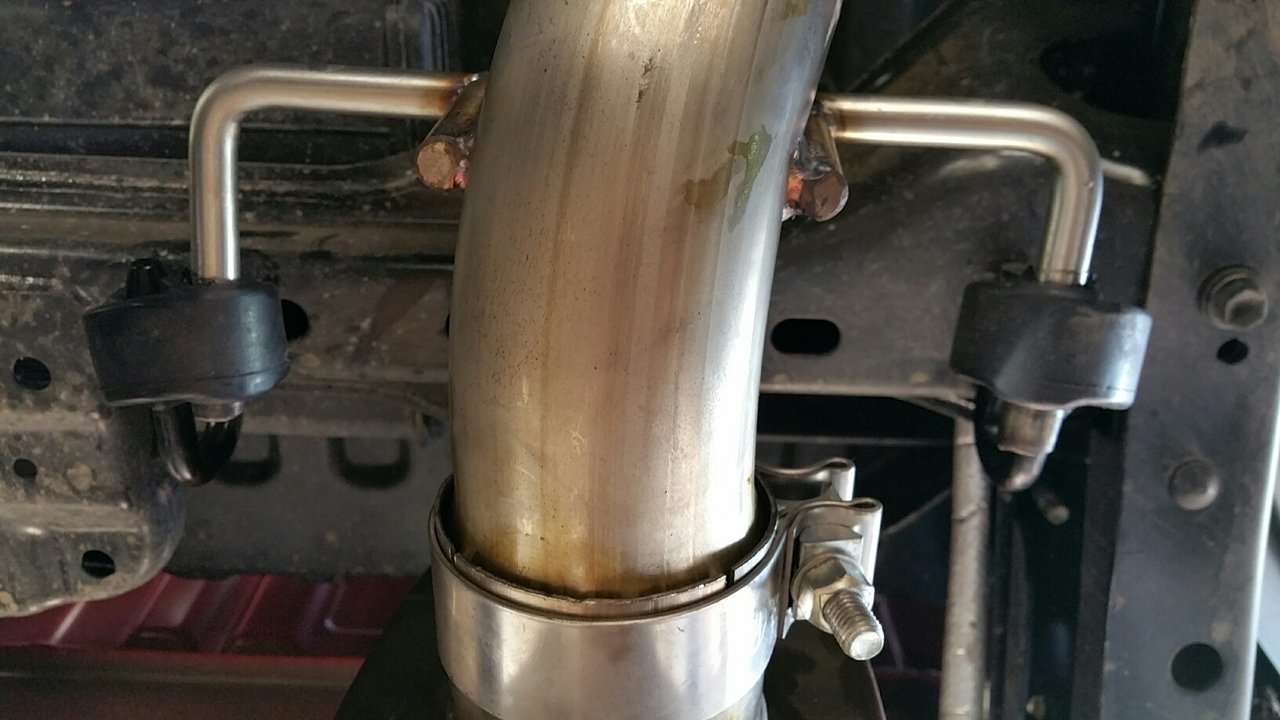

    Has anyone that has installed the U- Spec exhaust had a problem with the double hanger not aligning correctly? I wasn't even able to seat one of the holders.
    Initially I thought one of the pipes wasn't seated all the way, so I took the exhaust off and started over again. I made sure there weren't any burrs and made sure each piece bottomed out firmly and was in as far it would go. The other 2 out of 4 hangers align perfectly which makes it seem like the hanger was welded in the wrong spot by roughly 1 inch. It's worse than it looks in the picture, but its hard to get a picture of it without a lift. @Gadget@URD

    If the tail pipe section can be moved a inch forward with out creating a problem with the over the axle or the rear mount I would shorten the pipe that has the V clamp on it at the muffler by 1". I didn't buy the tailpipe section so did not have the problem you are having. But when I did the install to help with the dump pipe location I cut 2" off the that pipe to move the muffler further forward.
    Do you have an A/T? Did you have any issue with the right O2 sensor? Can you take a picture of the the O2 sensor that show where it is in relationship to the rubber A/T lines and how it is clocked on the pipe?

    Yeah you shouldnt have to seat all the pipes all the way back, get it to the point t where all the mounts fit correctly and then make sure the pipes are connected enough that there's overlap where the clamps go and you should easily have an extra inch of clearance

    17 Tacoma DCSB OR Inferno
    With 2" cut off the V clamp pipe at the muffler this is how close the muffler is to the front hanger.
    SilverII likes this.

    Yes, they are going to build a replacement front right pipe for me. I hope I can get it by Wednesday, as I want to go wheeling and camping next weekend.

    Gadget's clears on his truck. There could be a variable in the pipe or truck that caused mine to hit. I would do that pipe first to see. Hard to tell until the new pipe and sensor is installed.
