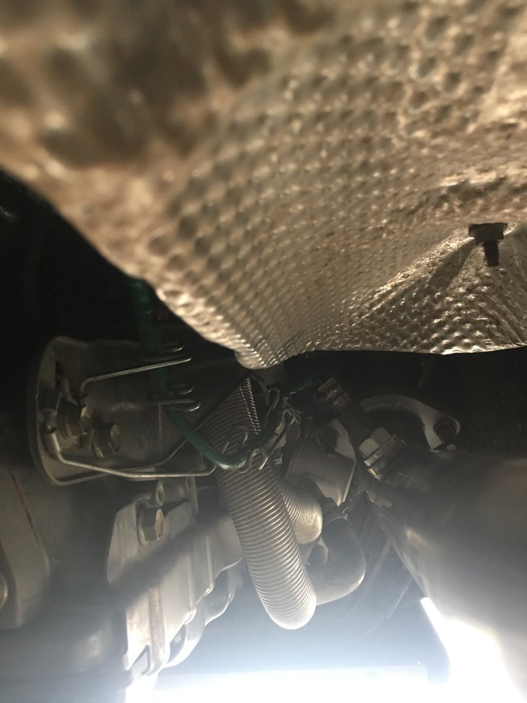

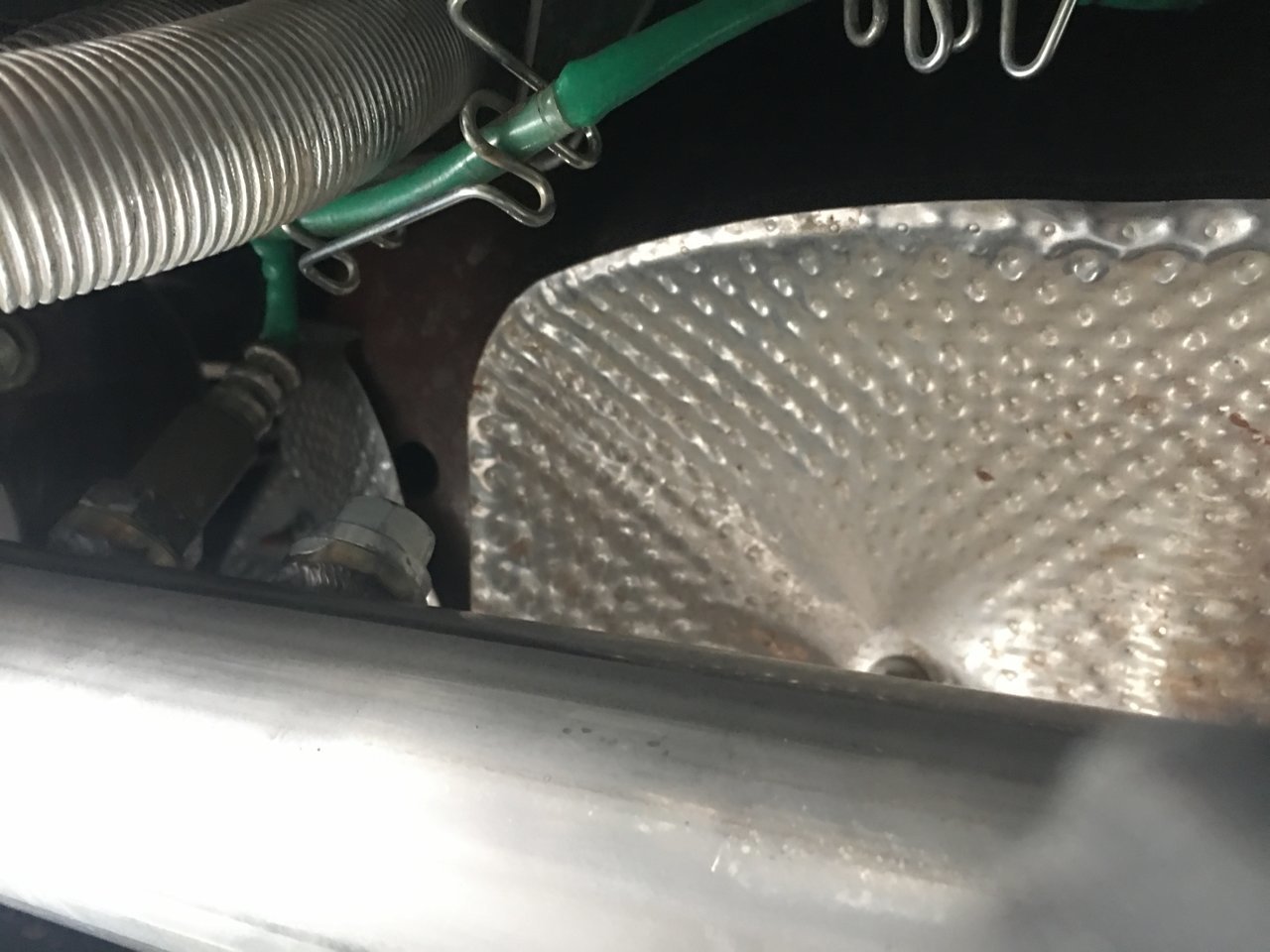

    And nope, it hits the transmission lines.
    Hopefully he sends a pipe asap. I know URD is good to work with and makes good products, but I'd expect more from a $1000 exhaust system.

    That's what I was thinking. I went for the $1000 exhaust versus the cheaper ones and I can't install it!
    You didn't have to jam the o2 sensor into the transmission lines?

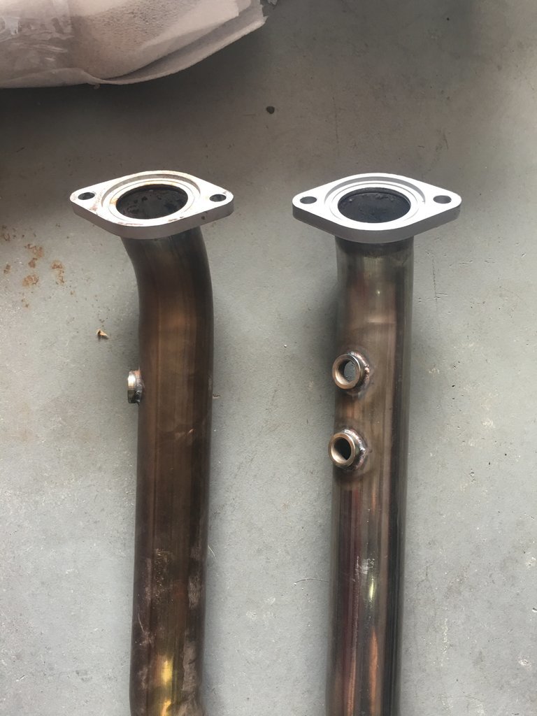

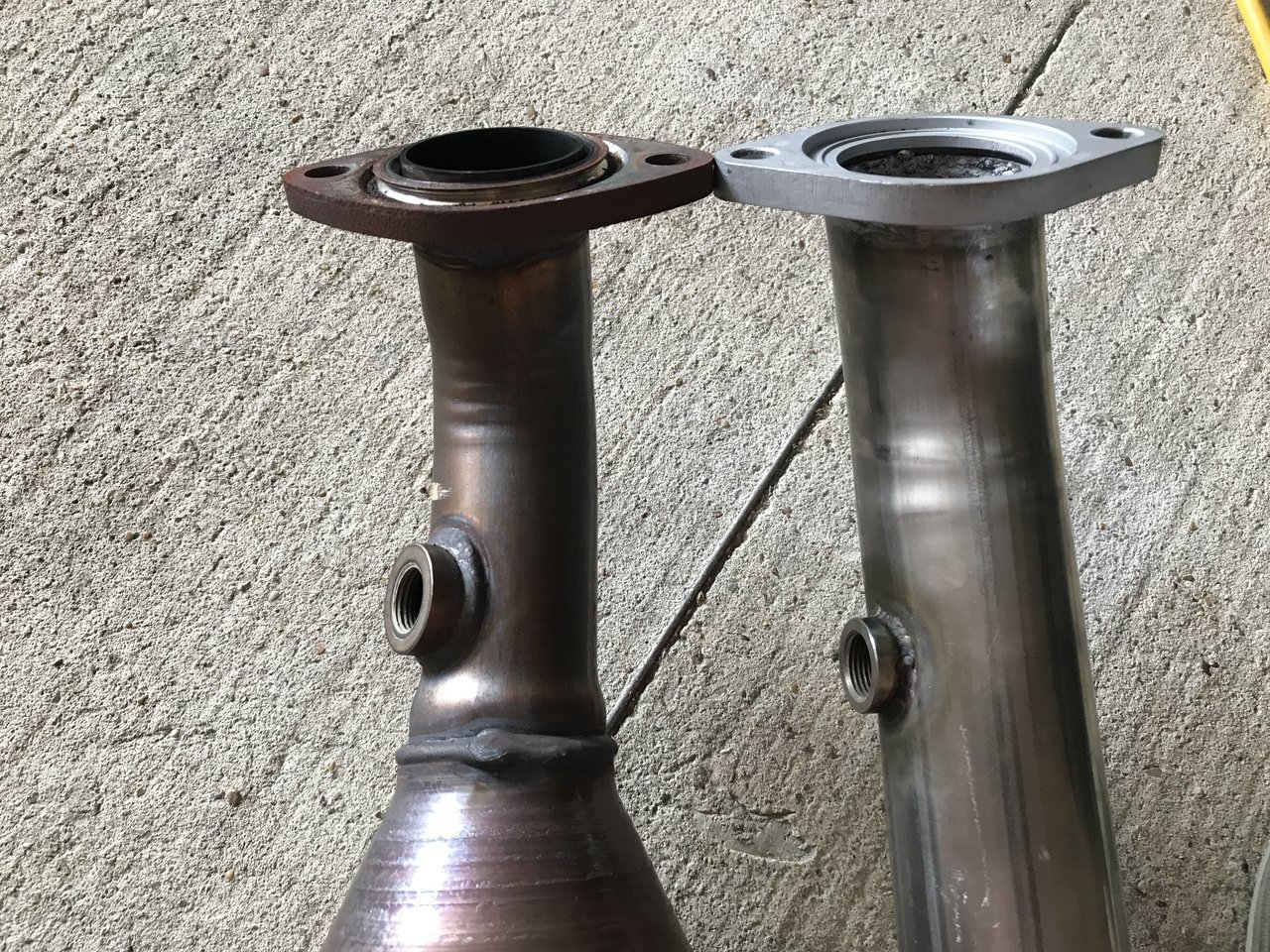

    The fix is good. They rotated the bung up and added the second bung so you can add a wide band O2 sensor. I already sent Gadget an email. I used the front bung for the OEM O2 sensor and think it is very close to OEM location.

    Well if his fix is just 2 bungs, I'm gonna go get it done at a shop tomorrow. Screw waiting.
