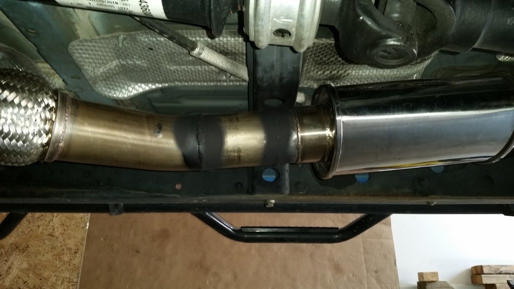

  9. Aug 10, 2015 at 5:35 AM
    #29
    Vassily28
    Vassily28 Well-Known Member
    Nov 24, 2011
    #67629
    423
    Quebec, Quebec, Canada
    11 TRD SPORT 4x4 Quadcab LB
    TRD supercharger with 2.85" URD stealth pulley and OEM FPR mod. URD fuel pump upgrade, URD TB plate adapter 70mm, FJ/4 runner 70 mm Throttle body, URD exhaust cam gears URD performance thermostat TRD CAI 1st gen. with custom cover (coupe), ProDry S + Filter skin, Doug thorley long tube headers, URD spec U exhaust Icon LT 2.5 front coilover, Timbren front bumpstops, Total Choas UCA, Deaver custom leafpack 3 inch. lift, Icon 2.5 VS series rear resishocks, Timbren rear bumpstops, ARB front bumper with WARN 8500 lbs winch,Hella 500 blackmagic, AVID rear bumper, Allpro front IFS skid + Trans. skid + Transfercase skid. Total chaos LCA skid, SS braided brake line, URD O2 sims, URD MAF controller, Wetokole front seatcovers, Innovate MTX-L, MTX-D AFR and boost gage.
    Installed yesterday my spec U exhaust system and had exactly the same problem. My truck is a 4WD DC Long bed. And i've used the same solution. Cut 5 in. piece of pipe for the part between the 2 exhaust and weld at the same place. Also has a problem with a hanger that was to close from my Deaver leafpack (3in.).
    I was a bit disapointed that this problem has not been adressed by URD cause never had bad experience in the past with Gadget and URD parts. I should say that the sound is amazing.

    Well I'm glad you got yours fixed. I told Gadget that there was a problem. But I got the we have had no issues. Thanks for confirming it.

    He told me that if I drove to Maryland where they are base at he would look at it and fix. That's like a 6hr drive. I told him no. I have 2 small children and I'm not driving that far for something that I can fix myself.

    Luckly I have all the tools to work with metal. So I cut and welded myself at my house. I just want a part that fits for the money I spent. I guess that's too much to ask!

    I'm curious about what is causing there to be some obvious discrepancy between whichever DC LB they tested, and your two. Which would mean that there are there which would also have the problem.
    Is it a year model difference perhaps, or something else?
