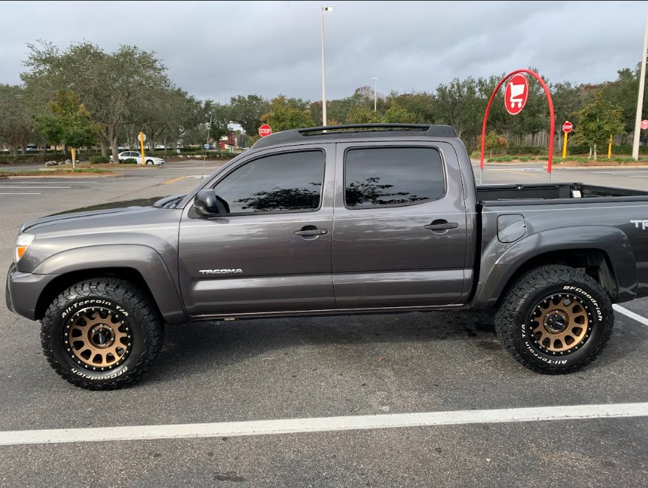

    Hey, been lurking through this and multiple threads about the URD spec-U headers and noticed a general consensus that they can cause some of that "ricer" rasp that people try and tame with some resonators.
    Currently I still have the stock headers and y-pipe with the AFE Rebel series catback and i love the tone but after a couple years want more. I've been looking at the doug thorle "pipe bomb" y-pipe with dual 10" resonators to pair with the URD Spec-U headers.
    Ive watched every video posted on this thread just about 5 times over as well as nearly every video on SconnieHailer's youtube channel with his taco, managed to also find another gentleman with a setup very close to the one i am looking for, only difference is he is running the URD y pipe without resonators, i would imagine the only real difference would be the slightest bit less rasp and more centered tone with the dual 10"resonators with the doug thorle y-pipe.
    Any thoughts, opinions, 2-cents, comments from the peanut gallery or experience with this kind of setup?
    https://www.youtube.com/shorts/nqFq2_1ChNY
    https://afepower.com/afe-power-49-46033-b-rebel-series-3-409-stainless-steel-cat-back-exhaust-system
    https://urdusa.com/89227-doug-thorley-tacoma-pipe-bomb-y-pipe-2005-v6/
    Taco as it currently sits
