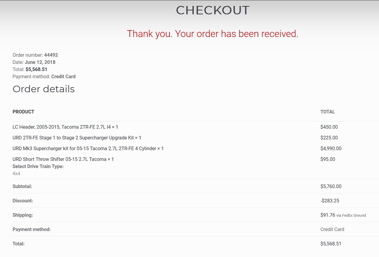

    OK finally placed my order.
    This + a catback is how to up your performance.
    With the TW discount I got the short throw shifter & part of my shipping for free.
    Greenbean, Steves104x4 and MY50cal like this.

    What is the TW discount? I am planning on purchasing the same set up, within the next week. I need the power hahaha. But:
    Does the Kit come with any wideband/ afr gauge/
    Boost guage?
    And how to I get the discount becuase when I put all these items in my car it is much more expensive

    Code is > tacomaworld.com
    Mine will be here Friday
