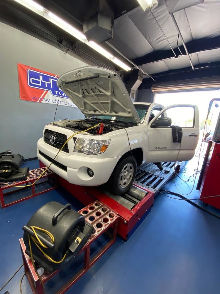

    Not Ready for Prime Time but I think it’s ok to sneak a peek! Working on 9 lbs w/ crappy 91.

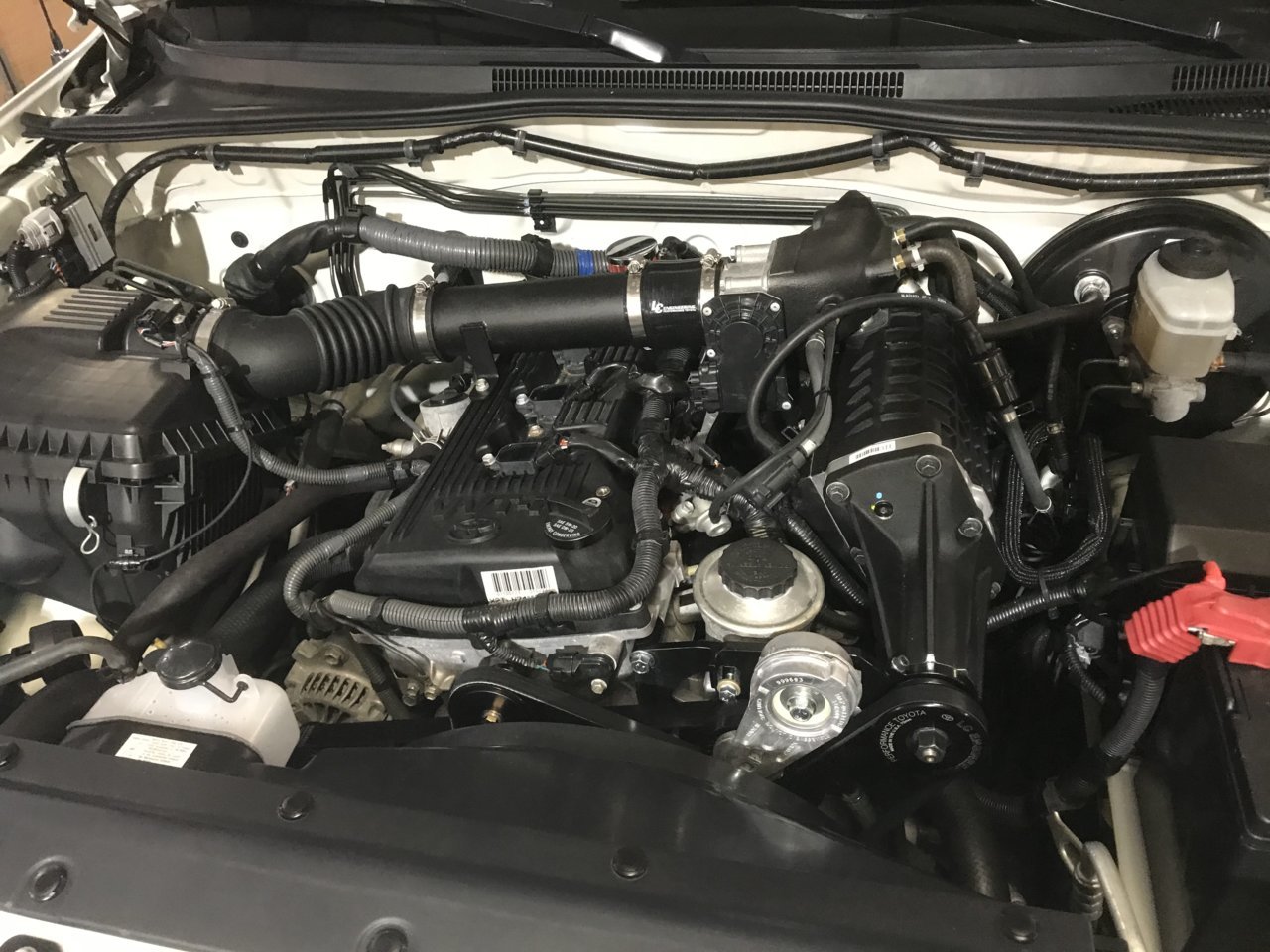

    The stock ECU as of right now. The tuner is saying they *think* they can make it work, time will tell.
    Sorry to hear that and damn don’t tell me that! That’s our 07 we picked up from NC a few months ago with 27k on the clock.
    The vendor is telling me that 9 lbs is no problem for the bottom end and tell me about it! Some used 2TR’s are selling on FleBay for the price of a new LS crate motor… Sold the URD kit on our 15 Access cab to possibly do an LS swap. But it’s looking like it may just get a new system too.
    Hmmm… If you enlarge the top photo the vendor name is on there. Like I said not really for Prime Time.
    *Edit*
    Just got news they are going with different injectors. Just glad the tuner is being careful not to let it lean out to much.

    Me too… The vendor found better injectors, they are coming from Cali. Not tuned torque 237 @ 2300 then abort.
    After they finish, install the new LCE header. I’ve ordered two Magnaflow’s, a 5x8x14 will replace the 2nd cat & a 5x11x22 should help w/ 2.5” SS exhaust. Then install the 3.73 gear I have waiting.

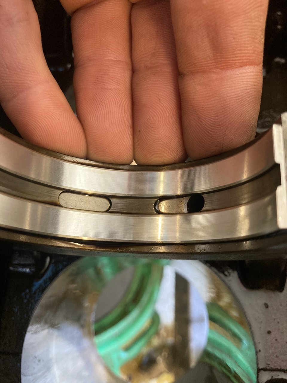

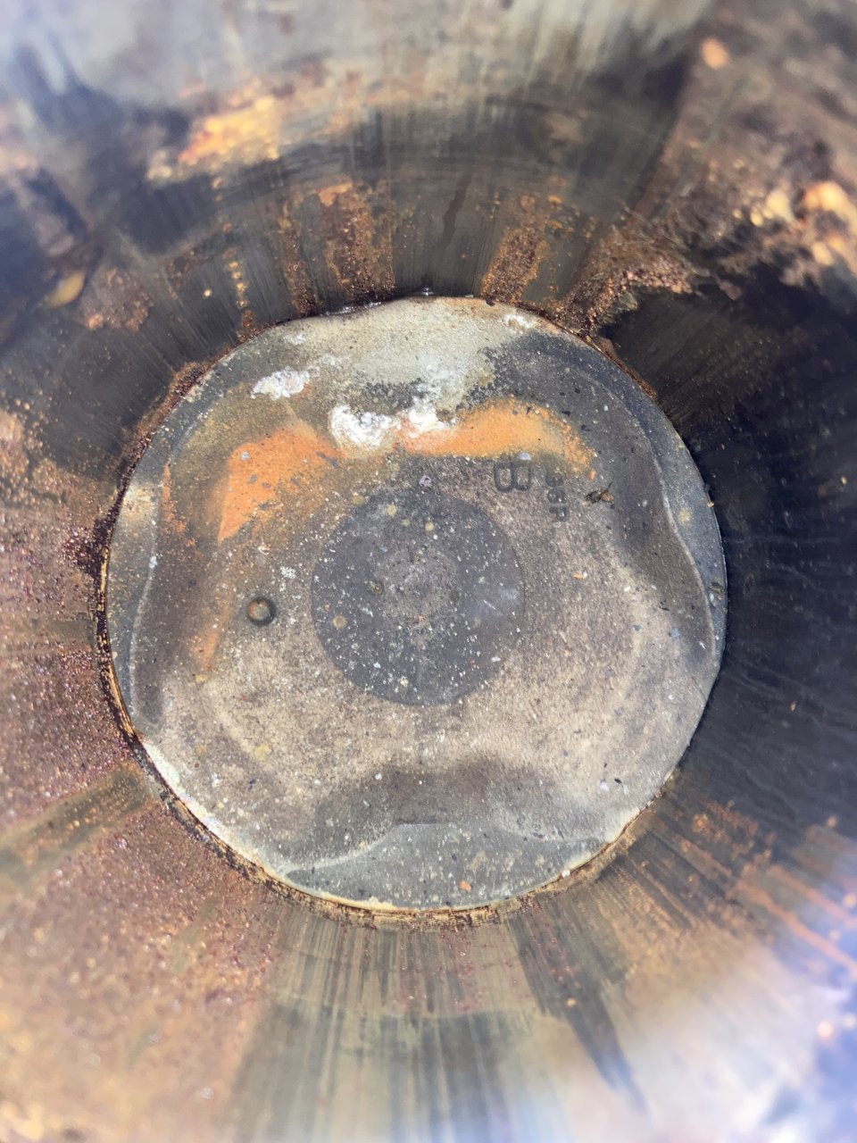

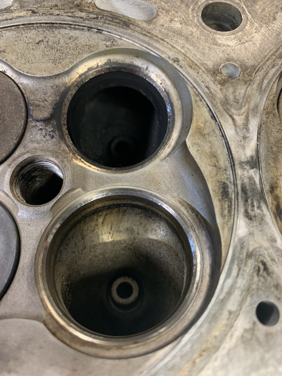

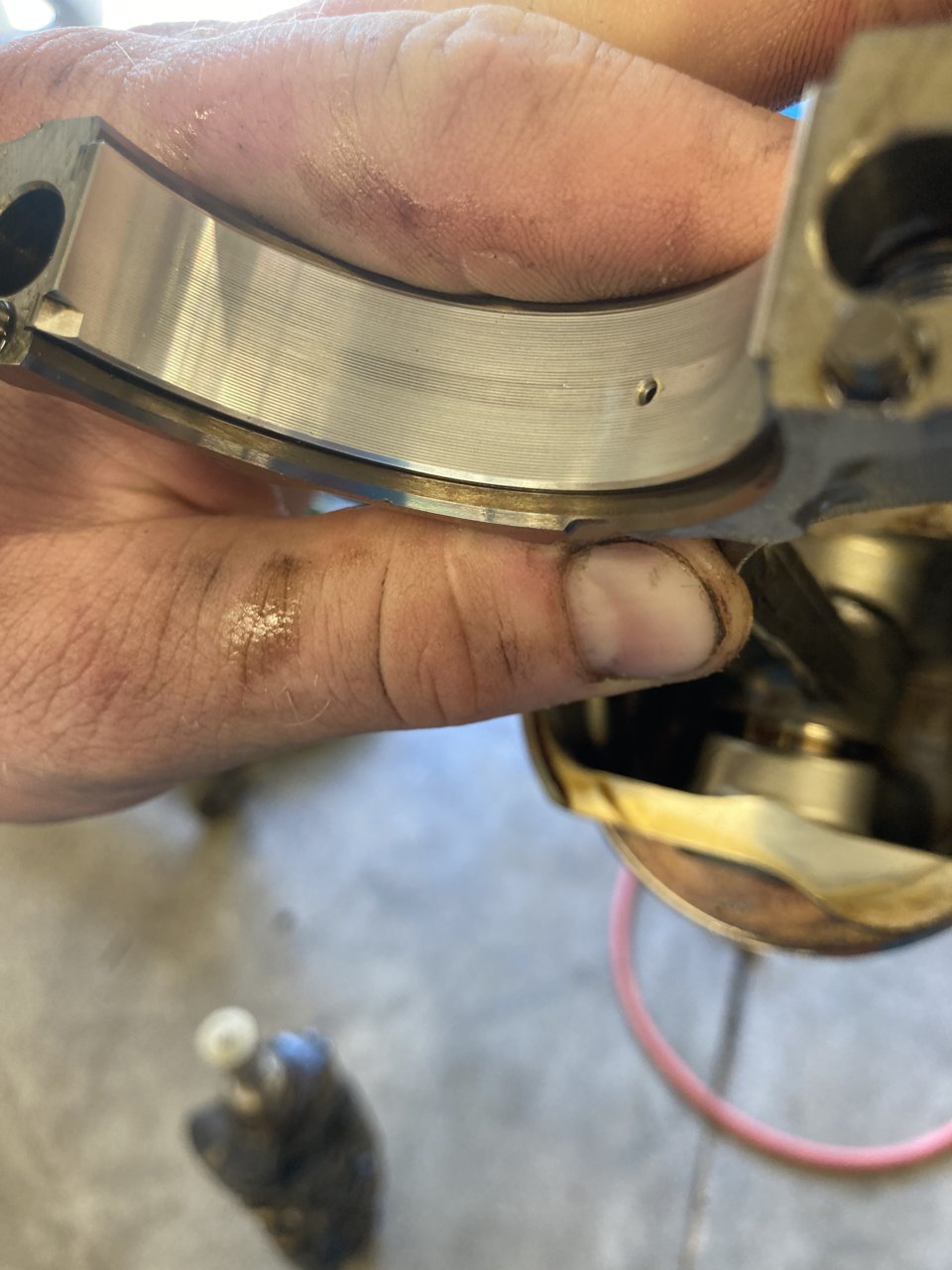

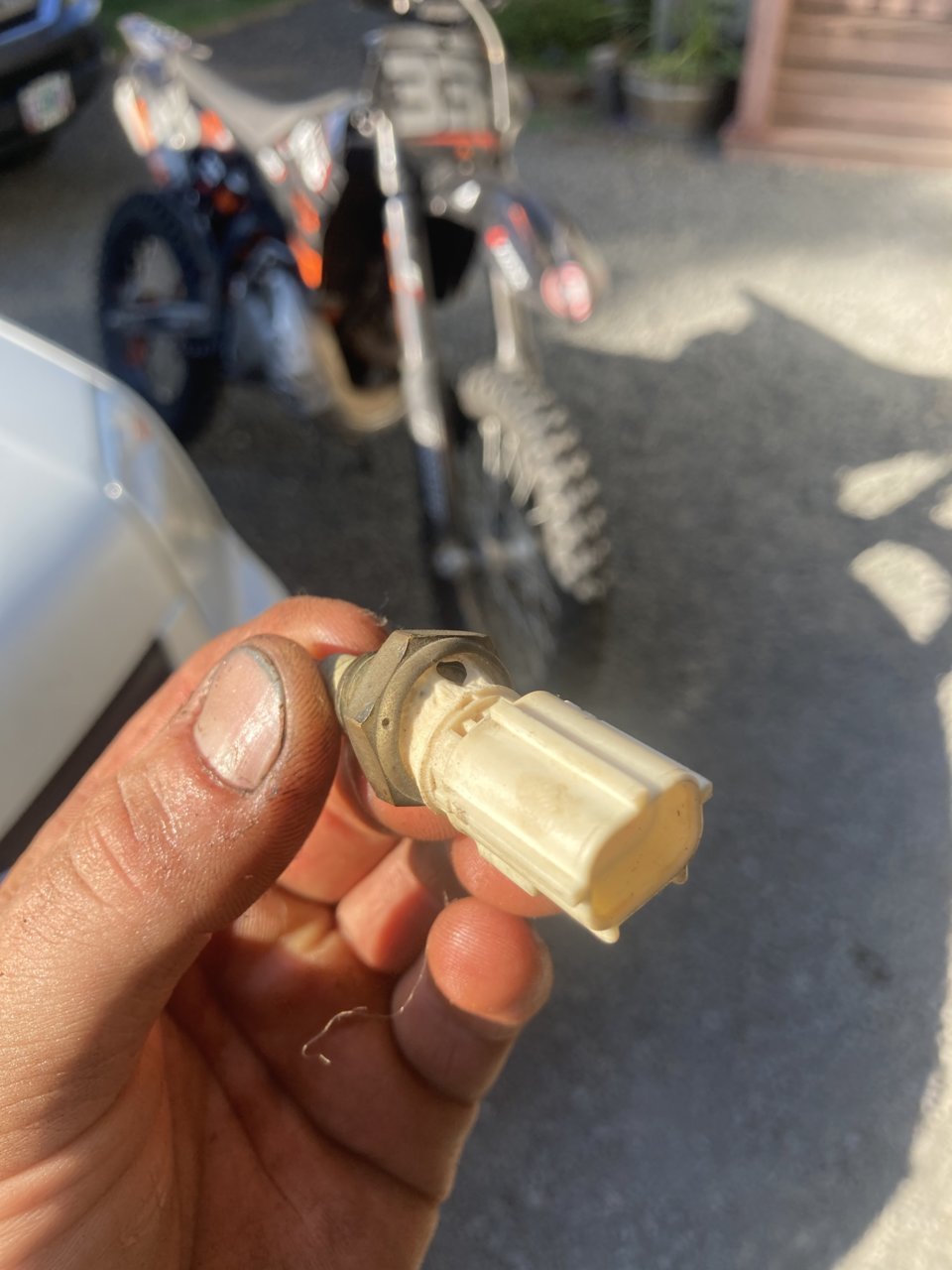

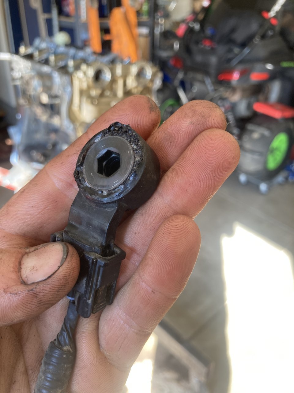

    Good news.. tracked down a second donor motor and took a bore scope to peak inside before purchase. It was beautiful inside. I say another one because the first donor supposedly has a bad head gasket and in reality… it did… which got ignored and more than likely redlined until the pistons stuck and the aluminum from #3 had melted and whisped away out the exhaust valves exposing the seats New motor #2 was flawless at 219k miles. But does need a valve job and head gasket. Just look how fresh these bearings look after rolling over 219k, cross hatch is perfect without even a hint of a ridge at the top of the cylinder. Valve seats were leaking pretty good. So LCE is now sending an oversized valve kit on my order.
    BaseTaco2wd likes this.
  13. Jul 10, 2021 at 1:07 AM
    #853
    Sscustoms
    Sscustoms Well-Known Member
    Mar 30, 2020
    #323433
    107
    Seth
    05 taco 2.7 5spd
    -315s on Methods -5.29 gears -Arb/Detroit lockers -Twin Arb compressor -LCE header -mandrel 2.5” side exit exhaust -4X rock sliders -LCE dual comp clutch

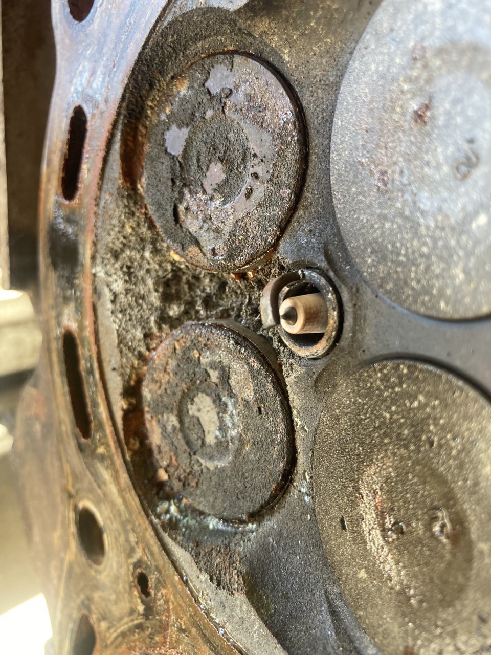

    Here’sa couple pics of the melt down block. Melted sensors and all. Yes the head got hot enough to melt the knock sensor base and the head temp sensor connector.. picture doesn’t show well but the piston is melted revealing the ring

    Hmmm… Maybe why sellers on FleBay are getting price’s for used running 2TR’s for almost as much as an new LS crate motors are selling for? The supercharger is going to be sweet but something about an LS1 w/ 350 plus HP w/ 350 plus ft lbs of Torque and 29 mpg on regular pump gas. Just keep them maintained and cool they will run almost as long as a Toyota motor.
    I hope so! I’m still waiting as the tuner didn’t like something he experienced while driving on the street. Last Dyno sheet I saw was run #74 :eek: :facepalm:
