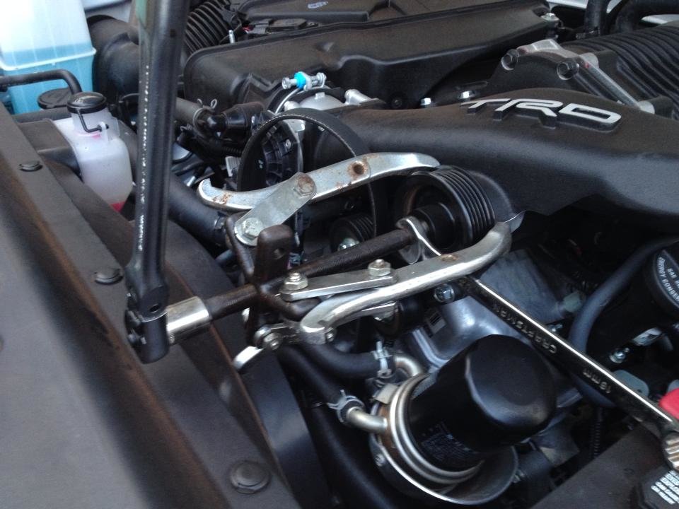

    You can use a 3 jaw puller from autozone. It will build up a lot of tension before it actually moves, then you can crank it off. It will pop.
    I had some issues putting the new one on ( twice on two trucks). Heat the pulley up in boiling water and cool the blower shaft with ice and move quick to get it back on.
    I broke the hardened stud on the press tool twice installing the pulley ( on two different trucks).
    Taking the pulley off was never a problem

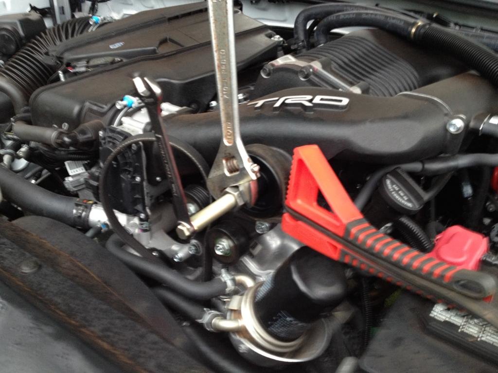

    I know the strap wrench is to keep the pulley straigh when installing.. But where do you position the strap wrench in order to keep the pulley straight.?

    Use a strap wrench to keep the pulley from turning when installing.
    Since it's a press fit be sure the motor is stone cold before installation. I heated the pulley with a blow drier before I installed it. Make sure to oil the supercharger shaft with motor oil and grease the bearing and threads of the URD installation tool.
    My boost went up 2 psi with noticeable power increases throughout the range. TRD reflash handles the pulley upgrade fine.
