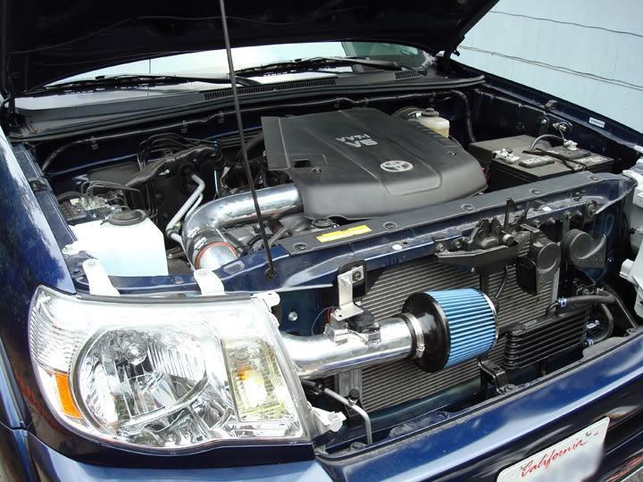

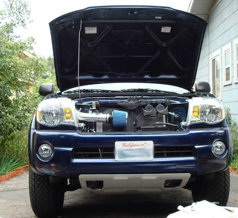

    I finally got some time to install my TCAI. Its been here for about 2 weeks, just sitting in the box. The install was relatively uneventful. I really diddnt like the idea of messing with the MAF wiring, but it went smooth as well. Funny how much crap you have to tear out of the engine compartment. Anyway, i have the stock pipes and no MAF calibrator as of yet (its on order), but the engine sounds awesome anyway. Well worth the $$.

    I also installed mine recently after it sat around for 2 weeks. I'm definitely noticing the performance gains. I scared some old guy this morning that was trying to cut me off! I also did not have any problems installing the thing except for the MAF wire extensions. I had never soldered wires before. I found the best way to do this...strip about .75" insulation off, cross the bare wires in the middle to form an X, then wrap the loose end of the wire around the other wire, hold the soldering iron under the wire and feed the solder through the top. You didn't forget to put the heat shrink on there, did you? I think that I should be pretty well set when I go to install the calibrator.

    I live in Los Angeles. I cant remember the last time it rained. Regardless, I washed my truck last sunday and sprayed the hose directly through the grill. The truck ran fine right after.
    The install was easy. Yeah I put the heat shrink on.

    Its really not that hard. It took me around 2 hrs at a relaxed pace. You basically rip out the old air intake, etc., detatch the MAF and extend the MAF wire harness, cut a hole in the front of the engine compartment and install the pipes.
