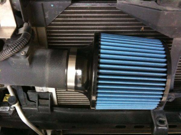

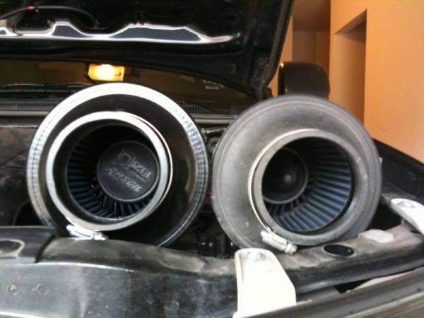

    I got my new filter today. Same design for the most part, but it looks better without the chrome ring at the end. The new one has the lip that Gadget was talking about. You can see the lip in this picture...
    The new one also has a different interior design - complete with logos that you will never get to show off without a picture like this. ;)
    You can see how far I had the old one on. The bad thing is I had no idea that it was on that far. As Gadget was stating earlier, this disrupts the air flow that this setup was designed to produce. No wonder my MAF was throwing codes!!! :frusty:
