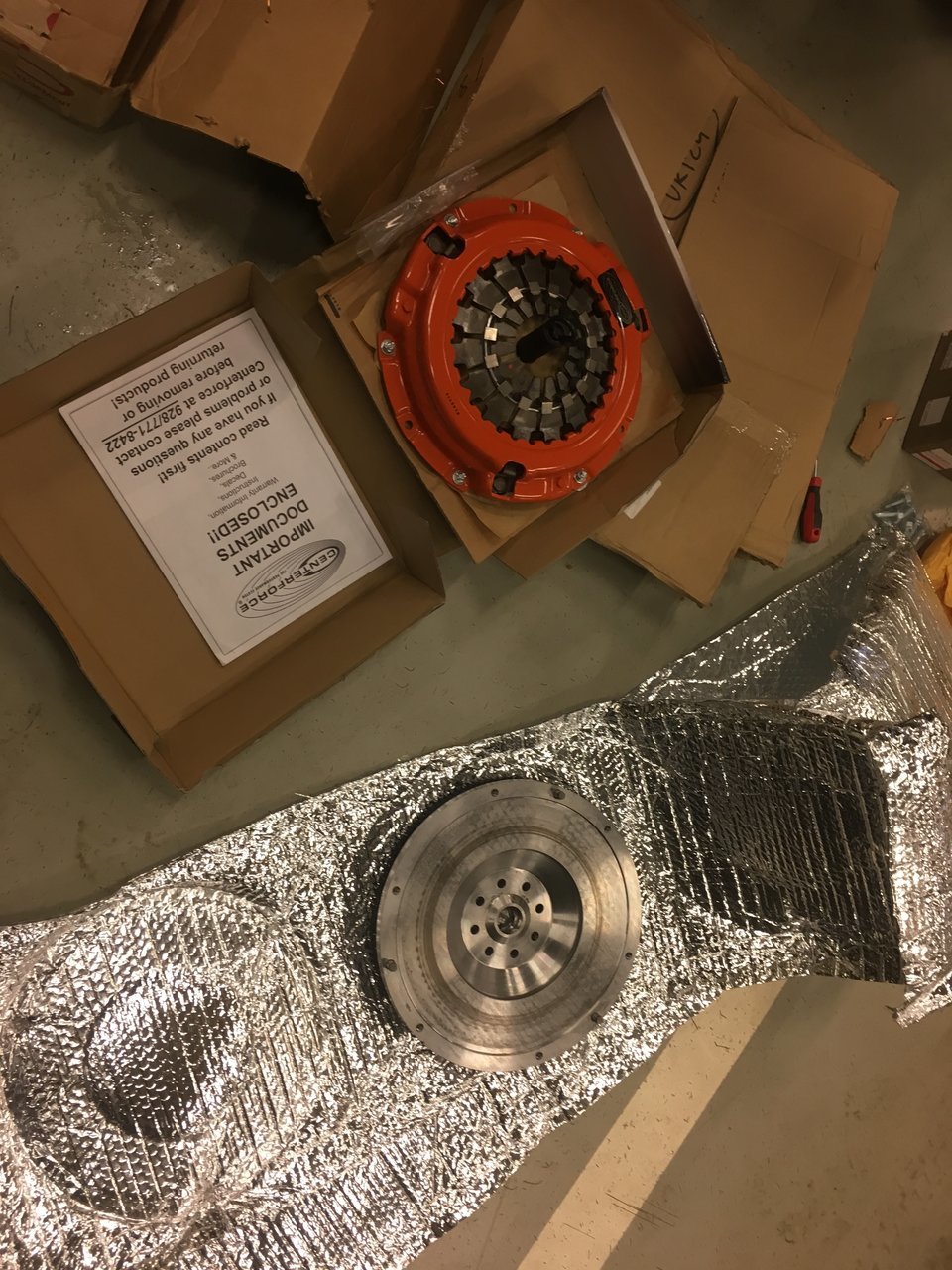

    Mine Torque-U is waiting for time to install along with URD’s quill sleeve/bearing and Centerforce Dual Friction clutch.
