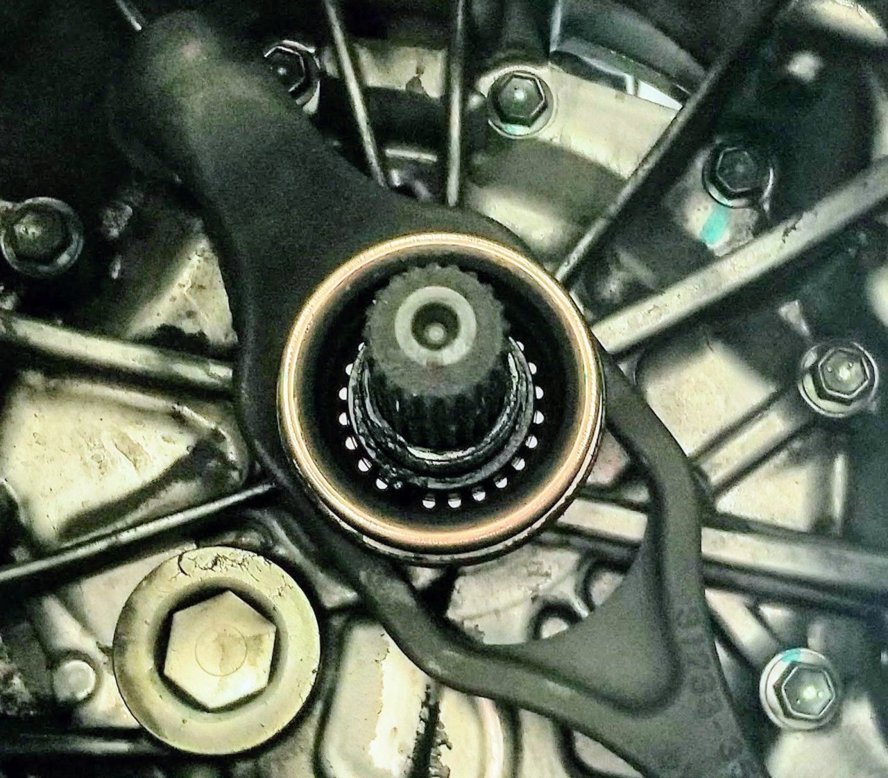

    An incredibly bad design as far as I am concerned .
    I understand that the transmission was beefed up to counter act the missing pilot bearing . After very carefull consideration , I think Toyota needs to do more to compensate for this switch .
    When you mash your clutch pedal to the floor , your clutch disc is supported by the input shaft . A rotating clutch disc thats spinning at 3000 rpm creates a lot of load even if it only weighs 4 pounds . In days gone by when you mashed your clutch pedal to the floor , The pilot bearing use to support the clutch disc . Now , when you mash your clutch pedal to the floor , you rely on the transmission input shaft to support the load of that spinning clutch disc
    In my opinion , its one of the reasons you cant keep a throwout bearing alive in the Tacoma .Not the top reason but 1 of the reasons .
    Considering very few has throwout bearing issues with the 5 speed manual which uses a pilot bearing , I may have a valid point . The 5 speed has a pilot bearing
    With the above mentioned , is there room to install a pilot bearing or is the input shaft too short to extend into the back of the crankshaft ? also , is there a snub on the input shaft that would except a pilot bearing ? sorry been a while since I did a clutch on the 6 speed manual.
    Somebody show me some side views of the input shaft please

    I need a couple side view pictures to determine if this MOD will work . I am fairly certain that the snub on the input shaft on the 6 speed doesnt extend into the rear of the crankshaft . If it did , I would very much consider a pilot bearing upgrade.

    This is the best I have

    Thankx .
    No snub on the input shaft .
    With that said , an upgraded input shaft with a snub on the end to accomodate a pilot bearing would be one of my fixes .Its going to save the clutch disc from whipping the input shaft and throw out bearing quill to hell .
    Judging by the picture you posted , The input shaft is already off center .
    If you add a pilot bearing to the input shaft to keep that junk straight , there is no reason why an aluminum quill or throw out bearing will go to crap in 4 years.
    The factory input shaft goes almost to the rear of the transmission . This would be a costly fix . You dont hear 5 speed guys bitching about faulty clutch release bearings .The 5 speed guys have a pilot bearing to support the load of the spinning clutch when you push the pedal to the floor
    Hope you see where I am coming from .

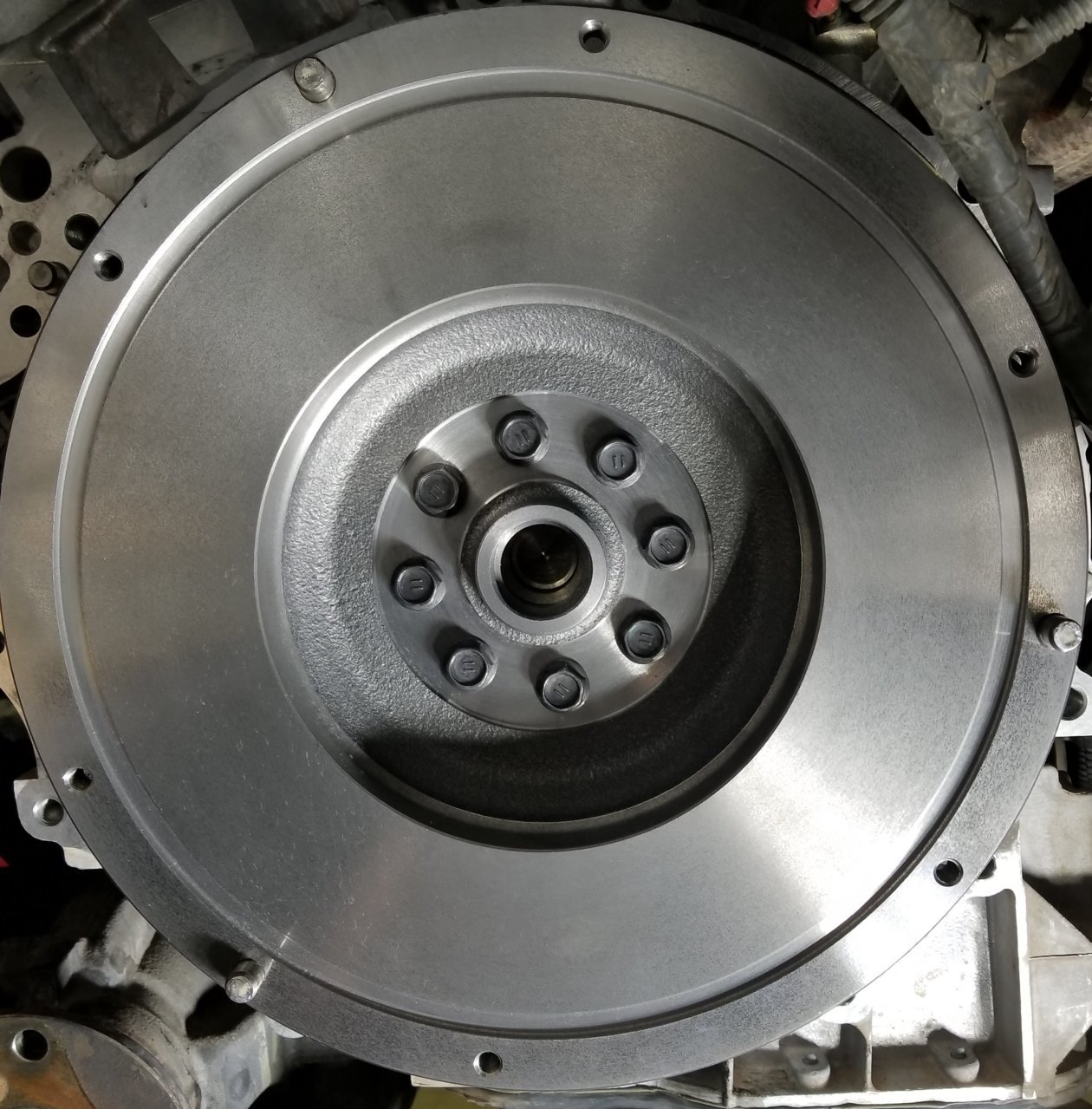

    Thanks for the crank picture . Lots of room there for a pilot bearing :thumbsup:

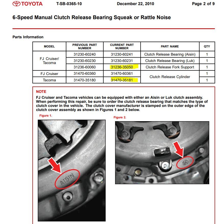

    I just called Toyota to get a price on their TOB replacement out of curiosity because my squeak is driving me nuts on my ‘06. Parts are about $130 and labor could be anywhere from $500-$650. Only problem is they only warranty the parts/labor for one year. Idk what to do.
  19. Dec 15, 2020 at 12:10 PM
    #79
    gearcruncher
    gearcruncher Well-Known Member
    Nov 1, 2012
    #90305
    7,173
    Canadain bumper technician
    Great white North 51.0333° N, 93.8333° W
    2010.TRD.SportDCLB4x4Limited leather package
    TRD Sport Rally -5 speed automatic Limited ,Factory heated leather seats ,chrome package,Super white with front windows tinted to 35 % Dick Cepek DC-2 wheels Summer tires - Good year silent armor P265/65R17 Winter tires - Good year P265/65R17 Ultra Ice studded Illuminated 4x4 switch TRD 3rd brake light cover ($20) TRD seat belt shoulder protectors (5). ($50) TRD ...B pillar emblems ($20) TRD rear slider sticker with devil horns ( $6) TRD summer floor matts ($60) TRD steering wheel emblem ($20) TRD floor pedals .($95) TRD shorty antenna ($14) TRD front Windshield emblems ($17) TRD head pillows .($60) TRD head rest protectors TRD door scuff protection $20 TRD floor matt emblems ($40) TRD tow plug emblem . ($40) TRD cigarette lighter with LED.($35) TRD tissue dispenser ($12) TRD front bezel emblems ($9) TRD door emblems ($6) TRD lanyards($9) TRD lisence plates with TRD bolts($50) TRD fender emblems TRD center caps Part Number:PT904-35070-CC ($80) TRD cd
    Do you remember if all the updated parts were installed ? Just had a young lady PM me the other day . The shop that installed her clutch didnt do the upgrades . Needless to say , they sent her away with a new clutch and a squealing bearing .
    New slave , new steel master , new clutch fork ball ?
    Trying to figure out if all the upgraded parts actually helped with the issue ?
