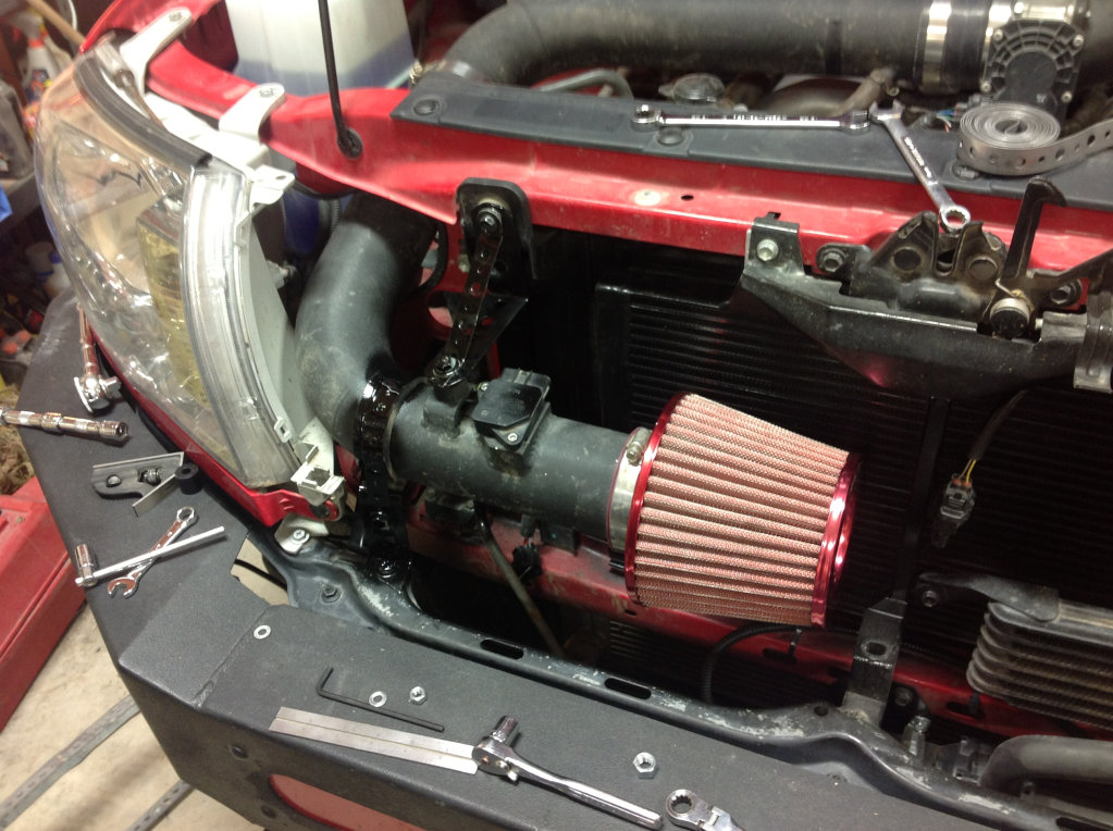

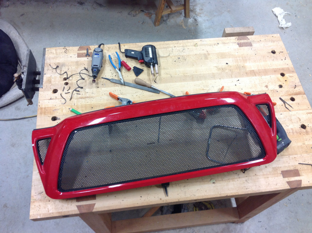

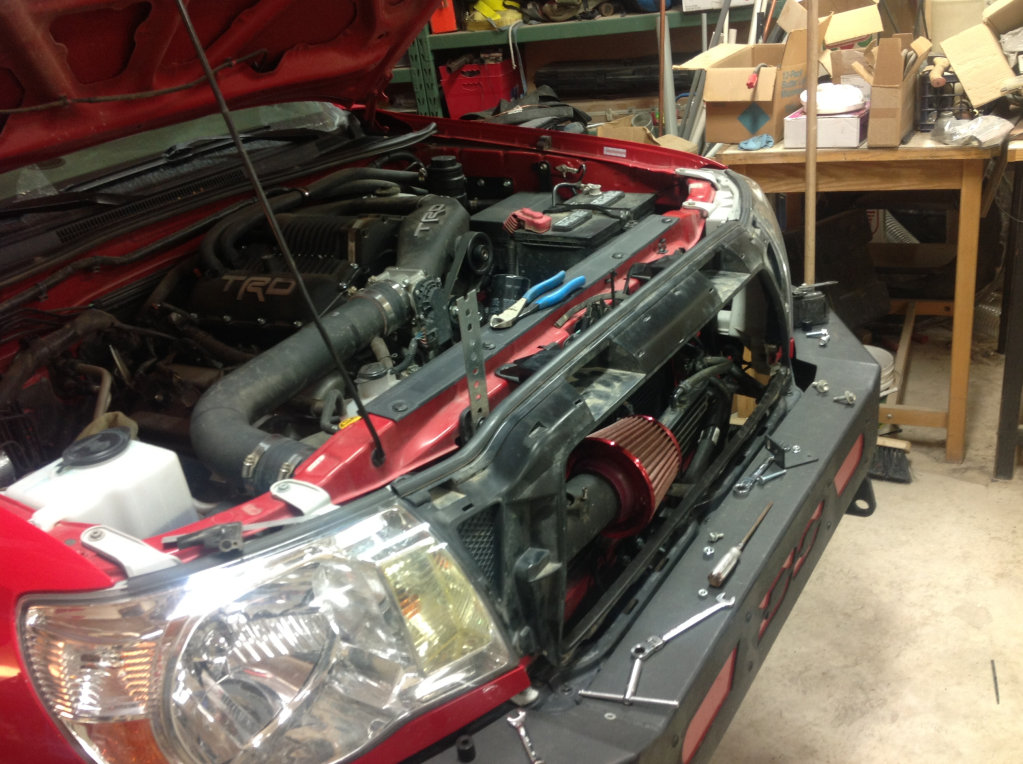

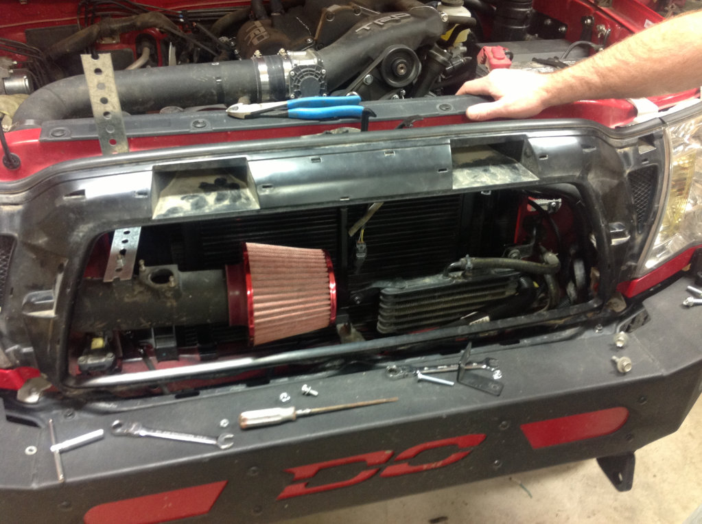

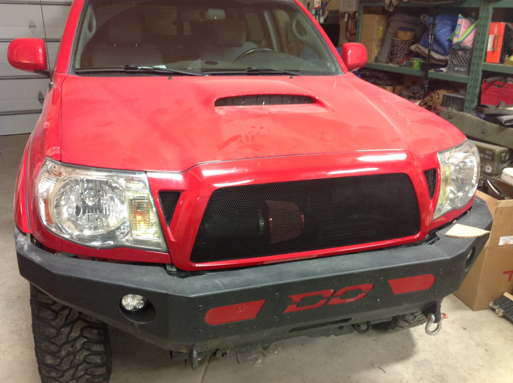

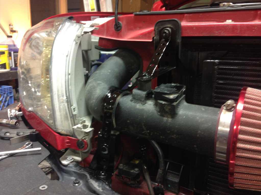

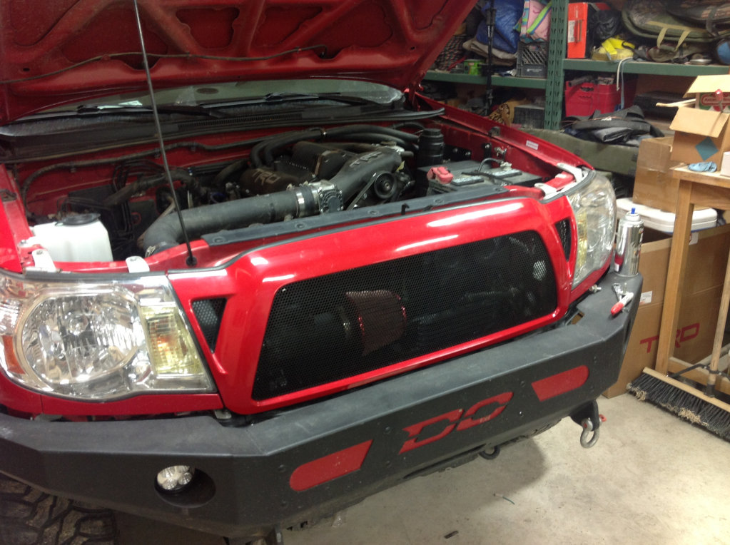

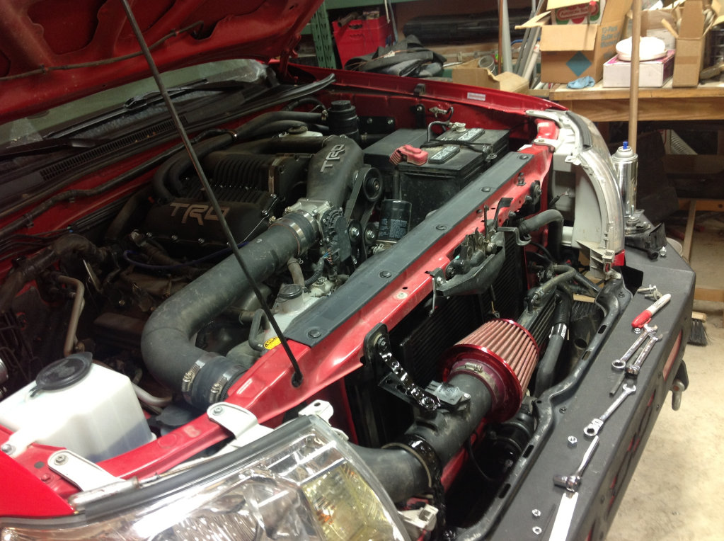

    Works!! but you have to have a Satoshi grill. Made custom brackets for the pipe too. Had to cut 1.5'' off the TB end of the pipe too. We also ordered a custom AFE pro dry S filter that is 3'' inlet dia.x 5 B dia x 4.5 T dia x 6 L i believe. This will allow us to run the shield again. As of right now it wont fit because it its the filter when its tucked up.
    But here is the pics. Sounds bad ass now too :D
    mock up
    9d210e63b7165f47987bfcea1976d544_da8f1f4afac3319ec967864a3fe0dd7ca063ef11.jpg\
    grill
    done

    Nice looks badass

    sounds bad ass too. Running the URD stealth pulley too :D
    can't believe URD doesn't just sell a slightly modified version of the CAI for the supercharger..was pretty simple to make it work..
    granted the satoshi grill is a must..

    satashi b/c of clearance issues i take it... so no recessed grills? man, that is a sweet setup though, how did the s/c run, as expected or better?

    But yes need satoshi for clearance. Even if you don't have SC and stock girl you have to trim the grill a bit anyways. But because the sc pushes the filter. Tad bit out more the satoshi flush mount is a must.
