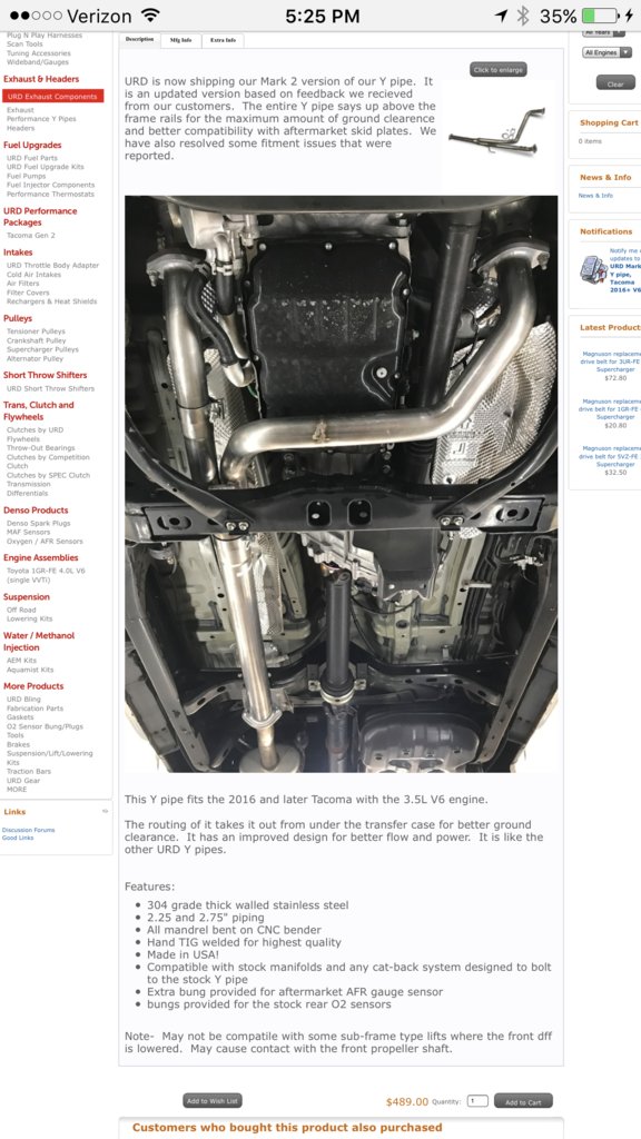

    URD updated there page on the ypipe if anyone cared. Mine came in yesterday afternoon :bananadance:

    Was the picture on the site a pretty accurate representation of how yours looks installed? Do you have an auto? Any issues with the rear 02s hitting the trans lines?
  8. Jul 25, 2017 at 2:57 AM
    #88
    oscolivar1
    oscolivar1 Well-Known Member
    Oct 30, 2013
    #115568
    2,267
    Oliver
    VA
    2017 Tacoma Limited
    Bilstein 8112/8100, JBA UCAs, Icon RXT leaf pack, work wheels 17x8.5;-10os, 285/75/17 cooper LTX AT3, Mobtown HC rear bumper and Sliders, SSO front bumper, BAMF greceased grill.
    Yea I have an auto and it was pretty accurate picture minus the 2 exhaust clamps that I'm pretty sure that was suppose to be included. I'd email or call him before purchasing. You need a 2.5"clamp and a 3"in clamp if you need to buy some. No issues with my o2 sensors.

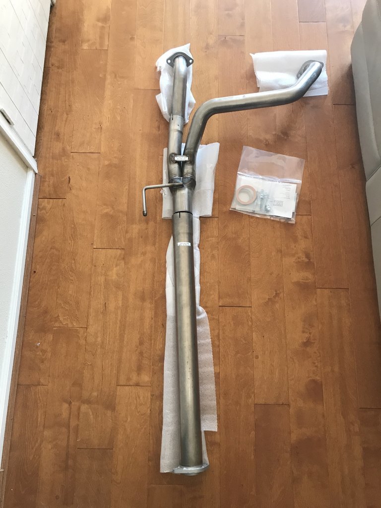

  13. Sep 4, 2017 at 3:42 PM
    #93
    hirod
    hirod Well-Known Member
    Jun 3, 2013
    #105540
    1,245
    hawaii
    16 double cab short bed OR
    it worked out for good in the end. i couldn't install that week/weekend anyway. plus with the cost of shipping, it was less of a loss for urd to let me buy the 2nd gen one for cheap than to ship it back. tacomas are the state truck here so finding someone who wanted it was no problem.

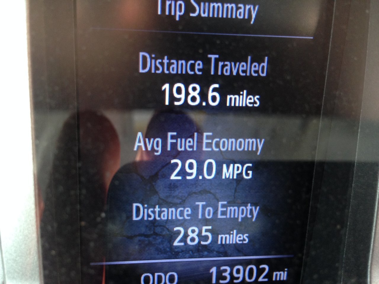

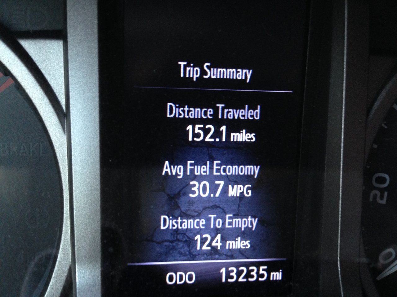

  17. Sep 5, 2017 at 6:26 AM
    #97
    skyking3
    skyking3 Well-Known Member
    Feb 3, 2016
    #176974
    475
    Tom
    2016 Silver Tacoma SR5 DCSB
    TRD cai, TRD cat back, JFR y pipe,Wilwood BBK,LEDs, Limited Homelink mirror,debadged,WeatherTechs,Dynamat Extreme sound deadening,sabm second snorkle to fender, Huper Optik ceramic tint, TRD Sema wheels, aerodynamic under body pan, OEM Audio Plus 500Q reference system, Depo faux pro headlights, real pro fog lights, OV tune, OEM aluminum filter housing, Mobtown IFS skid,TRD oil cap,TRD radiator cap, Osram Night Breaker 150 halogen headlamps, Fumoto valve,dashboard blackout,OEM tailgate power lock, MESO steering wheel logo, MESO two color dome light, TRD Pro coilovers, Artec LCA skids, Volk TE37 XT forged wheels, Roadmaster Active Suspension Garmin Minicam, Garmin minicam II
    The y-pipe along with some of the other mods I have made has increased the MPG on my truck. On a trip from Florida through Canada and back a few months ago I went almost 4000 miles and checked the gas mileage on each fill up. My worst was 24.7 MPG going through the mountains and my best was a 477 mile leg which only took 16.1 US gallons to fill up. You may do the math.IMG_0342.jpg IMG_0371.jpg

  19. Sep 5, 2017 at 7:41 AM
    #99
    JoeCOVA
    JoeCOVA Well-Known Member
    Nov 15, 2016
    #202463
    9,657
    Joe
    Colorado Springs
    Ford F350, Lexus RX450h, FZJ80, Jeep YJ, Jeep LJ
    Based on the information within those pics, they basically contradict eachother. So looks like BS to me. It's very easy to trick the onboard computer.
    I don't think there is a single person who can honestly say they regularly break 400 miles per tank. To claim 477 and beyond is almost troll worthy. Gas gauge is conveniently not shown.
  20. Sep 5, 2017 at 9:16 AM
    #100
    skyking3
    Feb 3, 2016
    #176974
    475
    Tom
    Actually, they do not contradict each other since I did not get gas before the first picture restarted the trip mileage. The trip mileage on the top starts afresh every time the engine is stopped and restarted. I based my mileage totally off my hand calculations of total miles traveled with the gas it took to fill it up using the trip A and B mileage readings with the push button reset. You are welcome to come and visit me in Florida anytime you would like to have a demonstration since I am retired and have plenty of time on my hands. I was a scientist and engineer so I can understand your scepticism.
