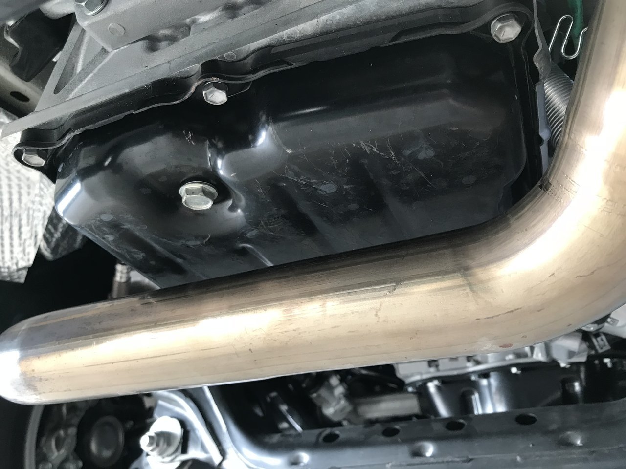

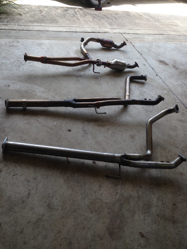

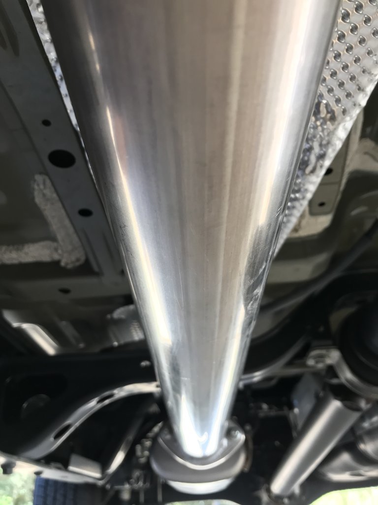

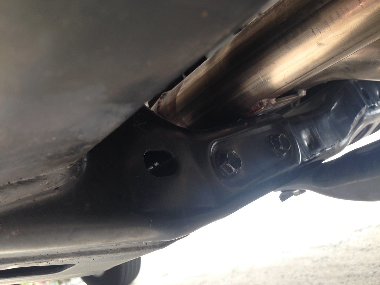

    The Mk 1 and the Mk 2 are both for the 3rd gen as I have had both versions on my truck. The Mk 2 was made to remove the rubbing that many were experiencing and provide better clearance for skid plates. The first picture shows the factory y-pipe compared to the Mk 1 and Mk 2 versions. The second picture shows the lack of clearance I had at first with the Mk 2 version. Gadget was great in helping me with the fix. The y section of the y-pipe had to be pulled back about a half inch on the passenger side and the long straight pipe had to be rotated 180 degrees since the flange has a slight angle and only works properly one way. Gadget said the future y-pipes will have an arrow showing proper orientation. It is so nice not having any rubbing anymore.
    The last picture shows the y-pipe coming within an inch of the transmission which gives me some concern with overheating of the transmission fluid. If there ever is a problem with the tranny in the future then Toyota may not warranty it because of the URD y-pipe. I ordered a roll of titanium heat wrap insulation from Amazon but returned it after reading the follwowing link.
    https://www.centuryperformance.com/exhaust-header-heat-wraps-do-not-use.html
    Is there anyone with any experience with exhaust heat wraps or heat shields? Thanks

    To give you a little peace of mind I would suggest wrapping it in header wrap still... it eliminates exhaust/headers from outpouring the heat source and absorb some of the heat... I've done it with almost every car I've modified and would suggest that as the best fix for now... that article you provided looks more like poorly made headers and possible moisture build up causing the rusting... I would take the wrap off every year or so and re wrap... all in all as long as you maintain your parts verses setting and forgetting they'll last a lot longer and allows you to do spot checks along the way
