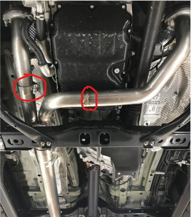

    In the course of trying to investigate, I've noticed when the car is warming up it drips water from the joints downstream of the secondary O2 sensors (see where I've circled in the stock URD photo below). I've also attached some actual photos of the joints and another showing the puddle on the ground (looks like the puddle that forms from the air conditioning condensate).
    One of the possible causes of a PO157 is an exhaust leak, which could cause air to get in and have the O2 sensor sense a lean condition (the sensor sends a 0 to 1 volt signal, close to 1 is rich and close to 0 is lean, hence the low voltage alarm). I strongly suspect that's the issue since the truck only has 17k miles on it and I doubt the O2 sensor is bad. Has anyone had any leaking issues with their URD Mark 2 Y pipe? The joints in question don't come with a gasket; one pipe slips inside the other and then you tighten down a clamp around the joint (a glorified hose clamp setup). Also wondering what is causing the water to form and drip out. I don't see or feel any exhaust air coming out of the the joints, and I've tried cranking down on the clamps.

    One of the exhaust components of *perfect* hydrocarbon combustion is water (H2O). Most exhaust systems drip some water until the entire exhaust system has warmed up. This is normal. This is why frequent short trips will do a number on ordinary exhaust systems.
    The fault O2 reading may be the result of a leak where the exhaust pipe connects to the manifold (upstream of the circled spots on URD pic). Had this issue with my '06 4.0 V6.
