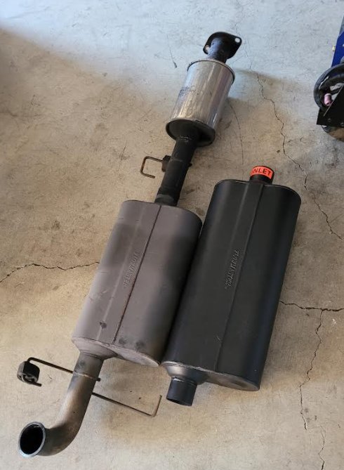

    OEM FJ TRIBUTE EDITION (REPLICA)

    Finally warm enough to do some projects in the garage. :annoyed:
    I chopped the 50 and put in a 70. I still have the Vibrant resonator on there as well. The sound/tone is similar to the 50 but it's probably 10% quieter.
    I think it's safe to say if you want to do a Y pipe and have headers get the 70. If you have at least one set of cats the 50 would be enough.

    Was there plenty of room for that 70?
  15. Jan 27, 2022 at 7:31 PM
    #35
    PhoS
    PhoS Proffauxssional
    Apr 8, 2020
    #324146
    1,213
    PNW
    08 FJ Cruiser
    Contains MSG
    Yea no problem. It's same diameter just longer.

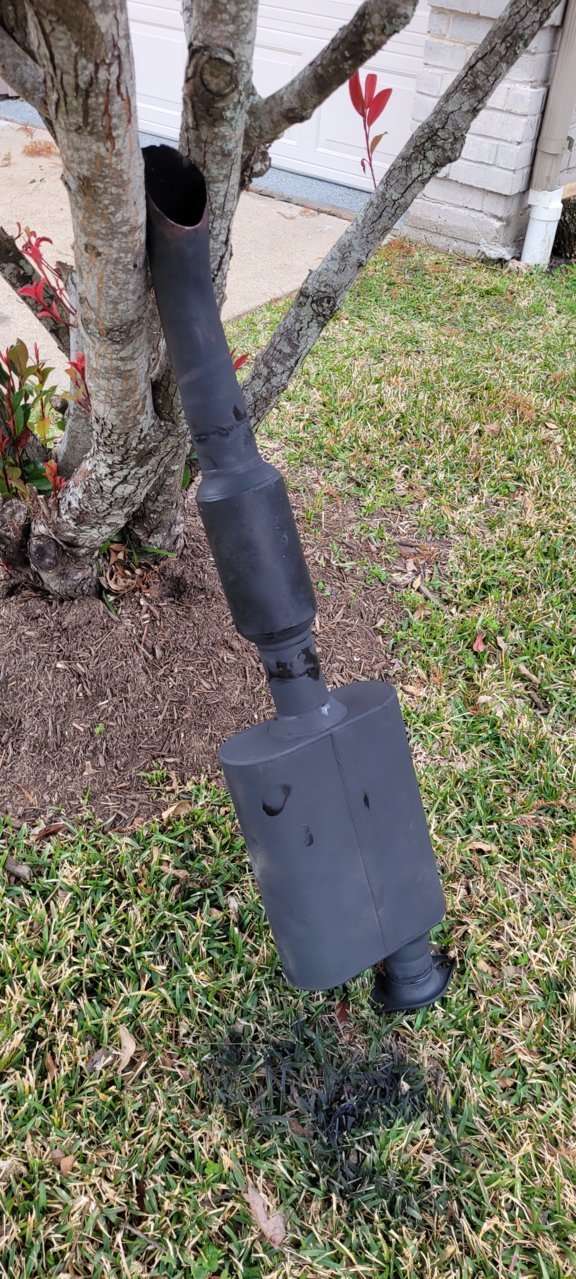

    This was my solution after installing the spec u headers. I had an additional 18" cherry bomb before but it was a tad too quiet. The high rpm rasp and highway drone is still present but very subdued vs a straight piped axle dump.
    Thrush turbo muffler and a short resonator from Amazon
