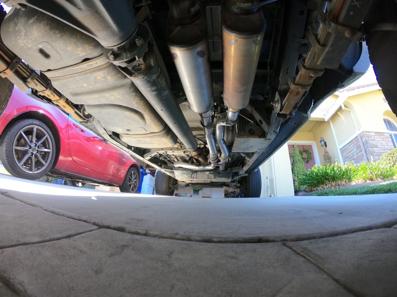

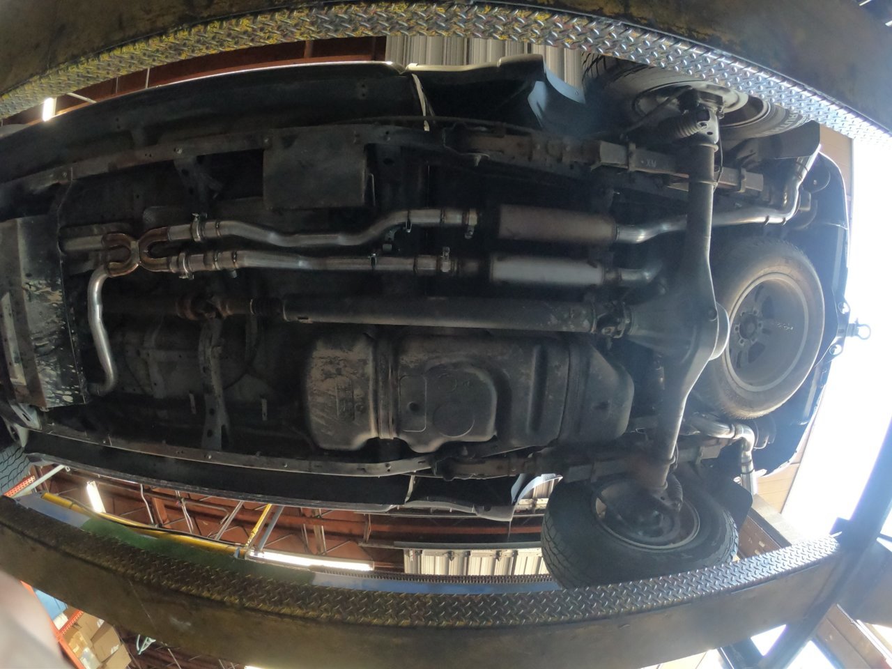

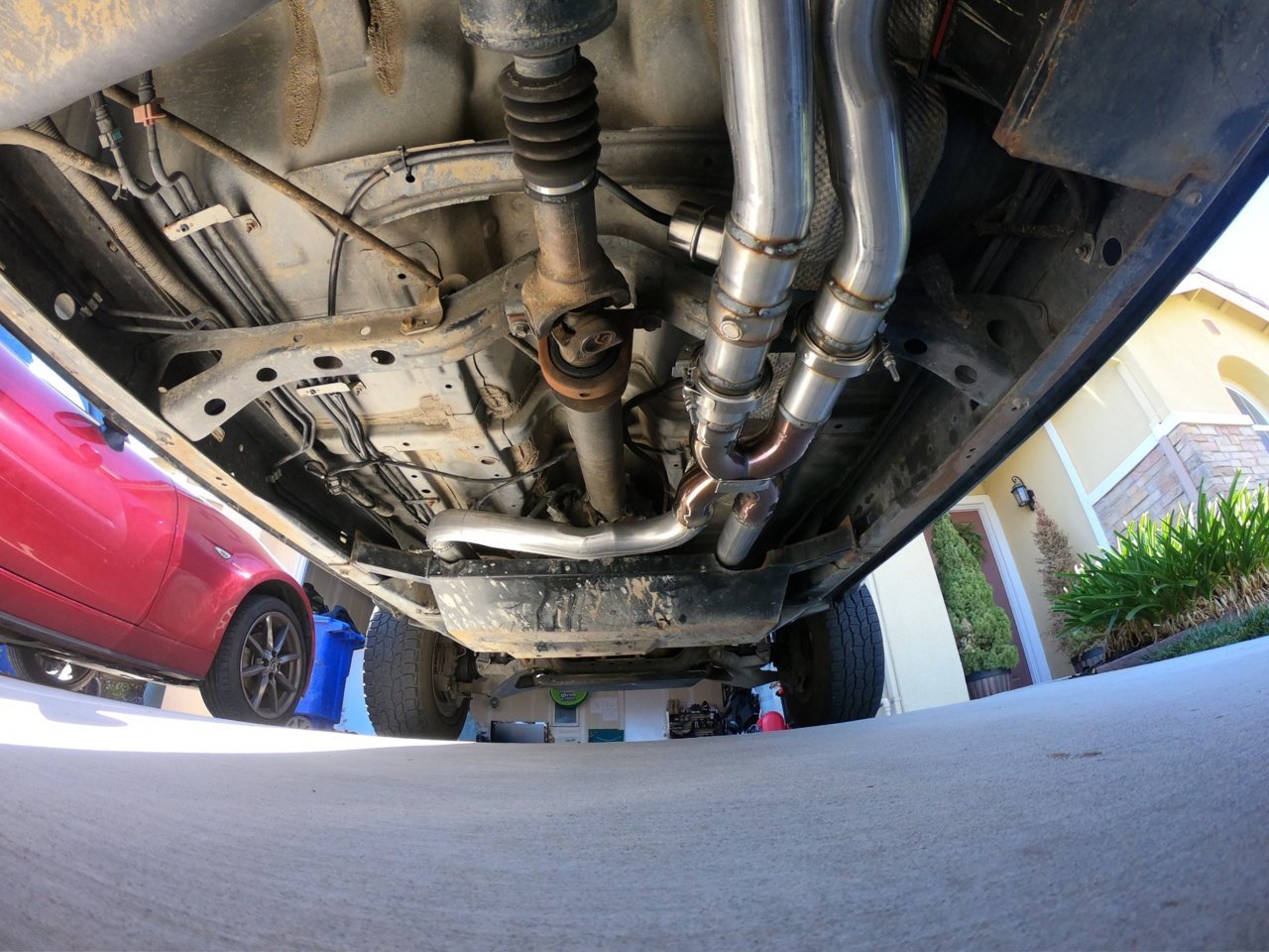

    It seriously is a custom one off piece made by a local exhaust shop in my area. It starts as 2.5" duals at the main cats like OE except OE is 2" and then turns into a 2.5" X pipe, but defaults as a Y until I give it some juice. There is a boost activated cutout on the driver's side portion of the X pipe as soon as it exits to the pipe. Then they both finish off onto two Black Widow Venom 250 mufflers.

    Just edited my previous post for photos.

    :ohsnap:
    Wow, that's really something.

    Hahaha. Left speechless?
    Me too. Lol. Everytime I roll down the back windows now. Underpasses and tunnels have become my new favorite places to give the truck some beans.
    No drone either. ;)

    Been checking out your setup a lot lately and strongly considering doing this, minus the cutout though.

    One day I may ditch the cutout entirely, but it is fun to activate and adds a layer of an aggressiveness in sound when open that without it would otherwise not be there. I agree though it adds an extra complexity to the system.
