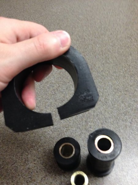

    I used these

    if you find that the vertical bushing sleeve that is provided are either too big or too small, there is another option for you. You can burn the rubber off the oem bushing and then insert that sleeve into the bushing and it will fit like OEM.
