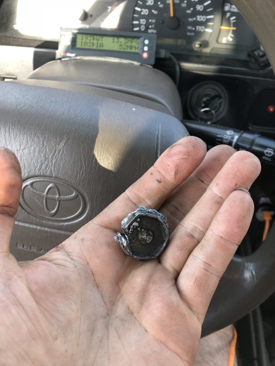

    This is the fill bolt right? Because a gallon just shot out over the fill bolt line. Looks like they used the fill bolt up top, the one I asked about eariler., then they filled the whole case.

    Can someone please confrim that the messed up bolt was the fill bolt? Thats the fill line right?

    Wulf
    Wulf no brain just damage
    Jan 30, 2015
    #147523
    61,481
    rock raisin
    The one under the rear driveshaft output is the standard fill port, yes

    #49
    billybop90
    billybop90 Well-Known Member
    Jun 5, 2019
    #295522
    303
    Bill
    Black Hills SD
    1996 Taco, 2.7, 4WD, 5 spd
    Part # 36114B
    Plug for rear Axle housing filler. It is the fill bolt and fill line will be level to the bottom of the bolt hole. You are 100%.
