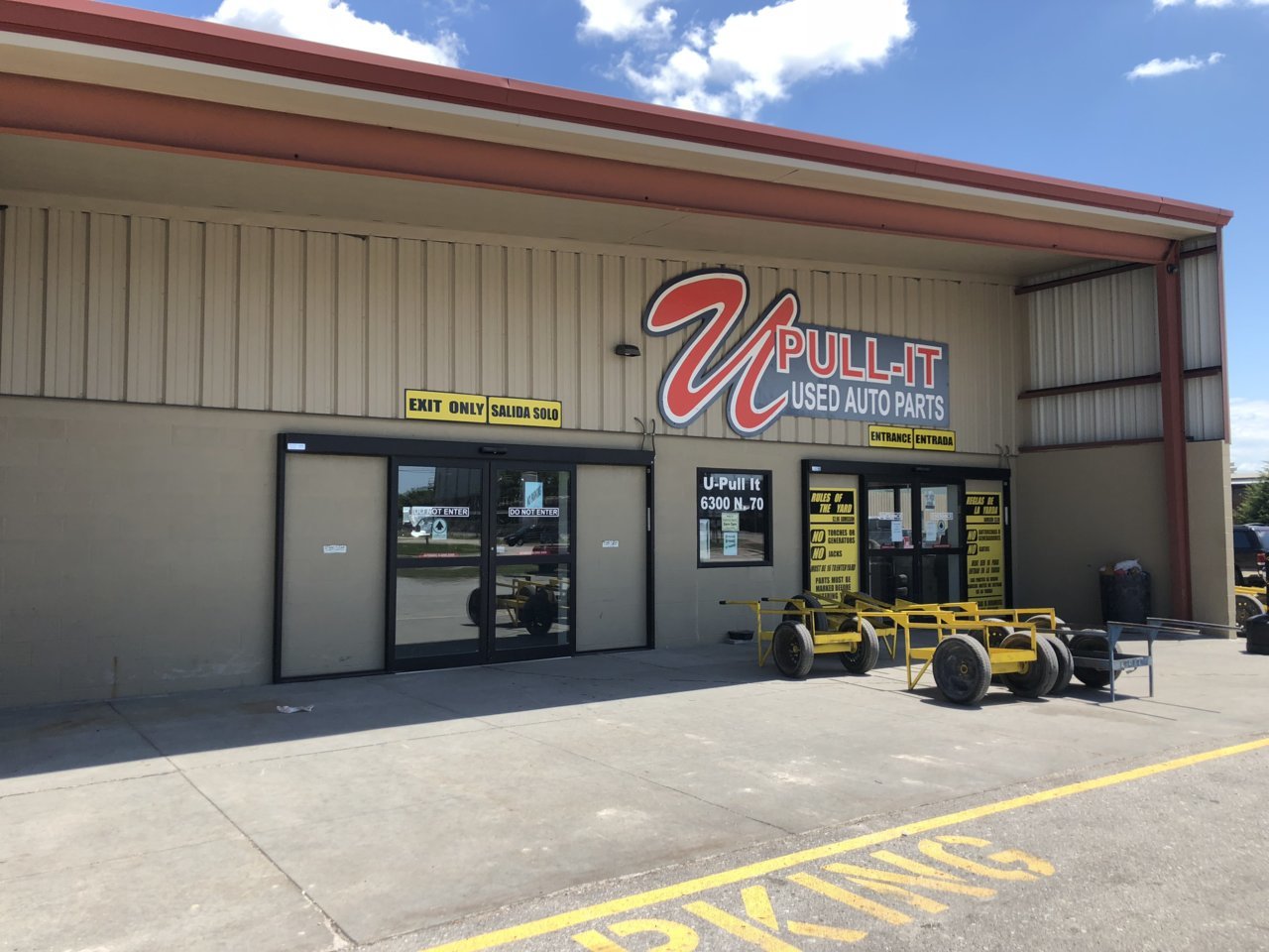

    Anyone know of any junk yards where you can pull your own parts off 80? I found an aweome one by accident but it was closed today.

    there is one yard in Lincoln, they have just 1 1st gen currently, i have not been there to look this month since it hit the lot
    https://www.upullitne.com/search-inventory/
    a '98 black, i wish they would post pics at that place

    Dude, youre fuckin aweome. 40 miles away. Im stopping there!

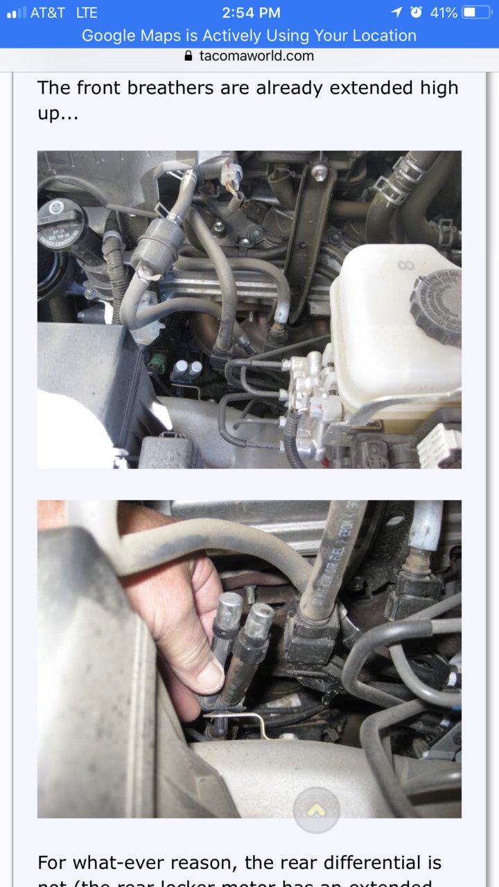

    Also Im noticing when I do short runs at 85mph i smell gear oil. I wonder if the vent is plugged and the pressure from high speed is forcing it out.

    Cant find the vent even looked in the junk yard where the engine was pulled and didnt see it.

    Found a post about it

    Stopping at all upullit.

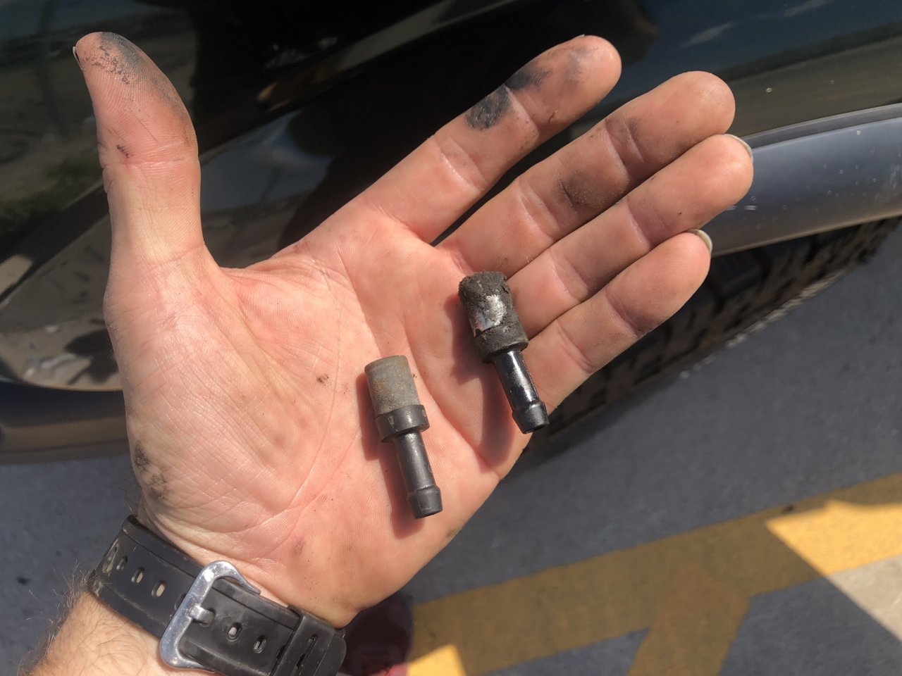

    Just got the breather at the 2nd yard and i can blow through it. Mine was fully caked couldnt blow though it. I knew was leaking more due to elevation.
