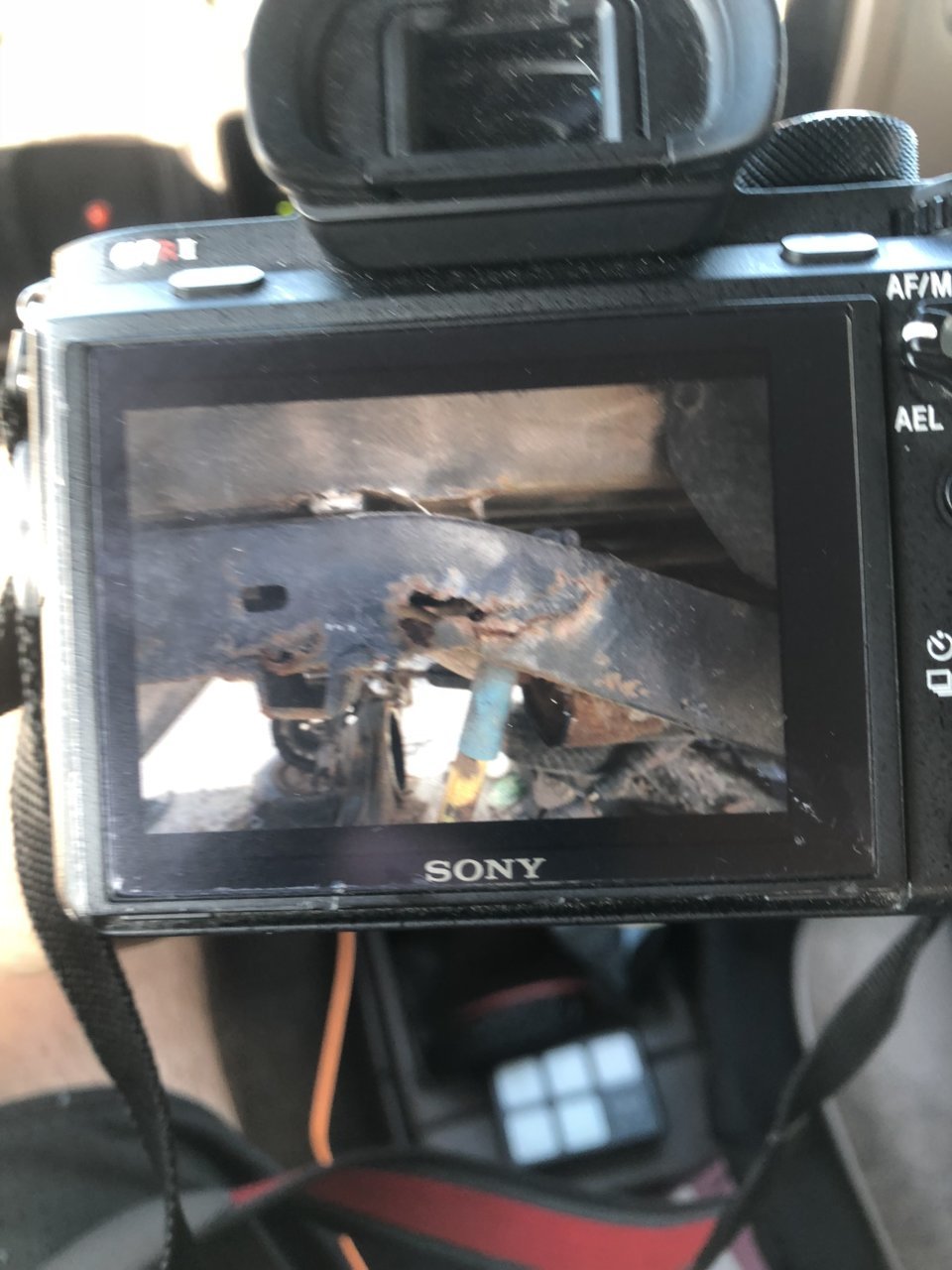

    1999 Tacoma SR5 TRD 5 Speed
    Map Lights, Grey Wire Mod,
    Might as well be made of tissue paper in a rain storm. Shit was gone.
