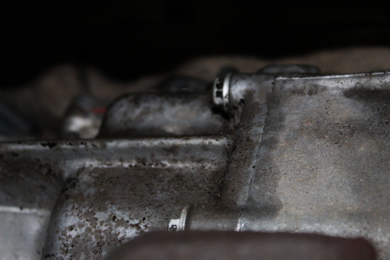

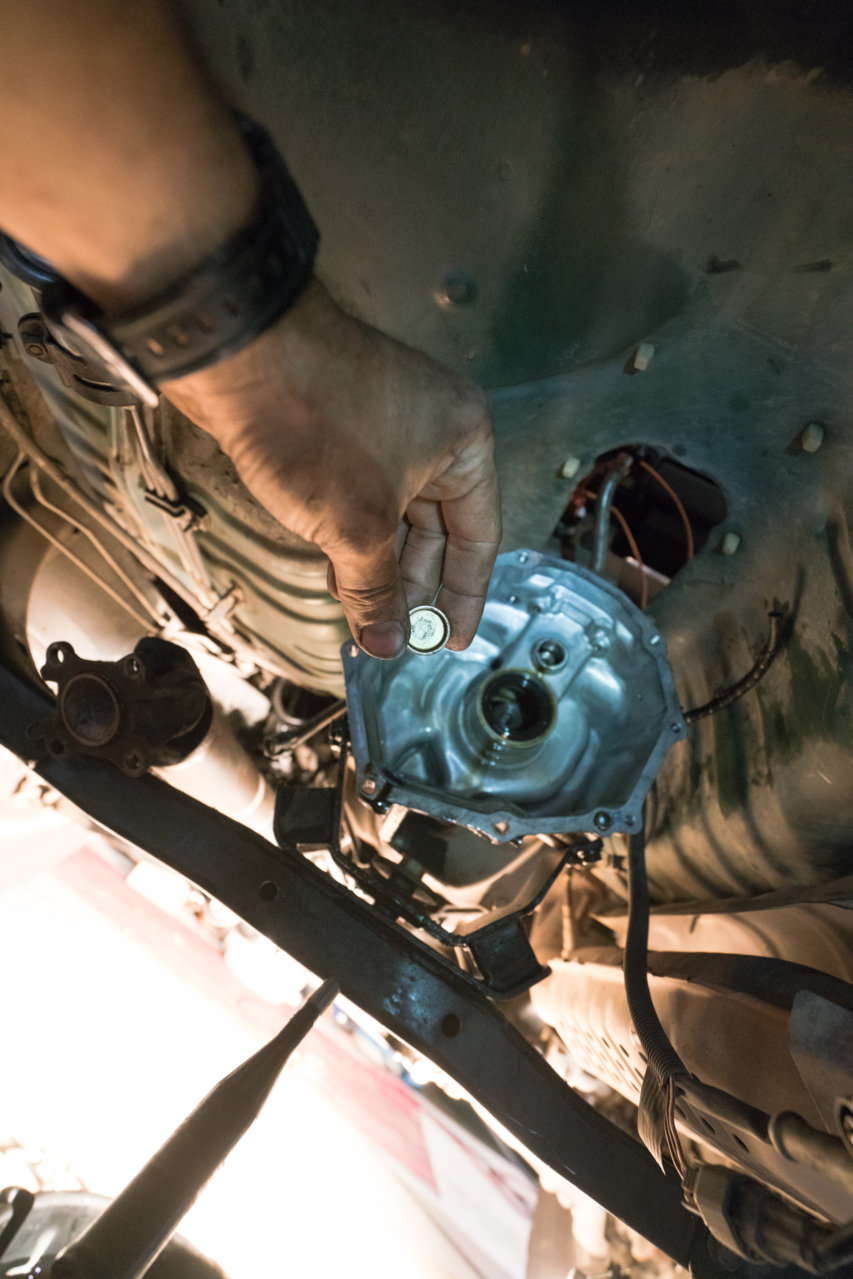

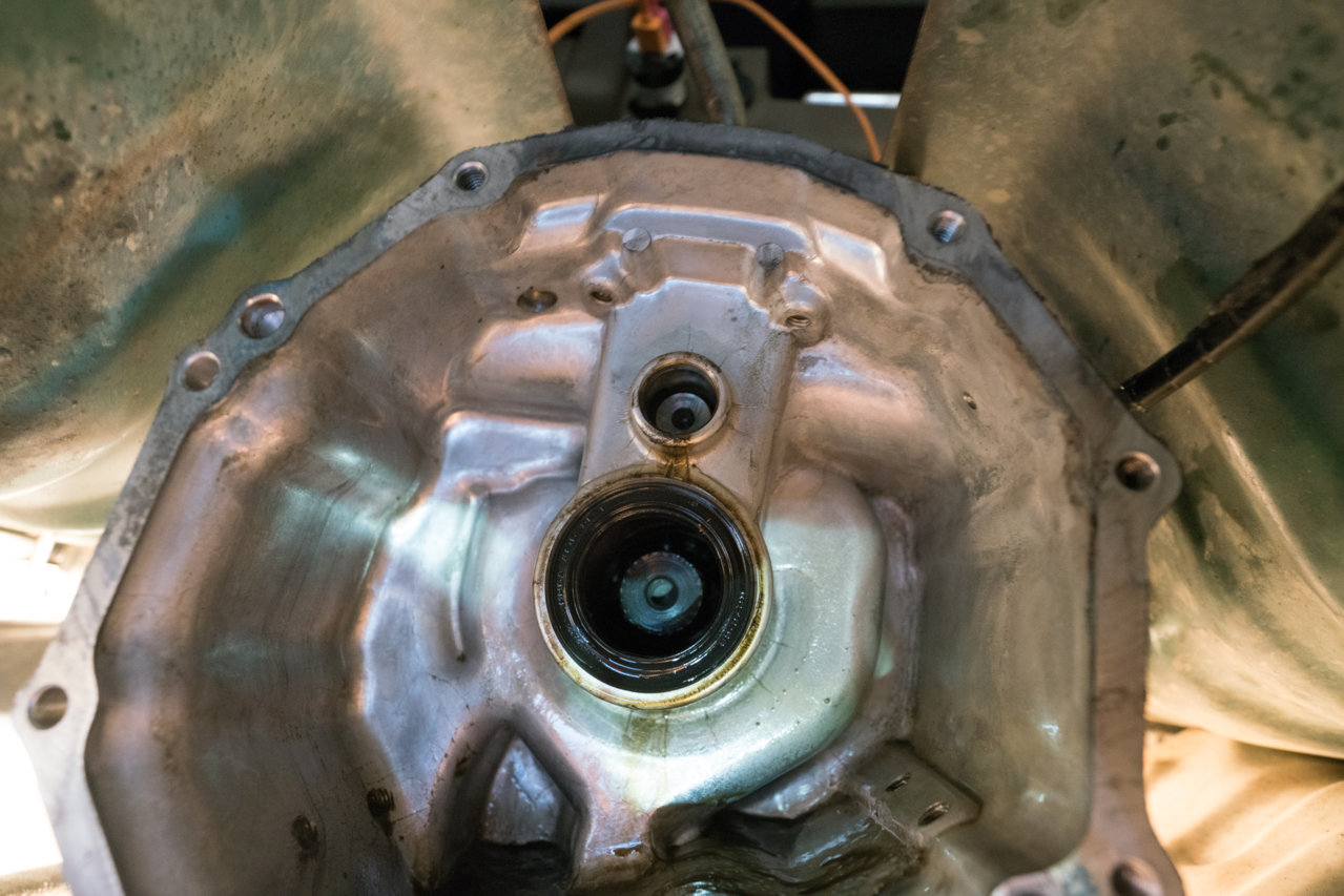

    Just to follow up on this..
    I went to fix the leak from the transmission.
    I pulled the transfer case today and a plug just fell out. No idea how it would of come out. But you can see by the dark marks it was leaking from there.
    I decided not to replace the bushing even though I had a new one. Im gambling that it was okay. I put some lock tite stuff on the the plug and pounded it back in with a socket.
    Also when I pulled the t case the whole cavity between the case and the trans was full of oil.
    I also checked the breather and the breather line between the t case and trans with compressed air.
    GQ7227, xxTacocaTxx and nagorb like this.
