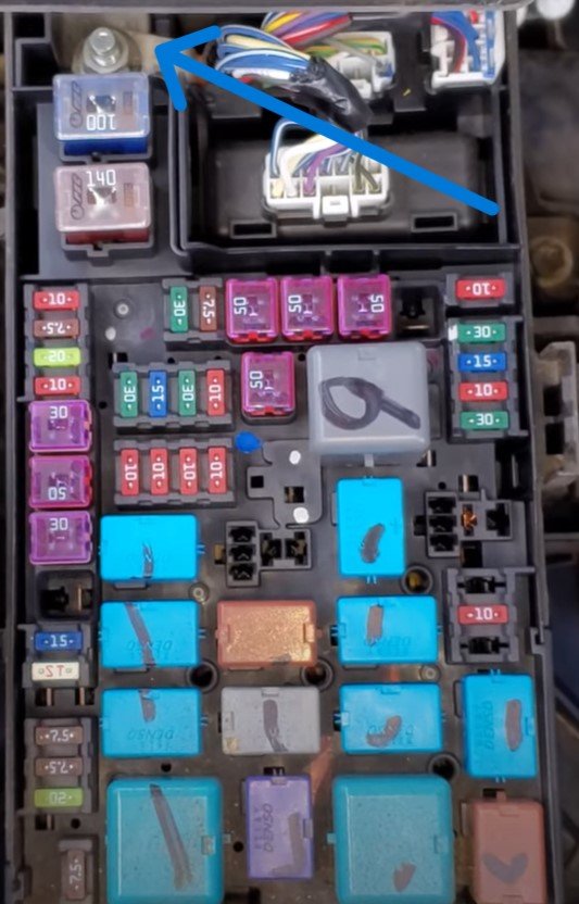

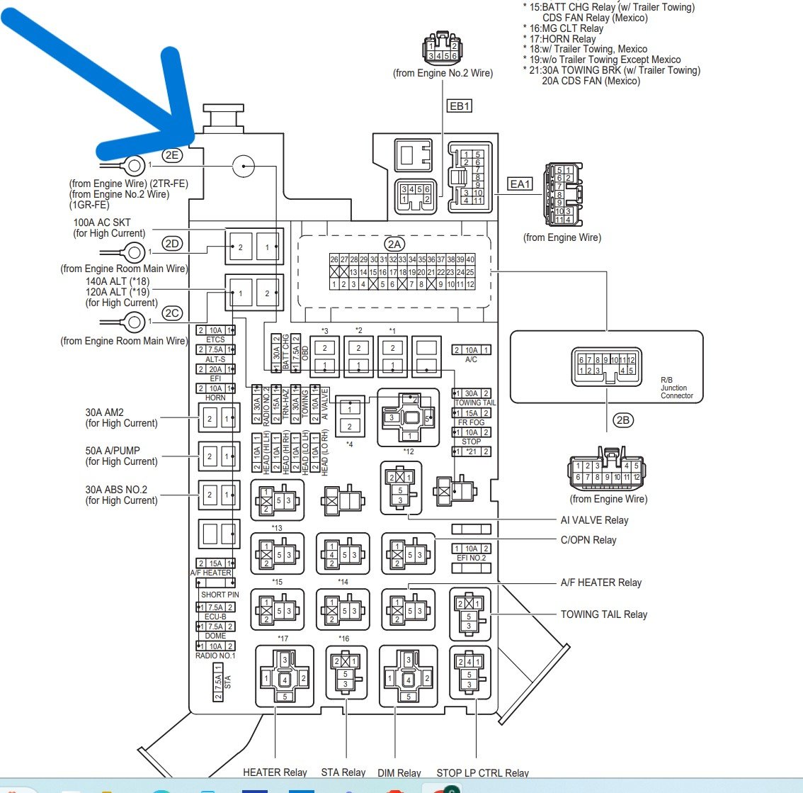

    check the wire and nut in the engine fuse box for power.

    Check this wire for power
