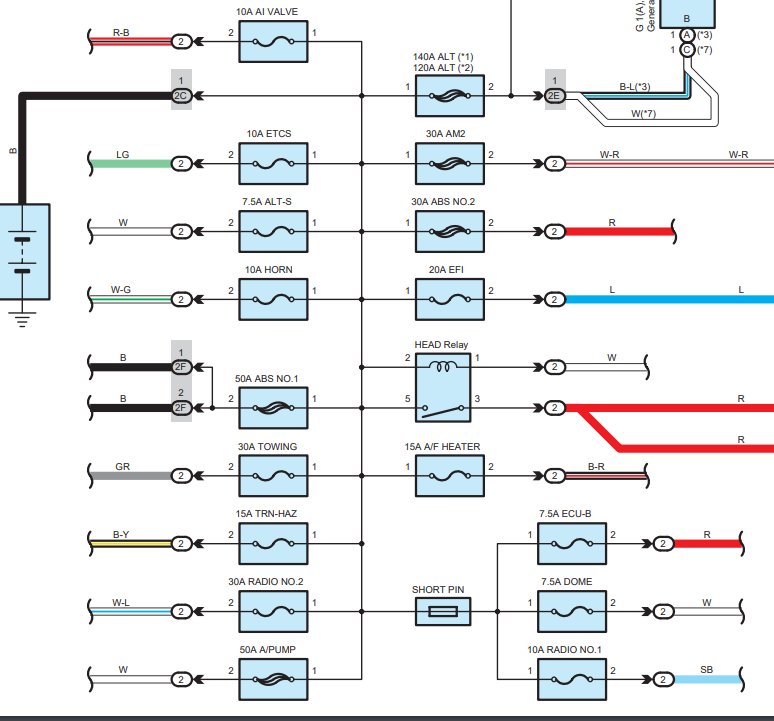

    Checking any of the below fuses for power would work too.

    OK, I am dying to know if he has power to the main post in the CB panel....should take a volt meter and about 20 seconds....

    I'd like to know if the fuse box main power terminal has 12v as previous member did mention with the blue arrow
