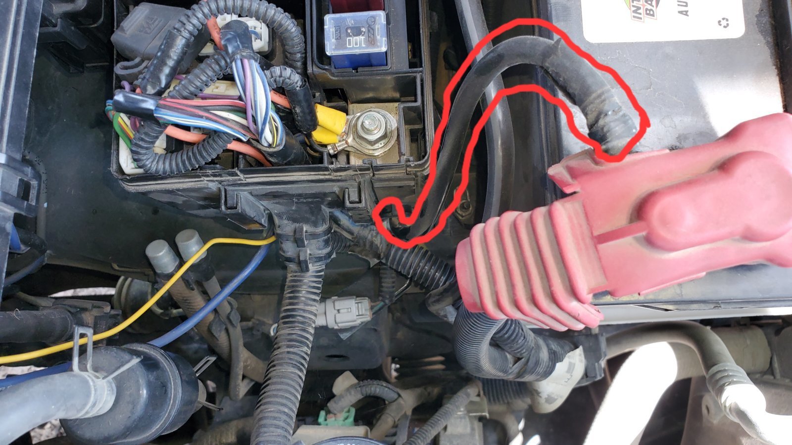

    That's likely the issue.
    As there are typically 2 feeds from the + post.
    One to the starter, one to the fuse box.
    And then one from the alternator to the battery. But OP is running a dual system.
    Not sure why you'd need to remove the cable from the terminal to swap a battery.
    But in any case. If this is the issue. I'd use some red electrical tape and "label" that wire +.

    Need to trace that wire to be sure (hard to tell for sure on the picture) but it sure looks like that's the wire coming from the fuse box stud.

    Ok so here's what the stock setup looks like, the smaller wire from the positive battery terminal goes down into the bottom of the fuse box to the main fuse.
    The output of the main fuse feeds the rest of the fuses and the stud, the cable from the stud goes down to the alternator.
    So I was incorrect in my initial assesment.

    Just to be clear this is the wire we are concerned with.

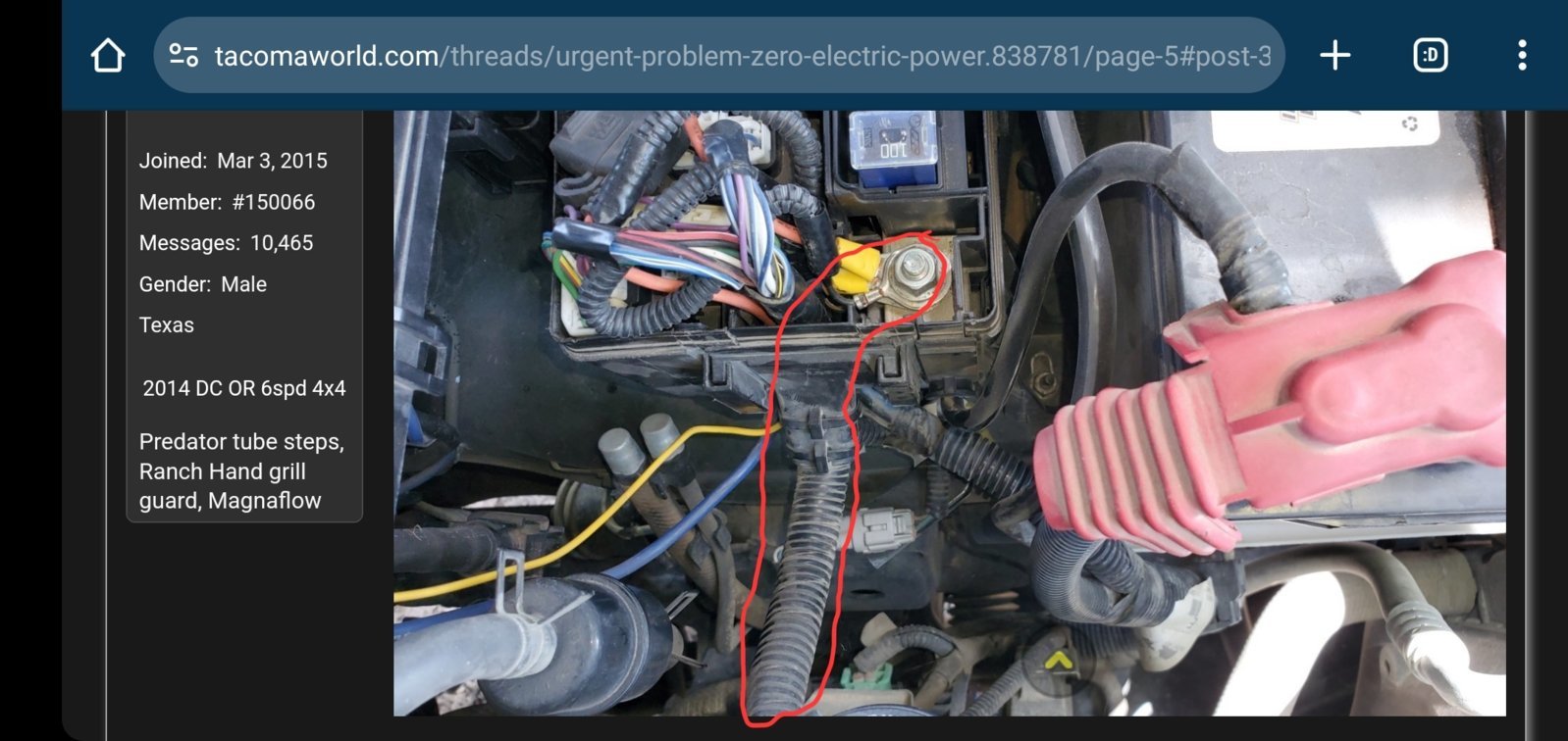

    The wire from the stud should route to the engine harness that goes down to the alternator.

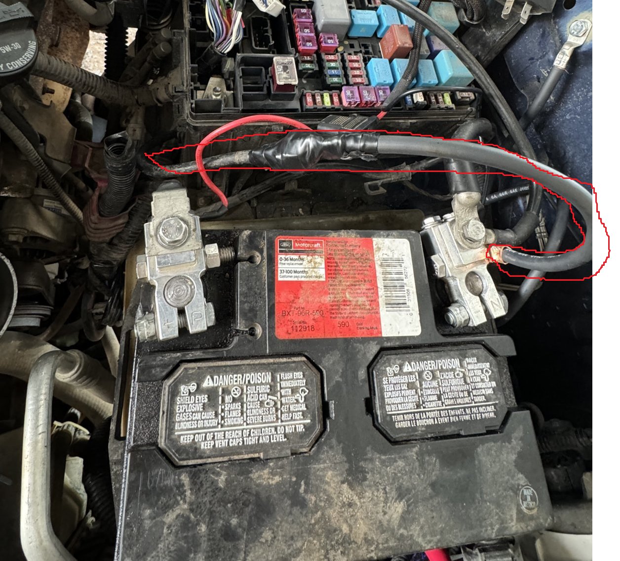

    And here is where we need to know how he's setup the DC-DC charger.
    We've completely isolated the fuse box of any + connections.
    And somehow we've managed to make the fuse box a "ground".
    I wish I was there with the truck. This is interesting.

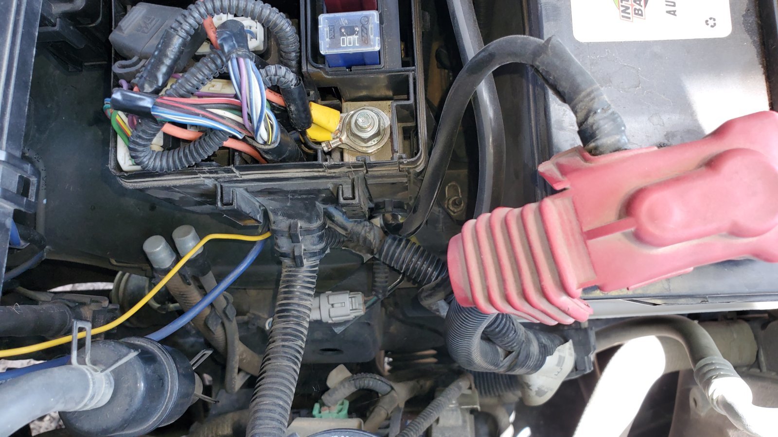

    Ok. Are you SURE the wire that comes in from the bottom, doesn't go to the top?
    You have "other stuff" blocking the view.

    Yea I traced them, the engine harness with the alternator wire goes to the stud on top and the wire from the battery goes into the bottom of the box.
    If you unlatch the little slide with the engine harness you can slide it up and see.

    If the battery had been going directly to ground, something would've melted or the battery would've exploded. The fuse box is not connected. I agree that the one wire going to the negative terminal may likely be the culprit. I also agree that it should be marked with red electrical tape to make things more clear in the future if this is the case.
