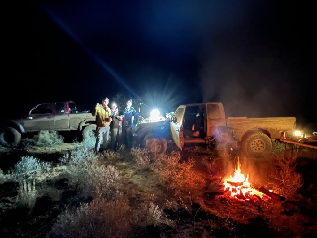

    Thank you all for your input. Bought the AT radiator and drove 3 hours out to my buddy's truck. Swapped out the radiator and made it back bright and early at 5am. Successful but long rescue mission.
    Never cease to be amazed with how awesome these 1st gen Tacomas are.
