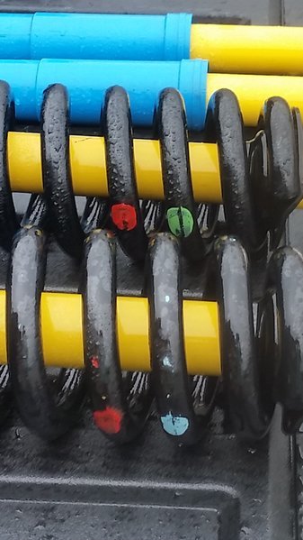

Urgent!!! What is the spring colour code for trd off-road front springs ??? Red green and red blue ?

    So not the exact answer was hoping for red blue and red green differences I think red green is driver side

    Count the coils. The one with more is drivers side

    Look the exact same

    Anyone with a trd off-road able to see the paint marks on their coils??

    To OP: I just went down and looked at my coils and did not see any specific olor markings. They both have a brown plastic sleeve on the top coil, and the passenger side had a gold marking on it. Otherwise they looked identical.

    Thanks for all the help guys but I have it confirmed I think, red green is driver and red blue is passenger

    My response to Moe2o4's post was about his answer, he was giving colors for the shocks, drivel...the OP was asking about the springs, then it deteriorated even further with the 'count the coils' posting. My gawd, the coils are the same, the spring rate is just slightly higher on the drivers side to take care of the 'taco lean'.

    Spring rate is the same. The OAL is the difference.

    If they haven't been disassembled, you should be able to tell which is which by the way the bottom of the coil is timed.
    It should face the rear.
    ETA; if the front is 12 o'clock they sit at 7 o'clock

    Then why the different color coding for each side. Good grief, it ain't rocket science, drivers side has a slightly higher spring rate to compensate for the overloaded gas tank/battery/driver on same side...
