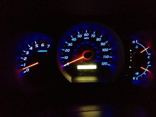

    LED gauge swap

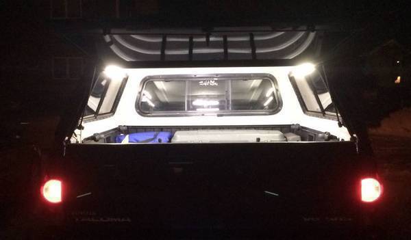

    LED lights in cap
    -2x 24" superbrightleds
    -1x 12" superbrightleds
    -1x waterproof switch

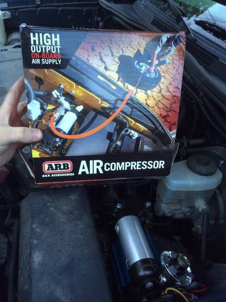

    -ARB compressor (CKMA12)
    -ARB inflator (ARB605)

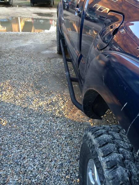

    BAMF 96" sliders @ 10*

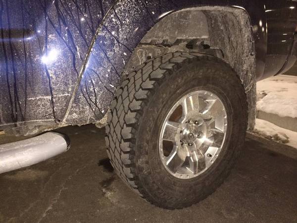

    (Cooper Discoverer ST MAXX 285/70/17 E-rated) replaced..
    BF Goodrich AT KO2 265/70/17 C-rated

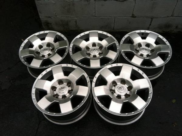

    Picked up the FJ Cruiser rims $300
    Installed the FJ's

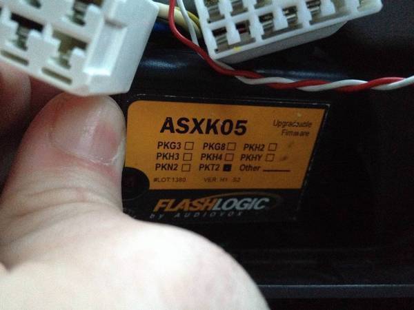

    Fiddling behind my radio, I found a remote started was installed in the truck from a previous owner. The hood switch was not tripped so it never worked before. 2 years after I purchased the truck it is now working.

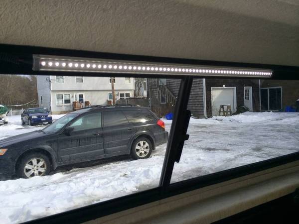

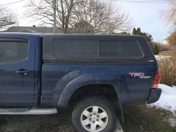

    Found an ARE cap on CL
    Added some superbrightleds lights to it with a waterproof switch. $100

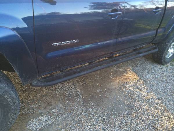

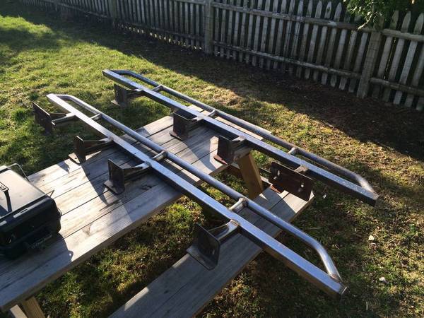

    Picked up some BAMF 96" rock sliders for $300

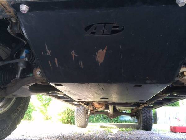

    Installed All Pro IFS skid (thanks Billy)

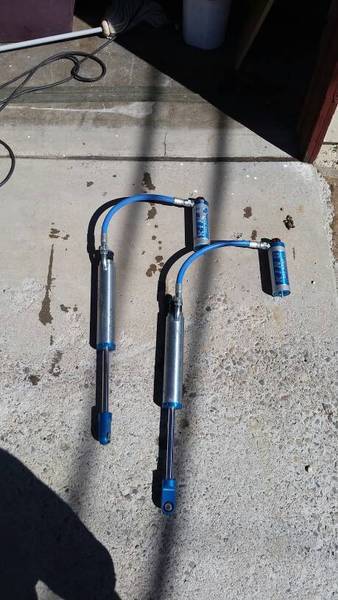

    Upgraded Rear to King 2.5" rear remote resi's with compression adjusters

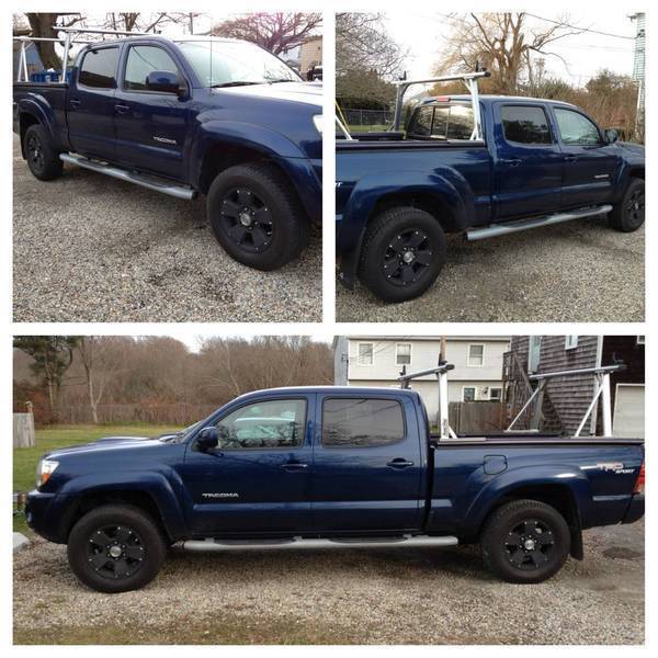

    3" lift
    Any rubbing with the 285 tires? how much lift did your aftermarket suspension give you. I have a 3.5" walker evans suspension and was thinking of adding 285-70-17 tires.
  8. May 1, 2014 at 7:08 PM
    UrPebkac
    UrPebkac [OP] Well-Known Member
    Jan 20, 2013
    #95649
    820
    David
    RI
    2016 GMC SIERRA
    I am settled in the front at 2.5" and they do rubber but only in reverse with medium flex. I trimmed slightly in the front of the tire and it mostly gone now. I don't notice it unless I am off road. I have not gone with new uca's yet.
    In the rear I am around 3.5". No rubbing at all.

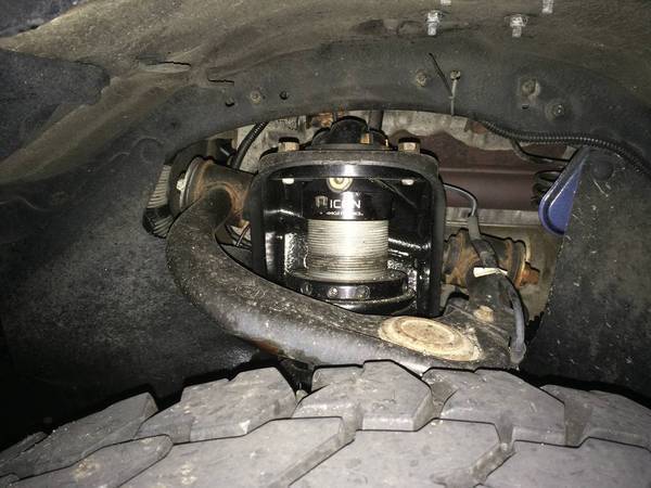

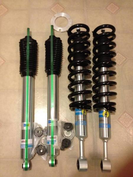

    Installed Icon 2.5 reg travel coilovers tonight to replace the bilstein 5100 with 885s. I was debating even installing the Icons because the bilsteins started to be so smooth with the added weight of my armor. But I am glad I did. Now these are AWESOME! Now to compliment them in the rear!

    Will do. So far they are a night and day difference. Mostly in the steering wheel is where I notice the dif. Doing 30+ down a washboard dirt road is like driving on glass now.

    Purchased King 2.5" Rear Remote Resi /w compression adjusters. Now waiting for them to ship. Thanks Jason! (Catattacksdog)
