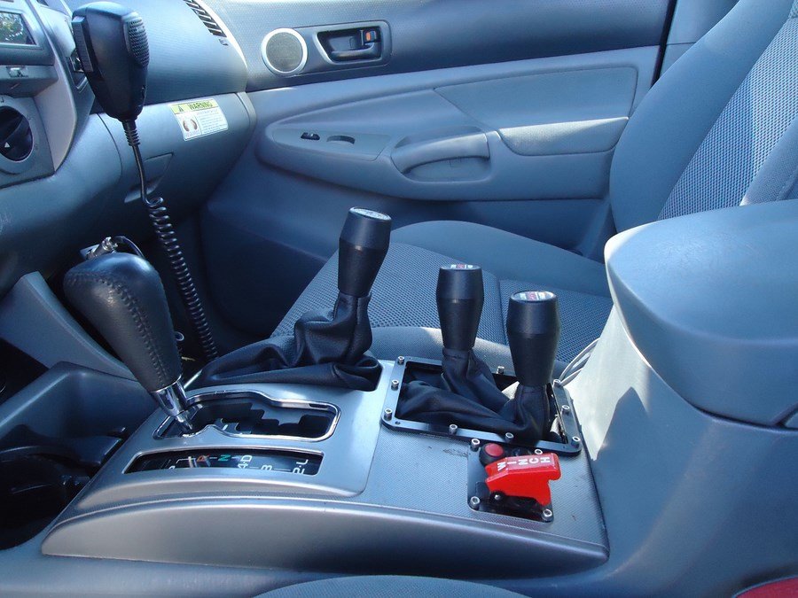

    The reason I did this swap on my truck was because I was at King of the hammers when my actuator failed. I had 4wd but no low in the T case. Fortunately I had a crawler box and had a 4.7:1 low so I was good for the day. Got the truck back to the shop and found the problem was a bit more than just the actuator. When the actuator goes, it can jam the shift rods. Once those are jammed your looking at a new case.
    After going to Australia with Marlin I realized that the FJ Cruiser case would bolt up to the transmission in my truck. We had one laying around and i bolted it in, put the shifter through the floor and haven't looked back since.
    Picture of first setup.
    Picture of current setup with the RST Twin Stick FJ Case.
    This is a far better setup and one that Toyota should have done in the first place. They have this in the new 4Runners, the Hilux overseas and the Fj Cruiser. Why not in the most popular truck they have ever sold in the US.
    To do this swap on an IFS truck, you'll need to put in a switch to activate your ADD and if you have a locker you'll need to do the locker mod.
    The reason I did this mod for the Military training vehicles is because for the most part they use the Toyota Hilux in theater and it has a Manual T case. We can't get theHilux here for them to train in so the next best thing is the Tacoma. I put the FJ Case in the Tacoma's they train with and bring the J shift pattern shifter up where it would be in the Hilux they would use and it becomes a seamless transition from training here in the states and driving in combat with bullets flying all around.
