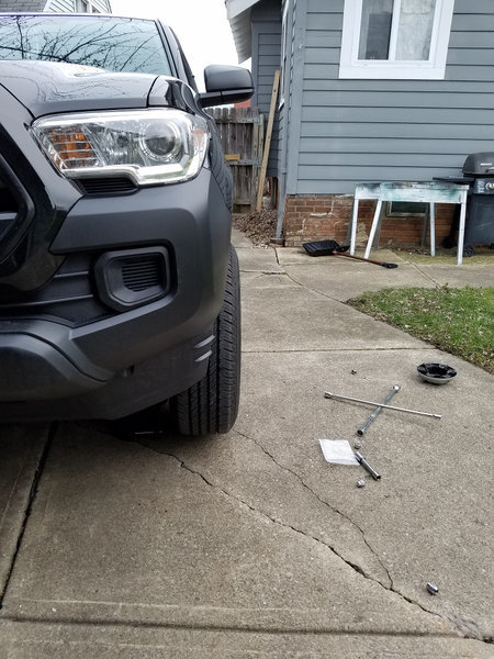

    I can find no information anywhere on the Internet about people using the same rim as the Back to the Future Toyota on a 3rd Gen. US Wheel Series 94. So I'm making this post for anyone else thinking the same as me and to also get any input. So, I jumped into some rims, 7" to match the factory wheel. 4" BS, no offset. When I mounted one it hit the brake caliper. Not surprised so I checked into spacer options. A 1/4" probably would have worked, but I also didn't want to lose that much thread engagement. So I ordered up some 1 1/4" spacers. Test fit that and it looks a bit ridiculous. The Series 94 rim sticks out 1" more than the factory steelie and with the spacer I'm sticking out 2 1/4" more.
    First picture is factory rim with spacer (doesn't look too bad)
    Second picture is Series 94 on the spacer (looks like it would be terrible with a tire)
    Thoughts or opinions?
    I'm thinking I need to send everything back and get something else. I like the TRD rims that look similar, but don't want to be a poser.

    Bump. Anyone have pictures or opinions of 245 mounted wheels sticking out so far? I'm pretty sure it'll look silly but if there's any chance of this setup working I'd be a happy feller.
